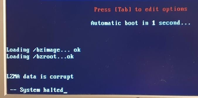

I trying to start my unRaid server again after long off-time (close to a year... 😕).
But it will not start.
I get:
Loading /bzimage... ok
Loading /bsroot...ok
LZMA data is corrupt
-- System halted_
What is the best (simplest) way to get the server up & running again?
I tried to backup the files on the USB stick but can't copy the file "bzroot-gui". That might be the problem? (I get "Error 0x8007045D: I/O device error")
Most likely, try backing up the config folder and then re-create the flash, if it fails transfer the key.
Thanks!
1. Tried to just replace the "bzroot-gui" but that didn't help. Same error.
2. Formatted the USB stick,
3. Downloaded the latest version on unraid
4. Copied to the USB stick
5. Replaced the config folder,
6. Run file "make_bootable.bat"
7. Server up and running again! 😃
Didn't need to do anything with the key(?)
Edited by TomH
Key in the config folder is linked to the flash ID embedded in hardware, so as long as you use the same physical USB stick, the license key will work. Doesn't matter if you reformat.
