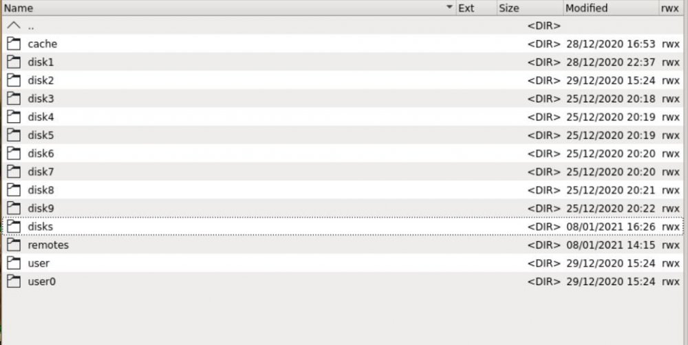

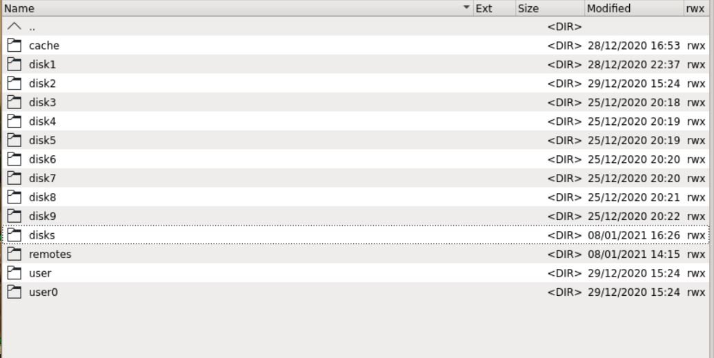

either: they've changed the krusader docker, or I changed mine. :D
regardless, stop the conainer, edit 'Host Path 2" to say '/mnt' only.
then start the container, and hit the webGUI.  you'll find the 'media' folder to have everything in it.

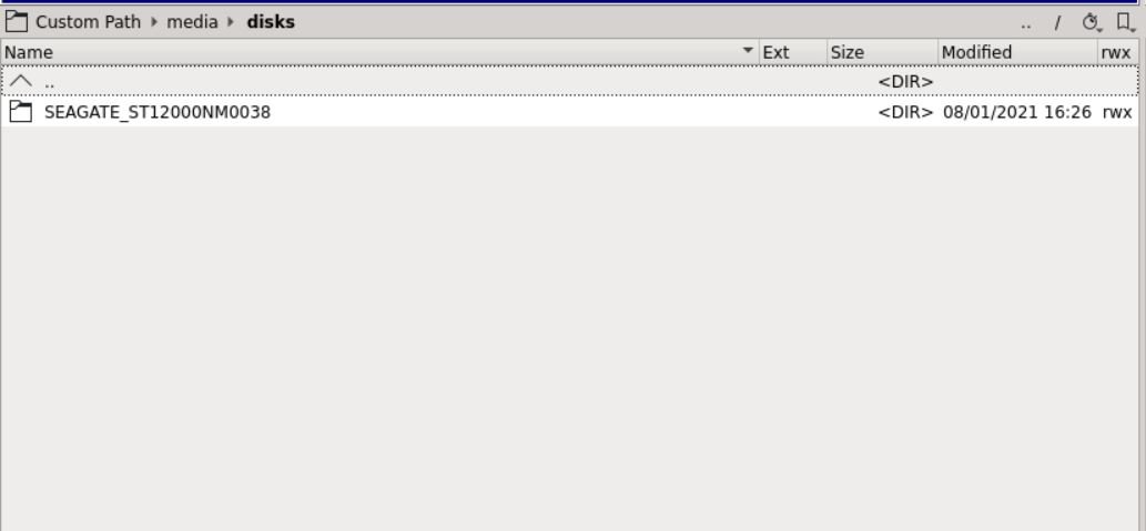

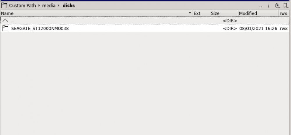

Great, I can see 'disk#'  !   However when I go into 'disks' it only has one drive and not the 11 that i have "unassigned". Thank you again for helping with this. I seem to always have the weirdest issues when I try to do thing.Capture6.thumb.JPG.51a2c356721e37de349ffa619638c9cd.JPG

7 hours ago, Waffle said:
Here is the information you requested. I looked in the '/media' folder and did not see the drives in their as well. Included is a picture of that folder.
Capture4.thumb.JPG.abc6f9d2d596ae14d95bb96cbf7f4de7.JPGCapture5.thumb.JPG.771a9fe99a2322a13ba16f93f2c7c155.JPG
With that mapping for /media you will only see the User Share level view of your files - not the physical drives view.
tangential, but i wonder why mine is listed as 'HostMedia' and his as 'Media', and was that mapping once '/mnt' versus his '/mnt/user' at initial install, or did I change mine at some point and note it or remember doing it?
