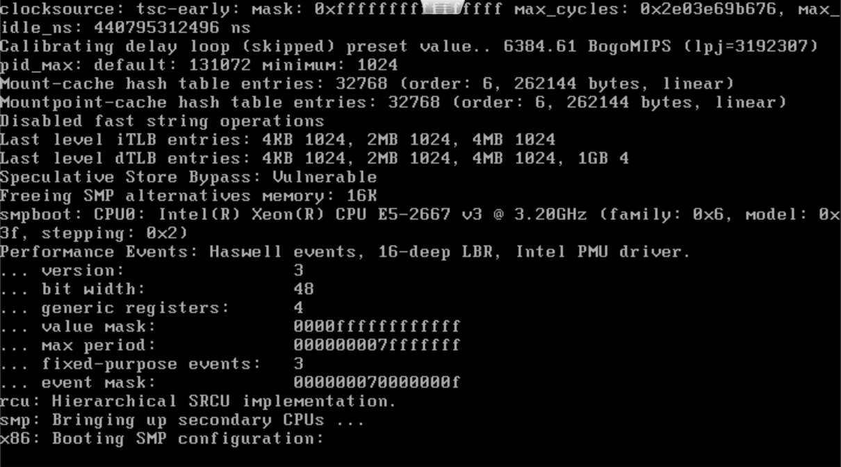

I am trying to get unraid (6.9 rc2) running as a vm on 6.7 U3 with a P400 GPU passthrough. When I add "hypervisor.cpuid.v0=FALSE" to the config file it will not boot with more than 1 cpu assigned. It appears like it is tries to load the Intel Micro Code and halts. I have tried disabling the microcode with the disable security mitigations plugin, but I still seeing in the hypervisor logs that it tries to load them. With 1 CPU it tries to as well, but doesn't seem to issue the CPU reset as listed in the logs.
Below is the log from the vm with 2 or more CPUs

Below is a screen shot from unraid where it halts.2021-01-10_20-52-14.thumb.png.b5e0d5c5a9a7fa1471f4b54f07c6f96e.png

I have pretty much the exact same issue!
If I add hypervisor.cpuid.v0 = FALSE, booting freezes right after loading bzroot.
If I set just one cpu I can boot just fine
I'm not sure it's Nvidia specific as I still get the error even without my Nvidia card passed through to the virtual machine.
And it won't boot even without any hardware at all passed through :(

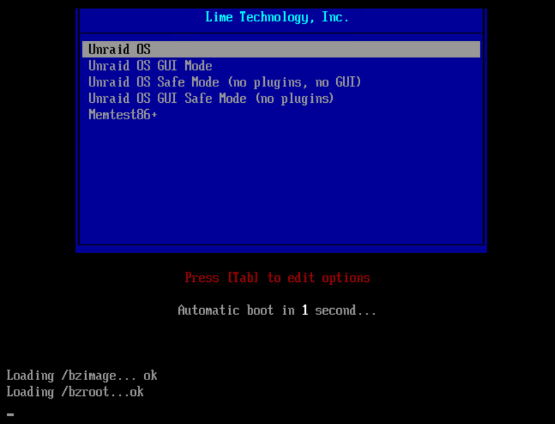

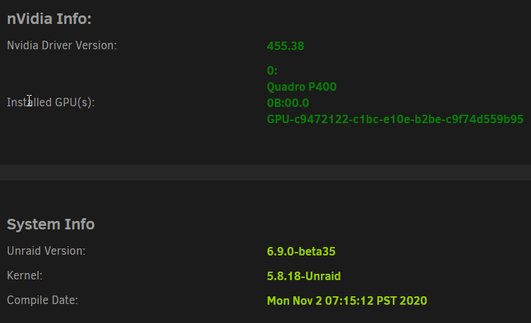

@jwiener3 - This issue is resolved if you drop back to UnRAID version 6.9.0-beta35 :)
Good info, how did you load that version?
It is likely the intel microcode include in version RC1 "intel-microcode: version 20201118"

@StevenD can run 6.9rc2 with hypervisor.cpuid.v0 = FALSE on his setup with ESXi 7, SuperMicro X9, and E5-2680v2 cpu's
Thanks to @ich777, I can confirm that you can run the latest 6.9rc2 with a modified bzroot that has the 6.9.0-beta35 microcode :)

@jwiener3, @zer0zer0 & @StevenD
If you need it here is the custom version of Unraid v6.9.0rc2 with the microcode from beta35.
Just be sure to first upgrade to RC2 (or at least put the files for RC2 on your USB boot device) and then replace the bzroot on USB boot device with the one from my archive.
Click
