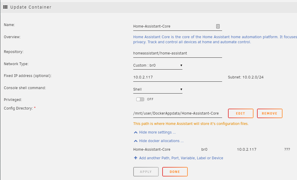

Where can DNS be configured in a docker container on a bridge network with static IP?
I see where the IP address is configured, but not DNS. I don't have a DHCP server on this subnet, and it is not using the Unraid host network, so it can't use the DNS of the Unraid box. I need to assign DNS servers to my containers or some of them will not function.
(Issue is not in regards to this specific container, I need to know how to do it for any that may require it)

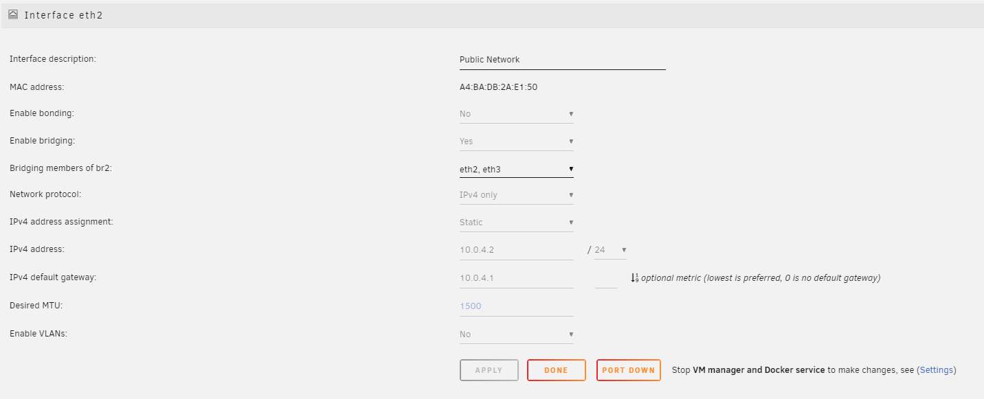

If it pulled the DNS settings for the bridge interface it is on, that would make sense. So I looked there... and I didn't see any place to put DNS options there either. Am I missing something?

You add it to extra parameters on each individual container (advanced view)  (If it differs from the HOSTS dns settings (settings - network)
--dns 208.67.222.222 --dns 208.67.220.220
Ah, thank you! That solved it. I saw 'more settings' and didn't realize there was also an 'advanced' view that had even more hidden stuff.
