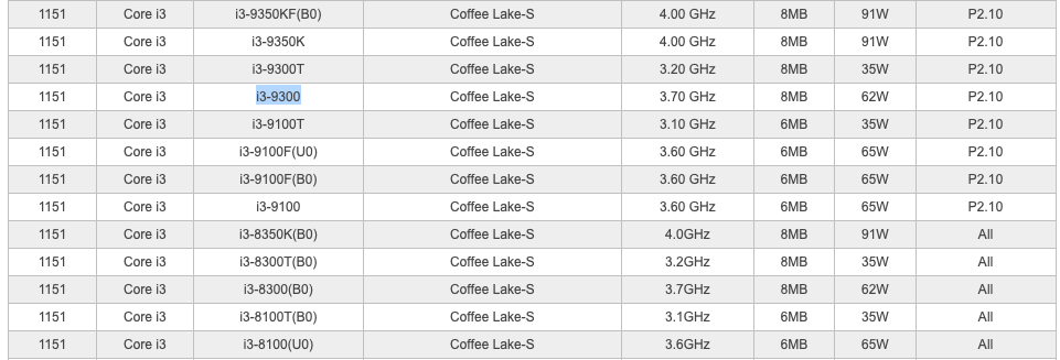

I think I will buy the newer i3-9100 or i3-9300 (over the older i3-8xxx?) with around 65 watt usage. The K version is 91 watt. On ASRack website, it indicates the i3-9xxx needs BIOS P2.10. After I installed the CPU and boot, I can flash the board to P2.10, correct?

That chart means the board must have at least the P2.10 BIOS installed or it will not even boot with a 9th generation processor.  Fortunately, I think all the boards available now have either been updated to at least P2.10 or ship with it.  My C246 ASRock board has the P2.30 BIOS.
If, for some reason, you get a board with a BIOS older than P2.10, ASRock will ship you (free) a new BIOS chip to install on the board.  It is socketed unless they have changed things.  I used to have a C236 WSI (prior generation) and it has a socketed BIOS chip that was easily removable.

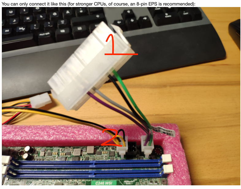

I will look into that Gigabyte board. Glad you mentioned about the ATX power connector. My 2015 Seasonic PSU is modular and has the 24 pin type. I noticed that ASRock has the newer type power connectors and I do not know if my PSU even has those. I guess not (sorry I wasn't able to open my case to check yet). You're right, I'd try to avoid using adapter.
No problem with that. The Asrock board contains the 24 to 4 Pin adapter.

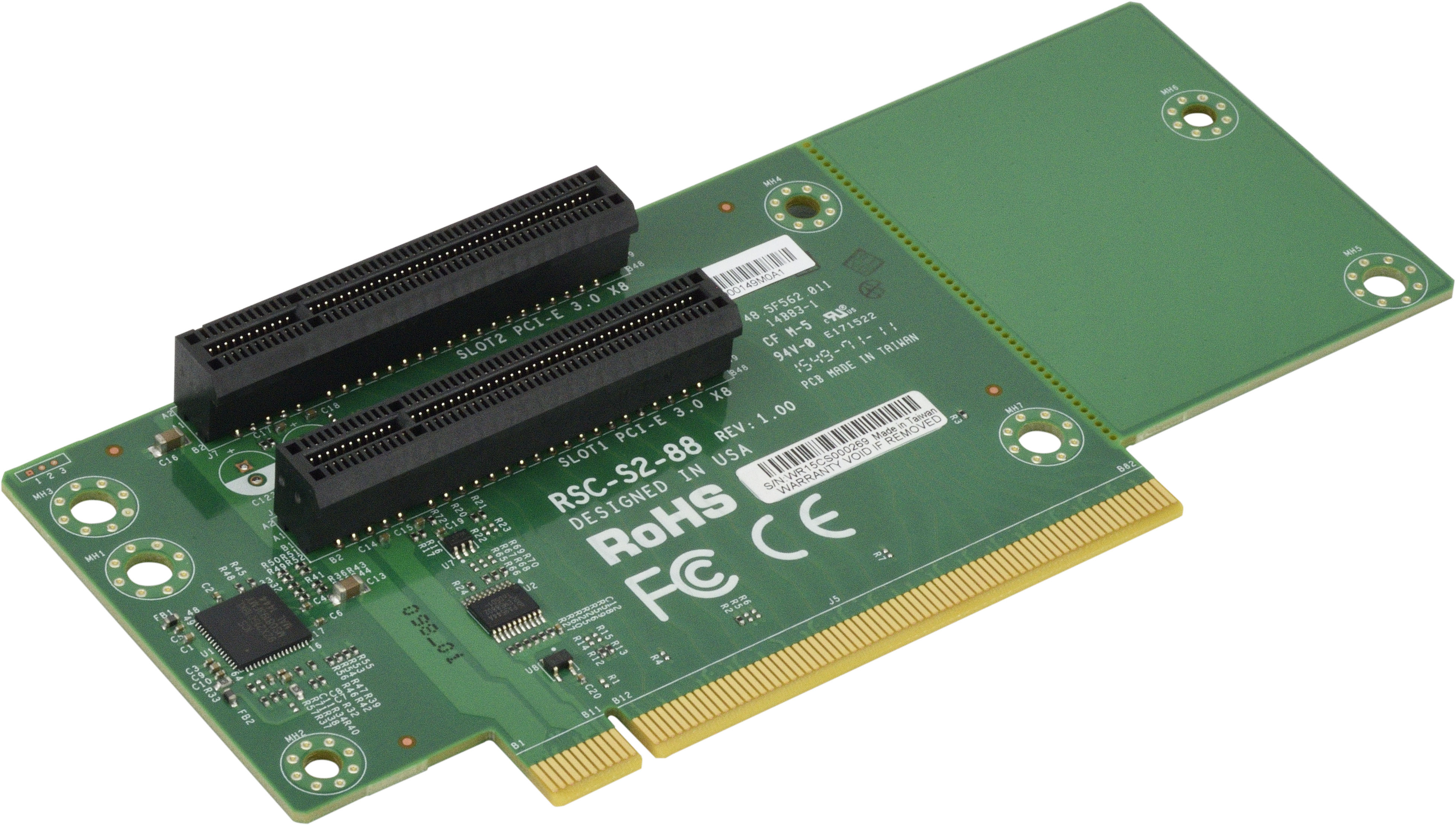

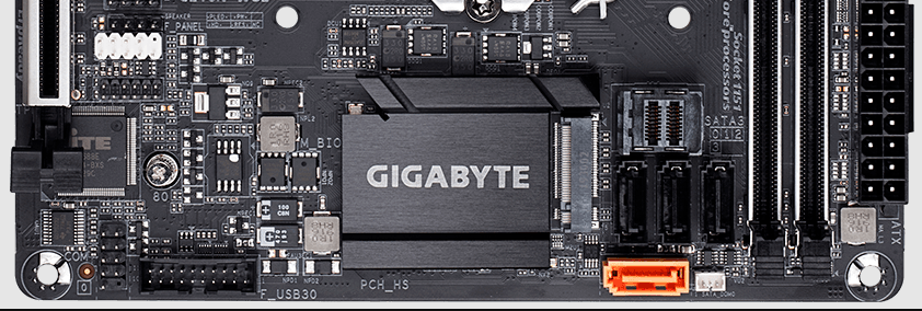

Gigabyte solved it very elegant by placing the full size M.2 on top of the chipset cooler:
I don't know if the Asrock supports that, but the Gigabyte does 2x x8 Bifurcation which allows splitting the PCIe slot with the Supermicro Riser Card RSC-S2-88:

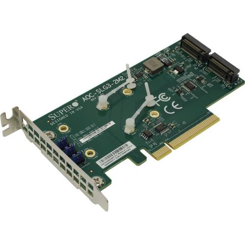

Or you could install the Supermicro AOC-SLG3-2M2 which allows installing two additional M.2 NVMe:

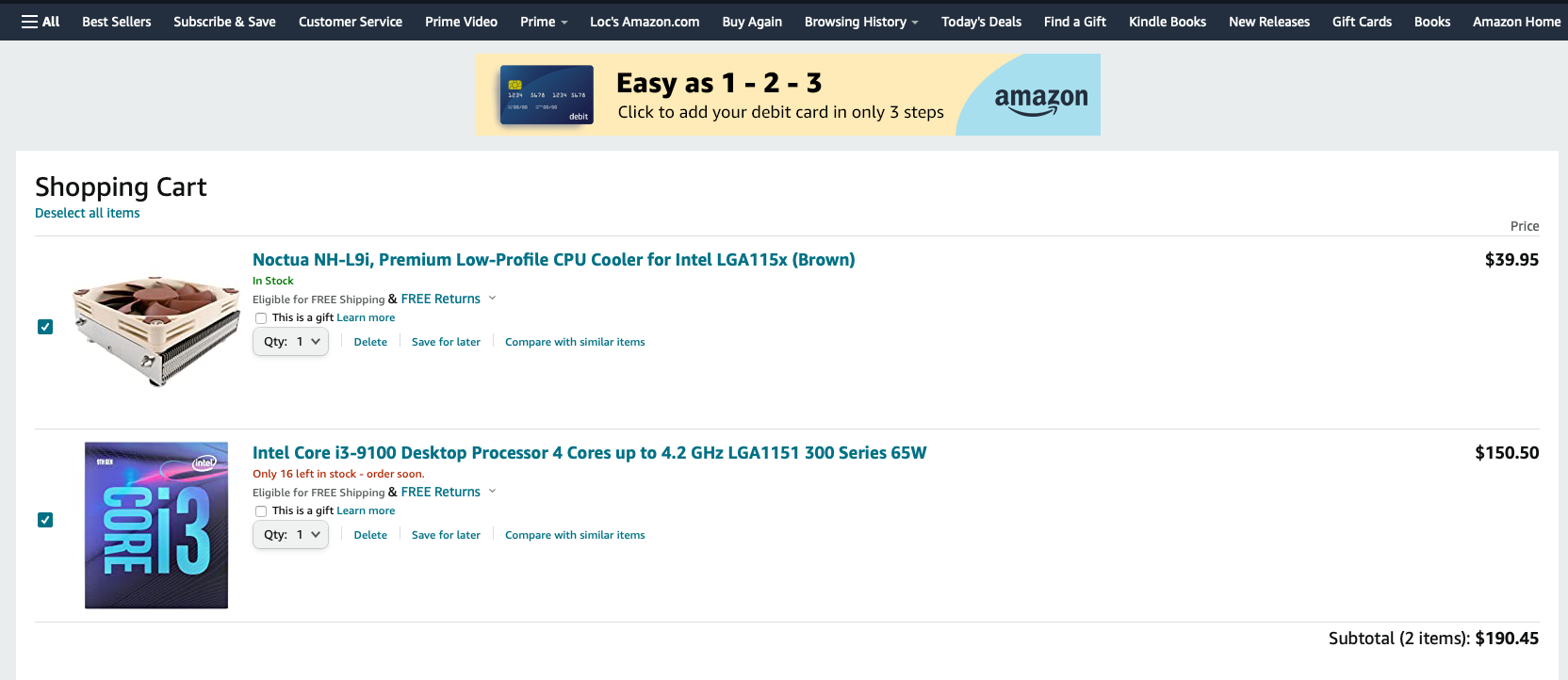

@mgutt I think I will go with the ASRock C246. The Gigabyte is no longer in stock every where in USA.
@Hoopster Thank you for the link. It's very useful as Trurl listed all the links to the component. The info and link in that you posted regarding Crucial no longer sell ECC ram. That's very sad to hear because all my computer devices I use Crucial as memory. I will try to stick with their brand. You posted the link to Micron (which linked with Crucial) it's not in the ASRock memory QVL, but it will work fine, correct? I have the below with NewEgg.
https://www.newegg.com/p/1B4-00SK-002F1
I will buy the Intel Core i3-9100 from Amazon. I wanted the i3-9300 but it's not available any where. It has 8MB cache vs the 6MB from 9100. Not sure if that matters.
I will also get the OCuLINK from trurl's link.

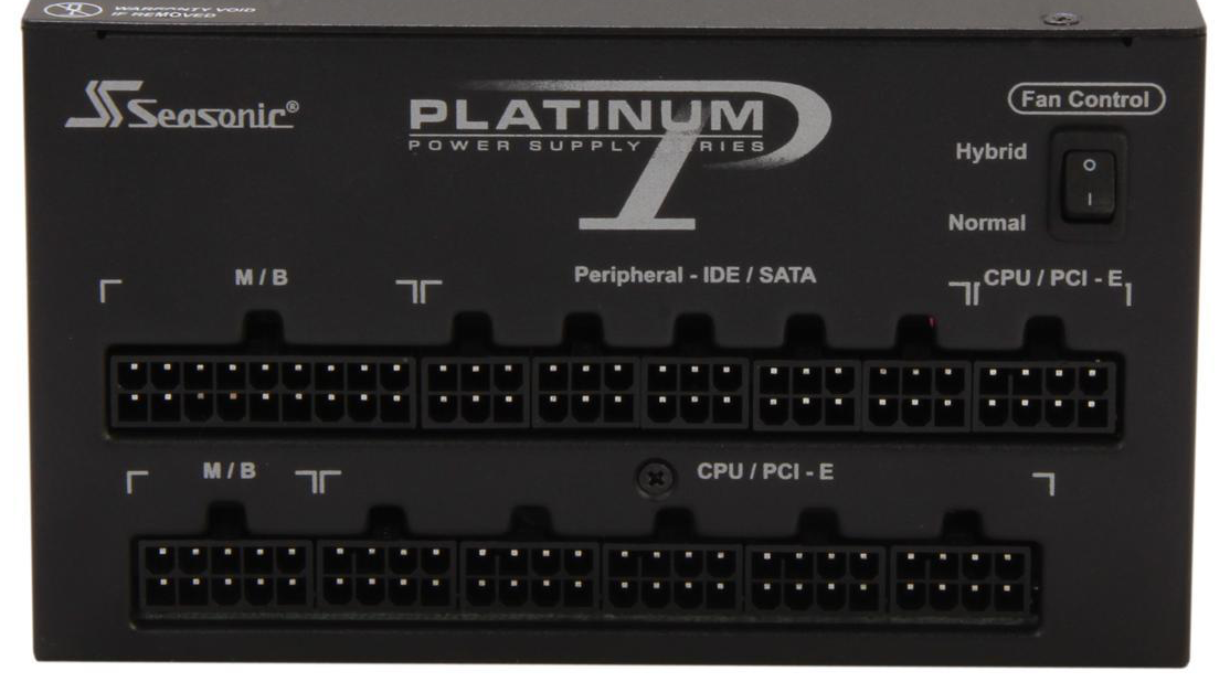

Hi @mgutt, so I read your topic. On the #1, that's for the 24 Pin to 4 Pin power adapter for the whole motherboard you talked about earlier.
As for the #2 8 Pin for the CPU. I look back on my PSU, I think it does support 8 PIN.
1736846743_ScreenShot2021-02-10at2_51_04PM.thumb.png.d549abee442f83f16976b88b5a4f3eba.png
It works with 4 pin CPU as well. 8 pin is for high power Xeons

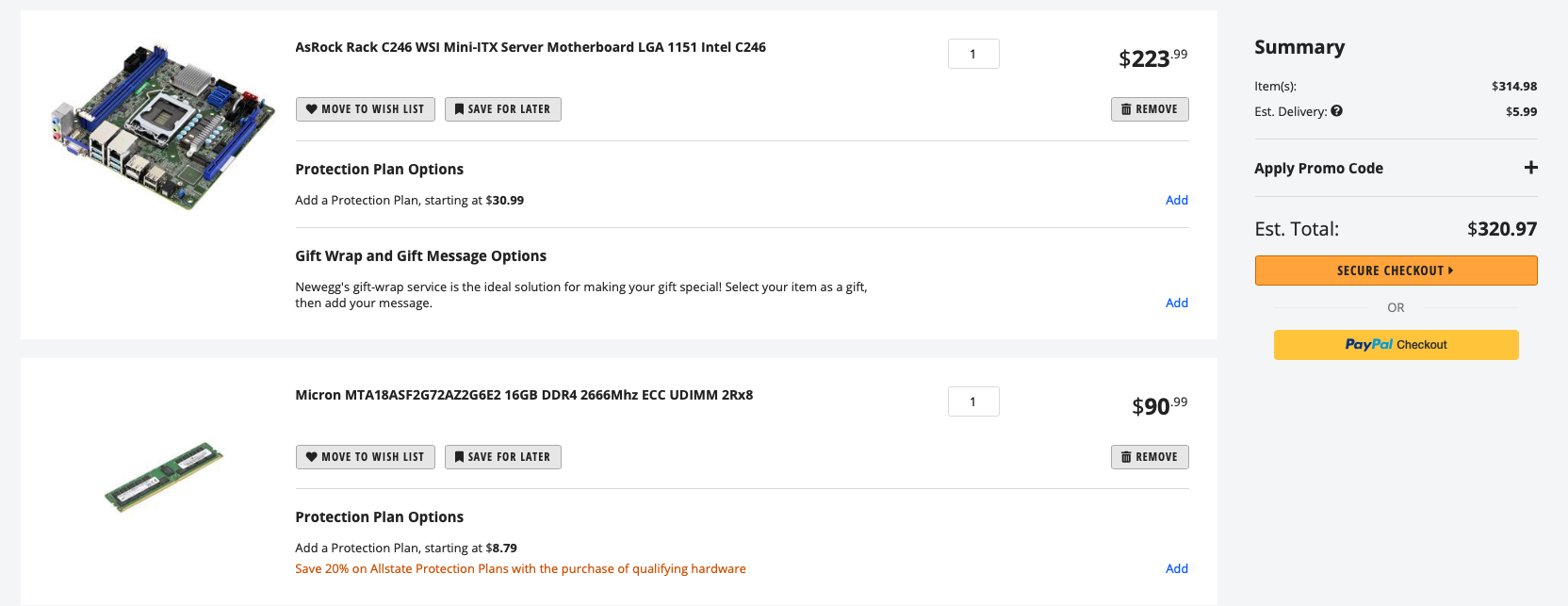

ASRock C246 WSI
Intel Core i3-9100
Micron MTA18ASF2G72AZ2G6E2 16GB DDR4 2666Mhz ECC UDIMM 2Rx8
Noctua NA-SYC1 chromax.red, 4-Pin Y-Cables
I will just buy one stick of Micron 16GB Ram for now since I do not have the budget. I still need to source for the OCuLINK cable (trurl's link from another post), that one is a pain. I also send ASRack an email to see if they have any recommendation for the OCuLINK.
