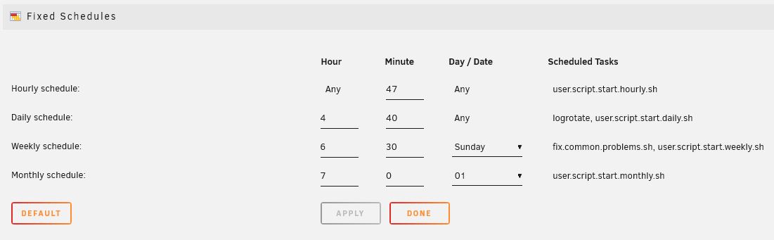

I JUST noticed that this was logged at the same time mine was !
I'm going to bump this thread, as I'm seeing this in my logs (and at the same time) as well.  Seems aligned with user.script.start.daily.sh
It doesn't seem to cause any issue with apcupsd but just would be nice to confirm this from a routine task, and not indicative of any issue.

Hi guys.  I was curious about this myself and here are some things that I found.
As you can guess the apcupsd daemon controls the UPS communication.  The number in brackets is the process ID of that daemon process.  It seems that, on a weekly basis, the old process [524] is destroyed (exited) and a new process [13221] is created.  Obviously your process numbers would be different from mine.
This weekly restart process is controlled by "logrotate".  You can find logrotate.conf in the "/etc" folder.  Basically the logrotate config file is run and then all scripts within the logrotate.d folder are run.
In the /etc/logrotate.d folder you'll see apcupsd which contains the following commands.  The rc.d is a folder that contains "run commands" for daemons.
More info here --> https://linux.die.net/man/8/logrotate and https://forums.unraid.net/topic/119894-resolved-problems-with-apcupsd-starting-at-regular-times-when-disabled/
The UPS Self Test is a test that the UPS performs on a regular basis and the apcupsd daemon simply posts the results to the log.  It's interesting my settings show SELFTEST = NO and yet my UPS still does a regular Self Test.  Maybe just a bug with apcupsd.  See this for more info about the Self Test --> https://www.apc.com/ca/en/faqs/FA405317/
Note below in the screenshots that everything in my settings jives with the logs especially the power failure at 6:50:34 lasting for 2 seconds.
Edited by TimTheSettler
Thanks @TimTheSettler!
So it's basically a weekly restart of the apcupsd daemon and no cause for concern, right?
That's how I understand it.  The daemon is restarted so that a new log can be started.
