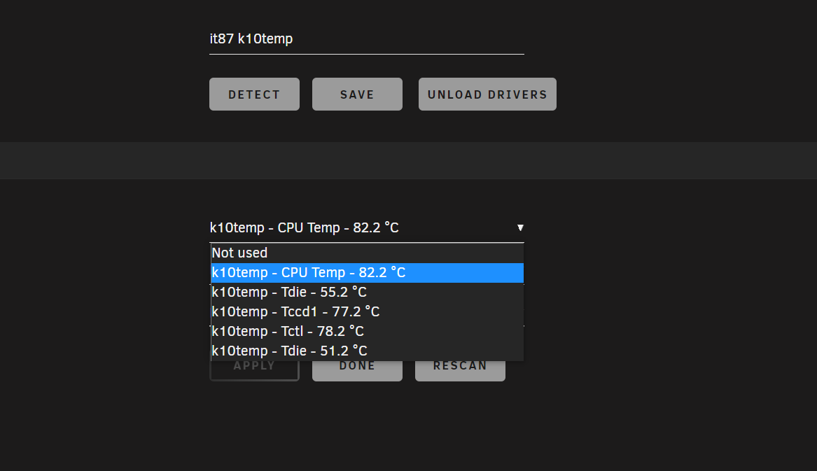

Hi guys , i made the upgrade to the RC2 , due to my nvidia not working ,  its fine now , all good , but now i have another issue that i didnt had with 6.8.5 , my cpu temp is wrong says its on 96º and already saw a 110º , checked bios temp , and its fine on the 40 ish º ,  i have a threadripper , with and aorus board ,  and it shows the driver as  :  it87 k10temp , have unloaded it and rescan , and tried in ssh to check sensors , but cannot get the  temp  right , how can i fix this ??

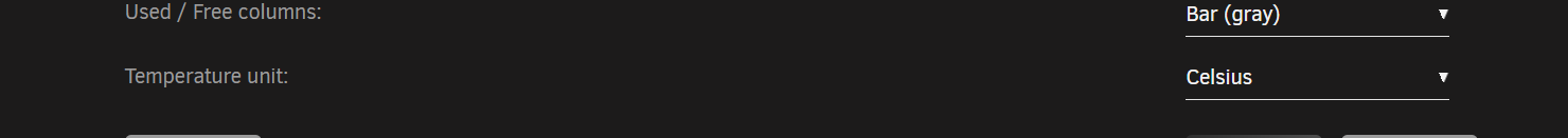

Sounds like in Settings -Display settings it's set to display Fahrenheit instead of Celcius
Sorry , but i checked that its celcius
Try cycling it and then applying.  While I'm not saying that it's impossible for the mis-reporting, it's curious that your 40C the BIOS reports is ~104F that Unraid says it is.
Its not F , its always Celsius , but its the wrong number , since its low on the bios , and was low before the update , after it its always 80 up for more , even if idling  , so the problem must be drivers or wrong sensor data ,  but i dont see F , only see celsius

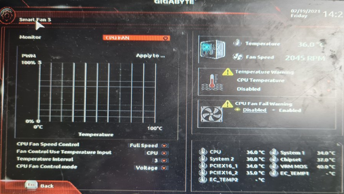

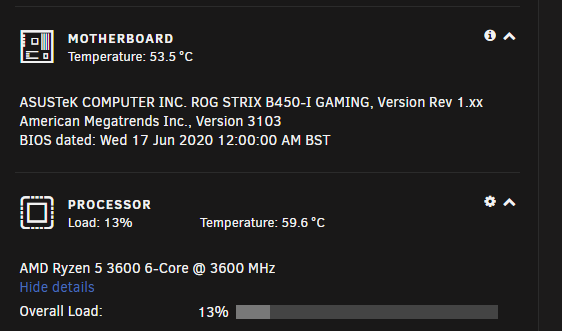

I'm hoping this is a tech issue as im having kittens with these readings on a Ryzen 3600 !
temps.thumb.png.216f01cb30e1643398a5a7316822e726.png1466013246_CPUTemps.png.f03b3e9bea711fe797e6a2a80bf94115.png

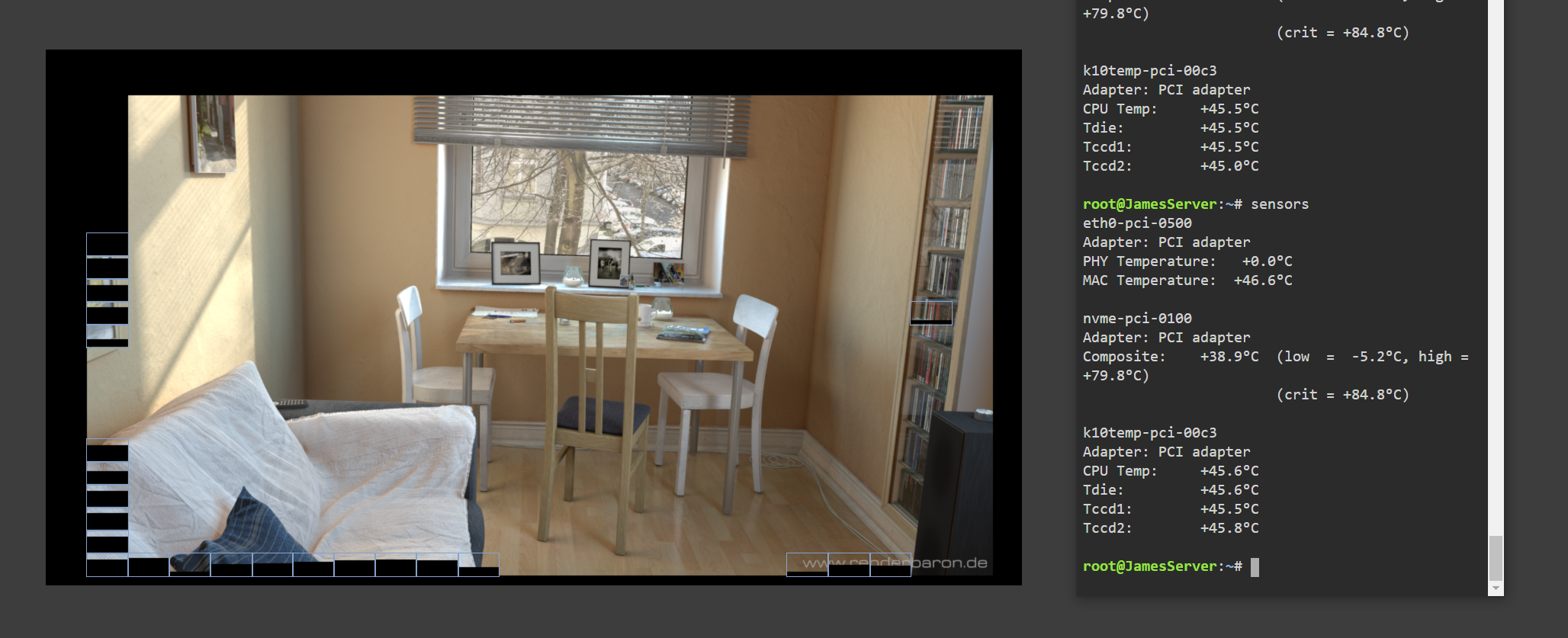

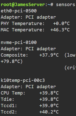

Same probleme here, with my Ryzen 9 3950X the temp in the bios is 50°C and unraid show me 40°C
In windows VM, with 12/24 core in Cinebench multi core unraid show my 45°C, that impossible.
Not going to disagree per se, but they are 2 different "environments" and can't be compared directly to each other
5 minutes ago, JamesAdams said:
that impossible.
Out of curiosity, why is it impossible?
Beaucause no cooler or watercooling is as efficient and in place I have a small cooler so the temperature is not the right one for sure
