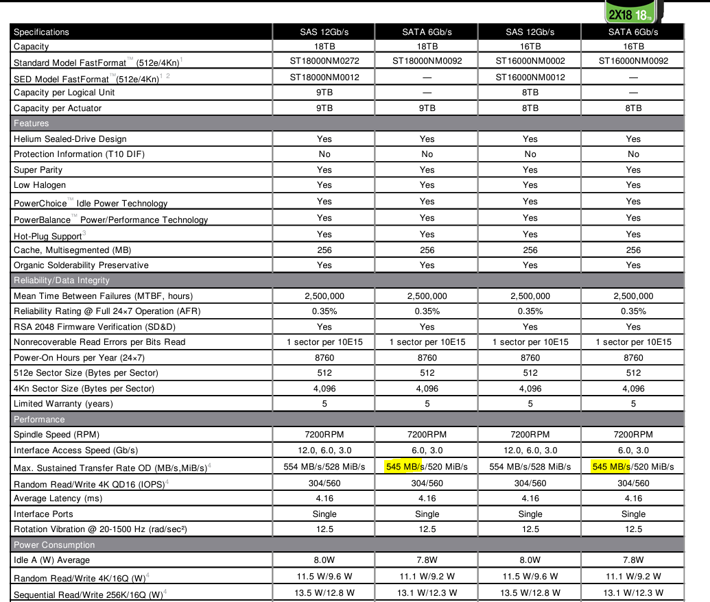

Now these could be interesting, they've recently announced Gen2 with 16 and 18TB models, and now there will be a SATA version, which unlike the SAS models will present a single volume to the OS, problem will likely be the price:
If I understand this post correctly the first half of the disk is actuator 1 and the second half of the disk is actuator 2:
https://forum.level1techs.com/t/how-to-zfs-on-dual-actuator-mach2-drives-from-seagate-without-worry/197067/61
So even the SATA version is not compatible with Unraid (it works, but it won't enhance the performance). At first Limetech would need to create a complete different variant of the Parity creation / reading like "every second block is written/read to/from the second half of the disk".
And finally I don't think this is really worth the effort. A Samsung 8TB QVO is cheaper and combined with an 8TB NVMe as parity much faster in any aspect.
The speed came from the RAID, not the Dual Actuator.
