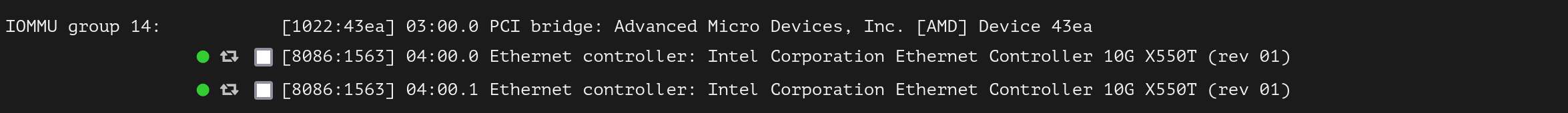

Hi, thank you for a fantastic guide. I have been playing with it for some time and can't get it to work. I believe I have similiar problems with some of the people in this post. now let me decribe my setup and helpfully someone can point a light.
-ASUS TUF GAMING B550M-PLUS bios Version 2604
-AMD Ryzen 7 5700G
-32 gb cosair ram (3600mhz)
-intel x550-t2

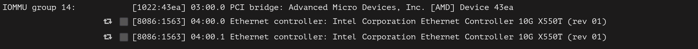

Before the nic shows up normally in system devices. both using the ixgbe driver
Creating the VF was rather easy. whether editing the go file in method 1 or the echo method in option 2, they both work and I went with option 2 as its easier.
sudo echo 4 > /sys/class/net/eth1/device/sriov_numvfs
eth1 correspons to the 4:00.1 controller for the intel x550. eth0 is used for unarid. eth2 is the onboard 2.5g nic.

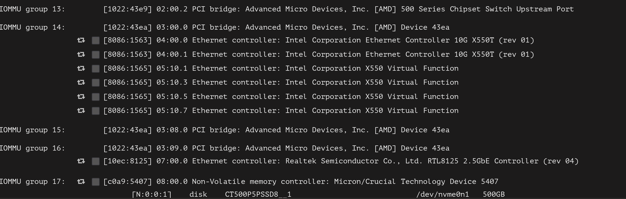

After creating the vf, system device shows that VFs are created.
run the bind scrip from the unraid command line. it shows that the scipt unbounds the physical device which should not happen.
root@Tower:~# sudo bash /boot/config/vfio-pci-bind.sh 8086:1565  0000:05:10.1
Vendor:Device 8086:1565 found at 0000:05:10.1
IOMMU group members (sans bridges):
/sys/bus/pci/devices/0000:05:10.1/iommu_group/devices/0000:04:00.0
/sys/bus/pci/devices/0000:05:10.1/iommu_group/devices/0000:04:00.1
/sys/bus/pci/devices/0000:05:10.1/iommu_group/devices/0000:05:10.1
/sys/bus/pci/devices/0000:05:10.1/iommu_group/devices/0000:05:10.3
/sys/bus/pci/devices/0000:05:10.1/iommu_group/devices/0000:05:10.5
/sys/bus/pci/devices/0000:05:10.1/iommu_group/devices/0000:05:10.7
Binding...
Unbound 0000:04:00.0 from ixgbe
Unbound 0000:04:00.1 from ixgbe
/boot/config/vfio-pci-bind.sh: line 157: /sys/bus/pci/devices/0000:05:10.1/iommu_group/devices/0000:05:10.1/driver_override: No such file or directory
/boot/config/vfio-pci-bind.sh: line 172: echo: write error: No such device
/boot/config/vfio-pci-bind.sh: line 157: /sys/bus/pci/devices/0000:05:10.1/iommu_group/devices/0000:05:10.3/driver_override: No such file or directory
/boot/config/vfio-pci-bind.sh: line 157: /sys/bus/pci/devices/0000:05:10.1/iommu_group/devices/0000:05:10.5/driver_override: No such file or directory
/boot/config/vfio-pci-bind.sh: line 157: /sys/bus/pci/devices/0000:05:10.1/iommu_group/devices/0000:05:10.7/driver_override: No such file or directory
success...
Device 8086:1565 at 0000:05:10.1 bound to vfio-pci

I think this is where the problem lies, when I run the bind script from andre-richter, it unbinds my phsical interface, then, as the phsical interface is being bound to vfio, the vf function I created just vanishes. after going into andre-richter' github, I found this line
# (2) Unbinds all devices that are in the same iommu group as the supplied
# device from their current driver (except PCIe bridges).
# (3) Binds to vfio-pci:
# (3.1) The supplied device.
# (3.2) All devices that are in the same iommu group.
Afterward, system device shows that both the nics are bound to vfio,  Which should not happen right?
I think what happened was that, after creating the vf, the physical function and the vf are in the same immmo group.
If my understanding is correct, the scipt shoudn't bind the phscial function to vfio since the ixgbe driver needs to be active in order to provide the vfs. And because the scipt binds all device in the same iommu group, in my case this will include the phsical function. In addition, from reading the guide, devices that uses the ixgbe driver does not have a abstrication layer. thus why am i getting 5 nics in total (including the phsical).
I got it. if i set to mutifunction+downstream. the vfs will be in their own group just as how you showed in your tutrioal. then it doesn't confict with the scipt. for anyone with the same problem. go to vm settings and set it to PCIe ACS override to both.  this allows all the vfs to be in their own iommu group. don;t konw if this is needed or if someone can modifiy the scipt. but for now this works.
Whether or not PCIe ACS override is needed is widely system dependent - any time you hit an issue with IOMMU grouping, it's one of the options that are available, but unfortunately not a one size fits all.

I think the script work only if you vf and phsical function are not in the same iommu group. my asus motherborad puts the vfs and pfs in the same group which was the problem. I'm not sure if this is the limation of the bind script but, looking at the author code descriton, it looks to me if all the vfs are in the same iommu group, by just supplying one of the vfs to the scipt, then scipt can just bind all(not sure). It seems to me that's what the author is excepting(maybe the default norm is pf in one group and vfs in another group). I wanted to modify the scipt to bind just the one specified and not include the devices in their iommu group, but my limited bash skill is just not letting me do that.
I think, this might be a point to be added to your tutrial. looking at the iommu group of the machine and how it interacts with the pci-bind script.
The limitation of IOMMU grouping is always on the side of the motherboard (I usually hesitate to make statements like this as fact, but I think it's pretty close here). The ability to segment to individual traces down is completely dependent upon the PCB design and BIOS implementation, which is on the MB side.
The 'downside' to enabling the override is, at least in theory, stability - what we're doing is 'ignoring' what the motherboard says it should support. In reality, if you enable it and everything 'just works', it'll more than like continue to 'just work' indefinitely (barring any changes to the MB BIOS).
Unfortunately IOMMU grouping and how it all actually works is beyond the scope of this tutorial, but I agree it's a subject that could use clarification. A lot of it boils down to hardware implementation and optionROM size the MB vendor implements into its design - most consumer boards, they only have enough space to load the fancy graphical BIOS they come with, where workstation/server boards still tend towards keyboard driven UI's (leaving more space for other operations).
