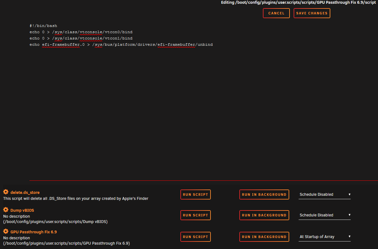

Upgraded back to 6.9 and tried it out but unfortunately, it doesn't work for me and im not sure if i did something wrong. As suggested, i created the User Script and set it to start before the Array does. Im getting this Output:
Script location: /tmp/user.scripts/tmpScripts/GPU Passthrough Fix 6.9/script
Note that closing this window will abort the execution of this script
/tmp/user.scripts/tmpScripts/GPU Passthrough Fix 6.9/script: line 3: /sys/class/vtconsole/vtcon1/bind: No such file or directory
/tmp/user.scripts/tmpScripts/GPU Passthrough Fix 6.9/script: line 4: echo: write error: No such device
Starting the VM, has the same effects as before (Blackscreen and Bootloop).
Edited by giafidis

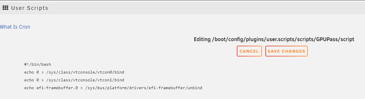

I set it up exactly like yours (s. Attachment). Can you post the Script log?

Same as yours. What do you normally use to remote into your VM? Maybe try a fresh VM install and run the script.

/tmp/user.scripts/tmpScripts/GPUPass/script: line 3: /sys/class/vtconsole/vtcon1/bind: No such file or directory
/tmp/user.scripts/tmpScripts/GPUPass/script: line 4: echo: write error: No such device

@giafidis & @DoeBoye If you aren't using the vBios from your GFX card I recommend using Space Invader Ones script to pull it. The script is here: https://github.com/SpaceinvaderOne/Dump_GPU_vBIOS
Use the User Scripts plugin, add the script and modify the first section, run it once and then assign the vBios in your VM.

Side note: The script doesn't work for me in 6.9. I get always an error message that i should bind the GPU with vfio-pci first and then try again. I tried that out, but no luck. In 6.8.3 however, the script works without any Binding at all...
