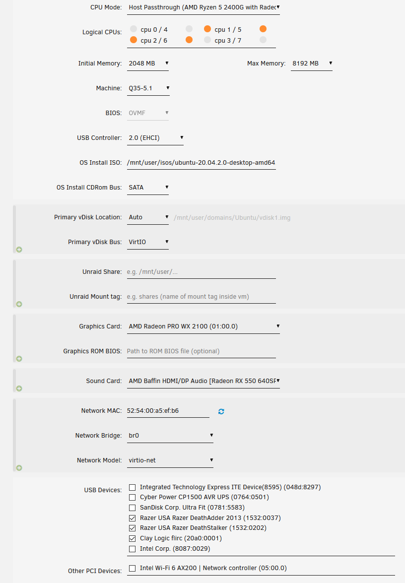

I had successful GPU passthrough (tested acceleration) on a Ubuntu host on 6.9.1 one time. It did not have the audio device configured correctly (strange UNRAID bug that's been lingering for years apparently) so I did a clean shutdown, tweaked it per the space invader advanced GPU tweaks video (added multifunction='on' and set correct values for audio device) and started it back up again. No output whatsoever - not even the bios. Even reverting back to the broken audio configuration (or removing audio altogether) still resulted in no output at all. Rebooted UNRAID and same thing again, no output. Been pulling my hair out over this maddening inconsistency. Why would it work once and then not again?
The configuration that did work once was with latest Q35 and OVMF bios, no attached vbios (AMD GPU).
I am not seeing any errors or even warnings anywhere in UNRAID log or VM log that would indicate an issue. It should work - but it doesn't. I've spent probably about 16 hours across 3 days hammering on various Windows 10 Pro configurations to get a GPU passed through and never had any success. I swear I must have tried every combination by now... Why would a core feature be broken in the latest stable release?
This is my first foray into UNRAID and I just started with the latest which happened to be 6.9.1 - so no previous success from which to compare to older versions. Having a miserable time so far 😆.
Econaut, are you able to remote into the station when it's giving you the black screen?
Not currently. I did install teamviewer with VNC when initially installing Ubuntu and while I can actually see the teamviewer ID populate in the systems list when I start it up in passthrough mode, I cannot actually connect to it. I would probably be able to SSH in if that is what you mean but I don't have that enabled currently.
Well, it's good that it's showing up. Can you post a screen shot of your VM settings?

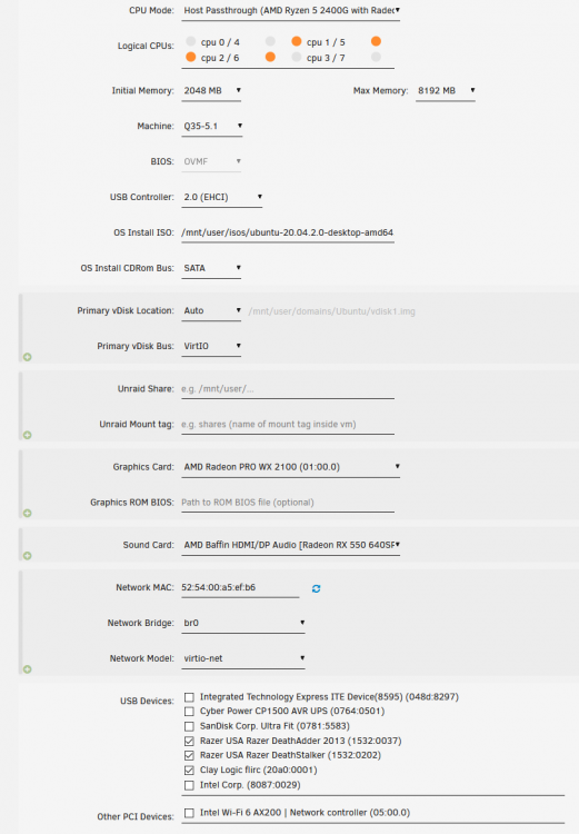

I may not be having the exact same issue, in fact I don't think anyone in the world is having my exact issue since my hardware configuration (and most folks) are rather unique, but I am on 6.9.1 and I cannot get GPU passthrough working for the life of me despite following every guide I could get my hands on.
Behold:
Edited by Econaut
15 hours ago, Econaut said:
Thanks for that guide - I actually found it referenced somewhere else and followed it pretty much to the letter with the most recent Win10 VM attempt (stopping short of the virt-manager section). After reading countless forum posts, articles, and watching videos I've seen everything all over the map recommended for any possible scenario (SeaBIOS vs OVMF, Q35 vs i440fx, use vbios or don't) - the community doesn't seem to have any reliable consensus aside from 'use whatever works' & 'try everything' which is infuriating haha.
Behold:
Sounds like you've tried it all, I don't see any glaringly obvious issues with the current setup you have. I never could get OVMF to work with Windows 10, I'm stuck on SeaBios. From what you said, you've already given that a try though, not sure what else to suggest.

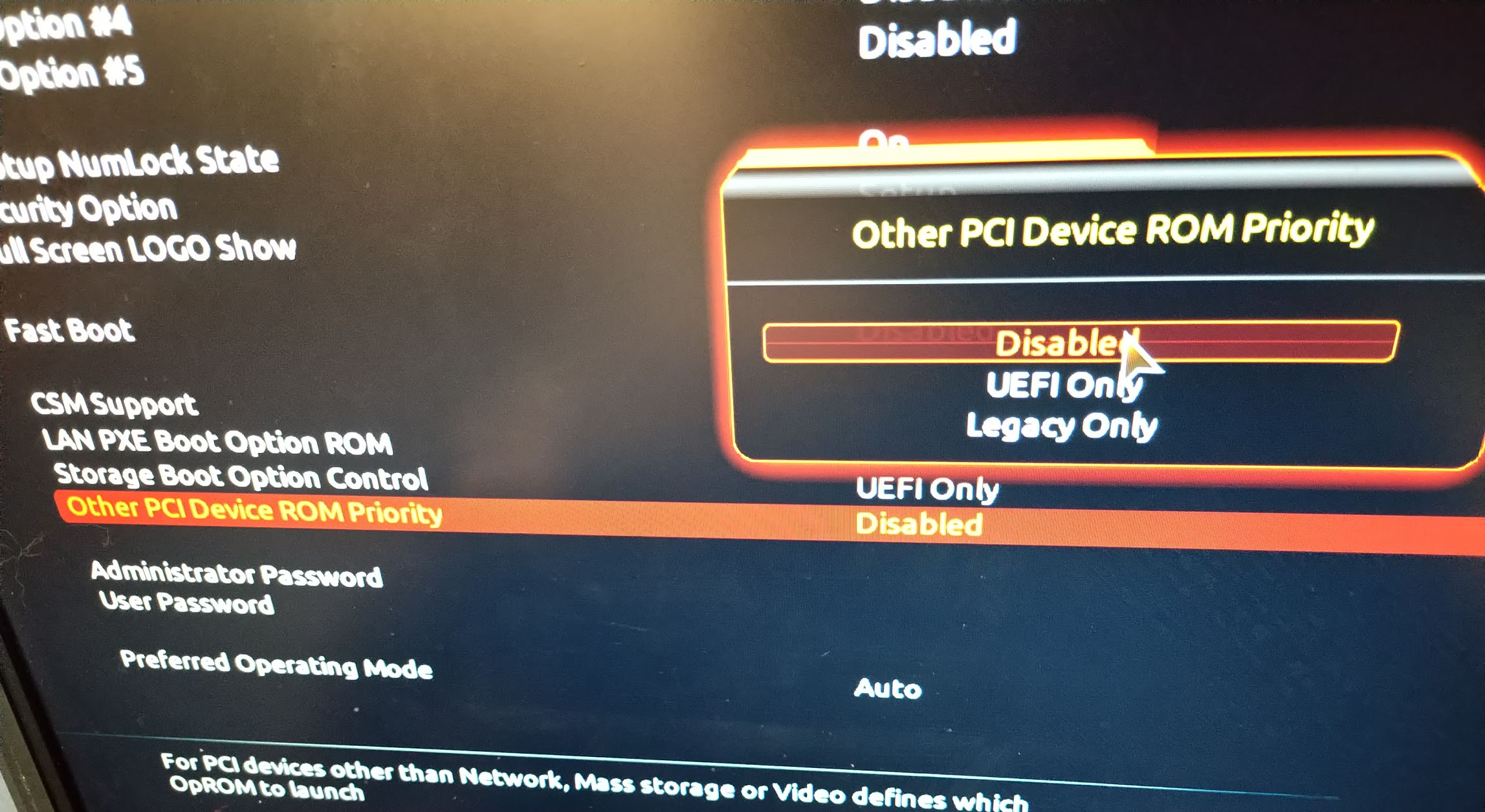

@Celsian Does this setting have any bearing on the configuration requirements? It set to UEFI Only by default:
Description below seems to indicate that it excludes relevancy to video devices.

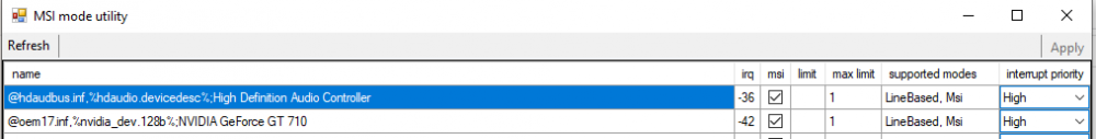

Success! :). I finally had some time to take a good hard look at this issue, and with patience and perseverance, my VM is running again the same as it was in 6.8.3! Here's what I did, but I suspect these steps may not all be necessary.
  1. Download DDU (Display Driver Uninstaller) on another pc and copy it over to a shared drive on the server. I made sure it was unzipped and ready to go, as doing anything in my VM took FOREVER.
  2. Boot your VM
  3. Set it to boot into Safe mode
    1. Hit the windows key.
    2. Type 'msconfig' (without the brackets)
    3. Select Safe boot (I added networking just in case I need network access).
  4. Reboot into safe mode and run DDU. Remove all drivers (AMD, then Intel, finally Nvidia). I may have had bits and pieces of Radeon drivers in there, as I had a Radeon card running in the VM at some point. I wanted to make sure I removed all potential issues.
  5. Download MSI Util v2 on another pc (I already had it, but the link can be found from the wiki. I noticed there's a v3 version as well, but I used the one I had already. Copy it over to a shared drive . Prep it the same as DDU. My VM is extremely slow right now.
  6. Go back to VM, go back into msconfig and set boot back to normal
  7. Reboot VM. VM should perform normally at this point (video will be stuck at 800x600 with no drivers).
  8. Grab the msi util app from the shared drive and save to desktop.
  9. Go to nvidia and grab the current drivers
  10. Install current drivers and reboot.
  11. Performance will degrade to virtually unuseable again. Right click on msi util and RUN AS ADMIN.
  12. Now. Get up, get a coffee/grab a beer/Make lunch for your kids. This part took over an hour for the app to launch and find all the devices in my system.
  13. Once it stops adding things to the list, look for anything related to audio/video. I had 2 a/v entries that did not have msi checked, and no interrupt priority set. I checked the msi box and set them to high priority. MAKE SURE TO HIT APPLY in the top right corner.
  14. Reboot and enjoy the sweet sweet speed of your Windows 10 VM
Of course, our issues may be completely unrelated. My VM never crashed/permanently froze. But any inputs from the mouse were extremely delayed (about 10 seconds between moving the mouse and having it register). Apps also took at least 10 times as long to load. Completely unuseable.
The funny thing is I had already run this utility when I first built the VM. It usually takes care of any stutter or audio artifacts you might find in your Win10 VM. Odd that I had to re-run it, and it had never behaved so poorly before. Usually I might just have a bit of a stutter or audio weirdness.
Finally, as I mentioned at the start, more than likely most people could skip to just running MSI Util and checking 'msi' and setting interrupts to high priority for any a/v entries, but I thought I would provide exactly what I did in case that is not enough.
Good Luck!
Edited by DoeBoye

OMG!! You found the fix for my GTX 1070!!  I had 1 of my 2 gaming VMs completely locking up after the 6.9 update unless i set it to ‘VNC’.  (for some reason my vm using a GTX 1650 was working fine after the update.)
Your instructions (specifically enabling MSI mode and interrupt priority in the utility) fixed it immediately.
Note for the next people to find this:
- Any custom resolutions will need to be set up again. (i remote through an ipad pro, so i have some custom 4:3 resolutions set up)
- If your VM is accessible via HDMI (even at 800x600), but unavailable via any remote software, run the MSI mode utility first.  Upon reboot the previously installed drivers will likely be identified, removing the need for the driver re-install step.
Again, THANK YOU!!  I was just about to create a new Windows 10 VM from scratch to rule out any other variables.  You saved me HOURS!
