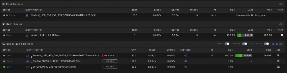

After that I was able to start unraid but my cache pool (2x 1TB SSD as raid 1 btrfs encrypted) showed up as "unmountable: no file system".

Then I stopped the array and removed one cache drive from the pool and startet the array again and tried to mount the disk via unassigned devices and the tips mentioned in the link above (step 1 and 2 only).
But this also didn't help.
Now I restarted again and I am not able to add the second cache drive back to the pool ... obviously.
But the second cache drive doesn't show the encrypted logo nor the filesystem in unassigned devices.
