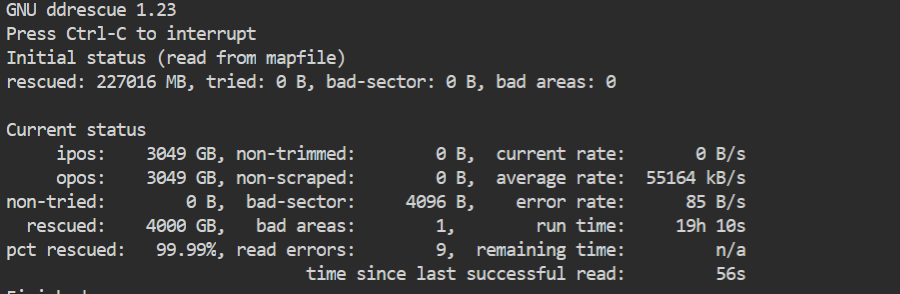

ddrescue went well and i recovered all files.

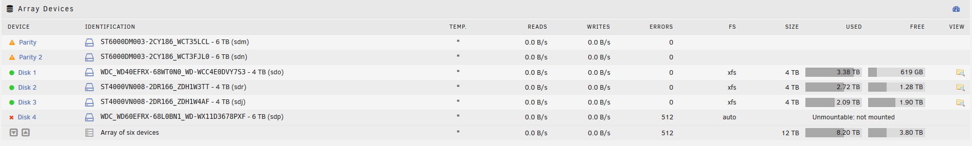

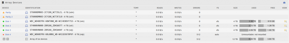

Parity sync started but disk4 had been disabled.
So i guess i have to stop array to replace disk4.
I have no 6Tb disk spare.

i start thinking trouble is with the hotplug enclosure in which i have disk 2, 3 and 4.
when i run xfs_repair -n on disk4 i have an input/output error.
i'm confused.
I replaced sata cable, changed sata port and still I/O error.
So i changed enclosure for disk 4; and still I/O error when doing check _n with gui.
So in a terminal i ran xfs_repair -n on disk4 in the external enclosure and it's running but with gui i have i/o error.
I have good hope for disk 4 as the internal enclosure in which disk4 was primarily had a problem. When i pulled disk 4 the latch of the enclosure was broken and the disk was not maintained as it should.
Post new diags.
Disk looks fine, but since both parity drives are invalid it can't be emulated, if you already replaced cables do another new config to enable all the disks and start a new parity sync.
