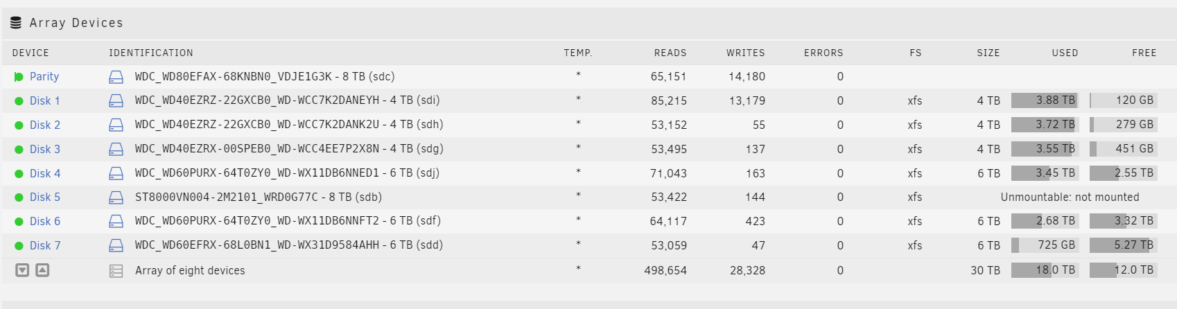

(SOLVED) Unmountable: not mounted
Yep as other people who have similar issues I dare not touch until I know what I need to do.
mynas-diagnostics-20210309-1800.zip
After a restart this is what happened to sdb
I tried changing the cable but still the same. I wonder how should I proceed from here?
Do I need to xfs_repair -v /dev/ something?
It's been few days because I didnt have the time (work) to fix this immediately.
I wonder what would happen to my data?
Anyone can fill me here?
Thanks!

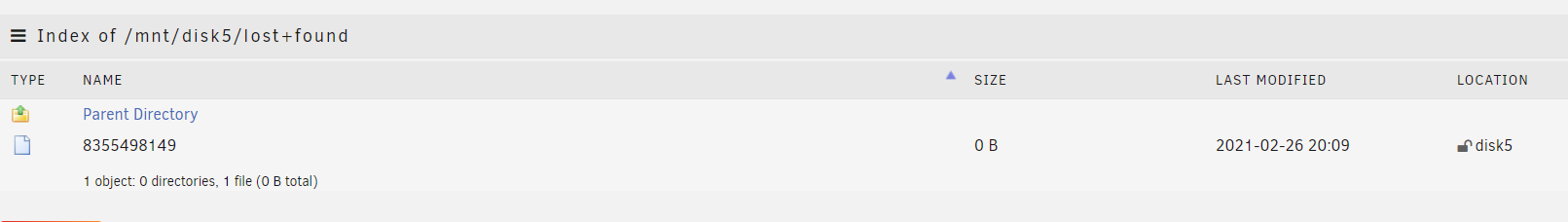

So this is what I got from the first checkup. Doesnt look so good.
Trying to do xfs_repair -nv /dev/sdb now
Edited by sevenz
You need to remove -n or nothing will be done, and if it asks for it use -L.

Did you get a lost+found share after the repair?
Sorry for the late reply, yes I do but only 1 file.
