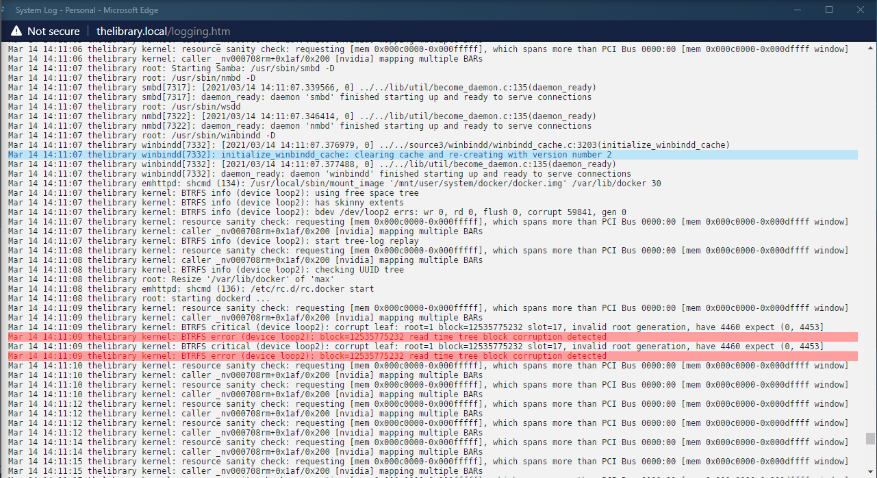

btrfs errors on device loop2 Cache drive goes read only
Syslog attached. Detail of build is in my sig. Motherboard BMC chip died and has been replaced. Other than that and the upgrade to 6.9. Nothing out of the norm.

Assuming loop2 is the docker image, if you're not sure post the complete diagnostics, delete and recreate.
Docker deleted (had to reboot, that kills all the logs and what not right?) and rebuilt. I guess now we wait.
