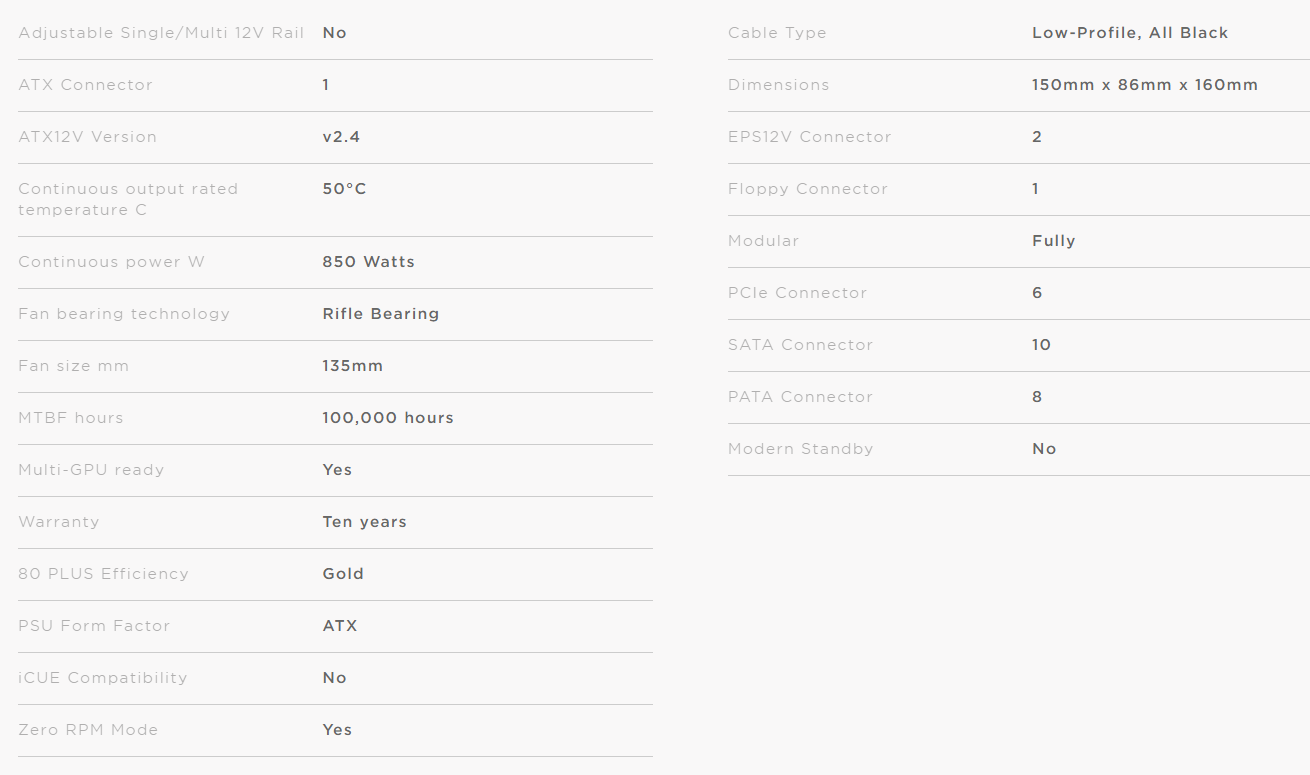

March 23, 20215 yr Author I will need 18 for hard drives and a further 5 for ssd to max out the case. I'm s bit confused over the markings peripheral/sata on the psus I've looked at. Are each of those connections identical in power output so that I can use any of them for sata drives? Also the board I have has a 24 pin ATX connector AND two eps12v connectors. Again, the psus I've seen only have a 20 pin ATX power connector. How do you power the missing 4 pins? Edited March 23, 20215 yr by superloopy1
March 23, 20215 yr 1 hour ago, uldise said: @SimonF Seasonic please Sorry dont know about Seasonic, quick google seems they dont sell spares. Maybe look at modDIY.com or https://www.btosinte.com/Cables-for-PS2-power-supply_c7.htm
March 23, 20215 yr 2 minutes ago, superloopy1 said: I'm s bit confused over the markings peripheral/sata They are the same. Depends on the modular cable you connect. Perpherial just has the molex connectors rather than sata.
March 24, 20215 yr Author Thanks, I'm getting there. That. Corsair PSU has no molex unfortunately, seasonics do but not the requisite EPs connectors. I'm still struggling for a decent 850w PSU with both AND a small profile if possible. Oh, and aiming, what coolers are on your cpu?. I need to source those next. Case should arrive today ...
March 24, 20215 yr It should come with 8 Molex connections the peripheral ones (PATA) I think is on the datasheet. You should be able to see from the cable pack image I sent previously. https://www.amazon.co.uk/Noctua-NH-U12DX-Premium-Cooler-LGA20xx/dp/B00DWFQ42I I added a second fan to each cooler. https://www.corsair.com/uk/en/Categories/Products/Power-Supply-Units/Power-Supply-Units-Advanced/RMx-Series/p/CP-9020180-UK#tab-tech-specs

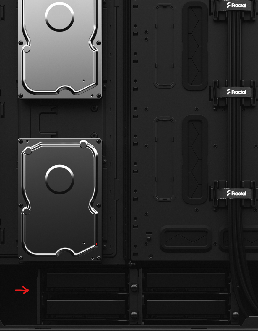

March 24, 20215 yr Author Thanks for all the info. Case has arrived but it's only got 2 drive trays (type b) , is that correct?. The manual says it should have 6 so I expected to see the rest in the case itself but nothing! Can anyone remember how many actual trays this ships with? I've raised it with Scan who shipped the case. Let's see what they say. Edited March 24, 20215 yr by superloopy1
March 24, 20215 yr Author 4 hours ago, SimonF said: Looking in the manual they seem to be on the opposite side to normal. I do have those, what's missing are the trays which fix inside the case, where your bank of 12 (9) are ... spoke to seller and they are to check tomorrow but even the box that the case comes in says that max of 18 drives with 6 trays supplied alongwith those two cradles and 2 x 2.5" ssd mounting plates which i do have. I'm missing any trays for my hard drives. Fortunately i had already purchased the extra 10 trays i need which arrived today so its not going to hold up the build ... what is holding up the build is that my cpus still have to arrive .... dual e5-2683v4, oh, amd the psu. In the end i went for a corsair hx850 platinum cos its got 16 sata. i hope. Out of stock atm but expevted in tomorrow. Let's see ... and lets hope everythings good at the end of this ... i appreciate all the help people are giving. Edited March 24, 20215 yr by superloopy1
