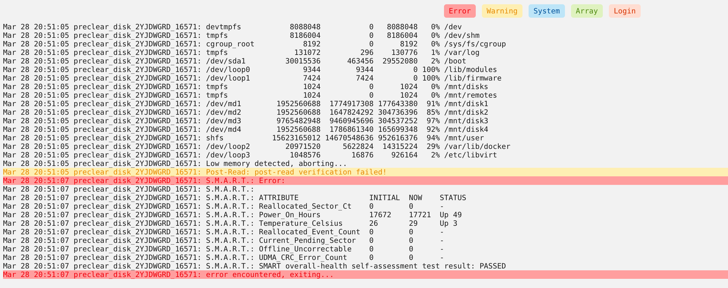

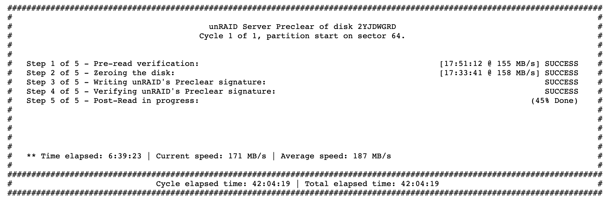

The drive has about 7 hours left on the post read section of preclear - but based on what it has already done I think its looking pretty good.  I don't see anything concerning so when it completes I think I will use it for the rebuild and then use the new drive to replace one of my smaller disks.

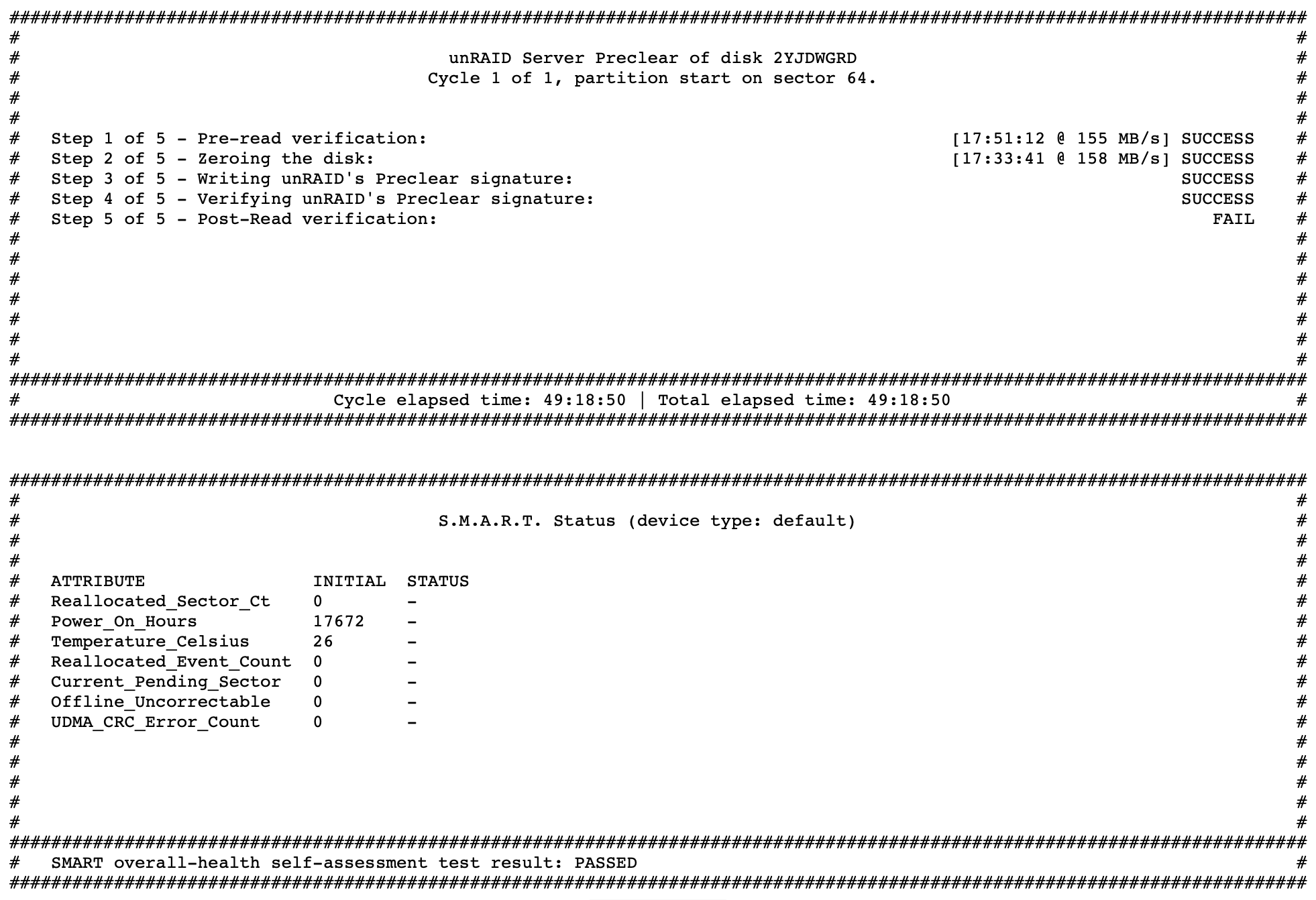

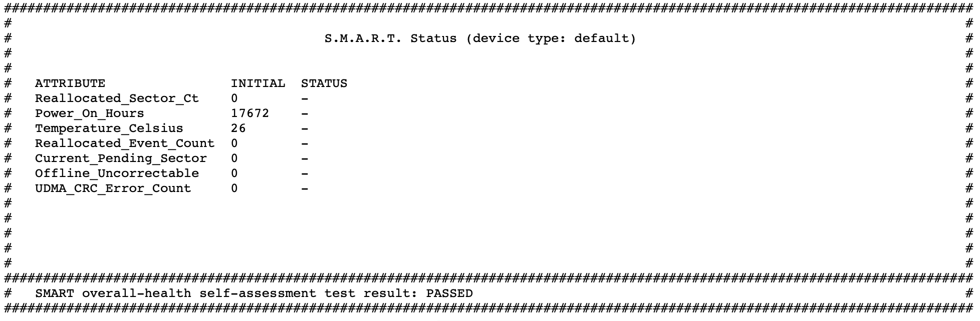

Well, bummer - it failed the post read on preclear.  Smart still says its good - but there are a ton of errors in this log - Thoughts?

Mar 27 13:23:28 Maximus preclear_disk_2YJDWGRD[16571]: Zeroing: dd if=/dev/zero of=/dev/sdb bs=2097152 seek=2097152 count=10000829251584 conv=notrunc iflag=count_bytes,nocache,fullblock oflag=seek_bytes
Mar 28 06:57:10 Maximus preclear_disk_2YJDWGRD[16571]: Post-Read: cmp /tmp/.preclear/sdb/fifo /dev/zero
Mar 28 06:57:10 Maximus preclear_disk_2YJDWGRD[16571]: Post-Read: dd if=/dev/sdb of=/tmp/.preclear/sdb/fifo count=2096640 skip=512 iflag=nocache,count_bytes,skip_bytes
Mar 28 06:57:11 Maximus preclear_disk_2YJDWGRD[16571]: Post-Read: cmp /tmp/.preclear/sdb/fifo /dev/zero
Mar 28 06:57:11 Maximus preclear_disk_2YJDWGRD[16571]: Post-Read: dd if=/dev/sdb of=/tmp/.preclear/sdb/fifo bs=2097152 skip=2097152 count=10000829251584 iflag=nocache,count_bytes,skip_bytes

Mar 28 07:06:33 Maximus kernel: sd 1:0:0:0: [sdb] tag#29 UNKNOWN(0x2003) Result: hostbyte=0x00 driverbyte=0x08
Mar 28 07:06:33 Maximus kernel: sd 1:0:0:0: [sdb] tag#29 Sense Key : 0x5 [current]
Mar 28 07:06:33 Maximus kernel: sd 1:0:0:0: [sdb] tag#29 ASC=0x21 ASCQ=0x4
Mar 28 07:06:33 Maximus kernel: sd 1:0:0:0: [sdb] tag#29 CDB: opcode=0x88 88 00 00 00 00 00 0c b4 14 00 00 00 05 40 00 00
Mar 28 07:06:33 Maximus kernel: print_req_error: I/O error, dev sdb, sector 213128192
Mar 28 07:06:33 Maximus kernel: sd 1:0:0:0: [sdb] tag#30 UNKNOWN(0x2003) Result: hostbyte=0x00 driverbyte=0x08
Mar 28 07:06:33 Maximus kernel: sd 1:0:0:0: [sdb] tag#30 Sense Key : 0x5 [current]
Mar 28 07:06:33 Maximus kernel: sd 1:0:0:0: [sdb] tag#30 ASC=0x21 ASCQ=0x4
Mar 28 07:06:33 Maximus kernel: sd 1:0:0:0: [sdb] tag#30 CDB: opcode=0x88 88 00 00 00 00 00 0c b4 19 40 00 00 00 c0 00 00
Mar 28 07:06:33 Maximus kernel: print_req_error: I/O error, dev sdb, sector 213129536
Mar 28 07:06:33 Maximus kernel: ata1: EH complete
Mar 28 07:08:13 Maximus kernel: ata1.00: exception Emask 0x50 SAct 0x7808000 SErr 0x4090800 action 0xe frozen
Mar 28 07:08:13 Maximus kernel: ata1.00: irq_stat 0x00400040, connection status changed
Mar 28 07:08:13 Maximus kernel: ata1: SError: { HostInt PHYRdyChg 10B8B DevExch }
Mar 28 07:08:13 Maximus kernel: ata1.00: failed command: READ FPDMA QUEUED
Mar 28 07:08:13 Maximus kernel: ata1.00: cmd 60/01:78:c7:e5:7a/00:00:dd:00:00/40 tag 15 ncq dma 512 in
Mar 28 07:08:13 Maximus kernel: ata1.00: status: { DRDY }
Mar 28 07:08:13 Maximus kernel: ata1.00: cmd 60/40:b8:00:5a:07/05:00:0f:00:00/40 tag 23 ncq dma 688128 in
Mar 28 07:08:13 Maximus kernel: ata1.00: cmd 60/c0:c0:40:5f:07/04:00:0f:00:00/40 tag 24 ncq dma 622592 in
Mar 28 07:08:13 Maximus kernel: ata1.00: cmd 60/40:c8:00:64:07/05:00:0f:00:00/40 tag 25 ncq dma 688128 in
Mar 28 07:08:13 Maximus kernel: ata1.00: cmd 60/c0:d0:40:69:07/00:00:0f:00:00/40 tag 26 ncq dma 98304 in
Mar 28 07:08:13 Maximus kernel: ata1: hard resetting link
Mar 28 07:08:19 Maximus kernel: ata1: link is slow to respond, please be patient (ready=0)
Mar 28 07:08:23 Maximus kernel: ata1: COMRESET failed (errno=-16)
Mar 28 07:08:23 Maximus kernel: ata1: hard resetting link
Mar 28 07:08:25 Maximus kernel: ata1: SATA link up 6.0 Gbps (SStatus 133 SControl 300)
Mar 28 07:08:26 Maximus kernel: ata1.00: configured for UDMA/133
Mar 28 07:08:26 Maximus kernel: sd 1:0:0:0: [sdb] tag#23 UNKNOWN(0x2003) Result: hostbyte=0x00 driverbyte=0x08
Mar 28 07:08:26 Maximus kernel: sd 1:0:0:0: [sdb] tag#23 Sense Key : 0x5 [current]
Mar 28 07:08:26 Maximus kernel: sd 1:0:0:0: [sdb] tag#23 ASC=0x21 ASCQ=0x4
Mar 28 07:08:26 Maximus kernel: sd 1:0:0:0: [sdb] tag#23 CDB: opcode=0x88 88 00 00 00 00 00 0f 07 5a 00 00 00 05 40 00 00
Mar 28 07:08:26 Maximus kernel: print_req_error: I/O error, dev sdb, sector 252140032
Mar 28 07:08:26 Maximus kernel: sd 1:0:0:0: [sdb] tag#24 UNKNOWN(0x2003) Result: hostbyte=0x00 driverbyte=0x08
Mar 28 07:08:26 Maximus kernel: sd 1:0:0:0: [sdb] tag#24 Sense Key : 0x5 [current]
Mar 28 07:08:26 Maximus kernel: sd 1:0:0:0: [sdb] tag#24 ASC=0x21 ASCQ=0x4
Mar 28 07:08:26 Maximus kernel: sd 1:0:0:0: [sdb] tag#24 CDB: opcode=0x88 88 00 00 00 00 00 0f 07 5f 40 00 00 04 c0 00 00
Mar 28 07:08:26 Maximus kernel: print_req_error: I/O error, dev sdb, sector 252141376
Mar 28 07:08:26 Maximus kernel: sd 1:0:0:0: [sdb] tag#25 UNKNOWN(0x2003) Result: hostbyte=0x00 driverbyte=0x08
Mar 28 07:08:26 Maximus kernel: sd 1:0:0:0: [sdb] tag#25 Sense Key : 0x5 [current]
Mar 28 07:08:26 Maximus kernel: sd 1:0:0:0: [sdb] tag#25 ASC=0x21 ASCQ=0x4
Mar 28 07:08:26 Maximus kernel: sd 1:0:0:0: [sdb] tag#25 CDB: opcode=0x88 88 00 00 00 00 00 0f 07 64 00 00 00 05 40 00 00
Mar 28 07:08:26 Maximus kernel: print_req_error: I/O error, dev sdb, sector 252142592
Mar 28 07:08:26 Maximus kernel: sd 1:0:0:0: [sdb] tag#26 UNKNOWN(0x2003) Result: hostbyte=0x00 driverbyte=0x08
Mar 28 07:08:26 Maximus kernel: sd 1:0:0:0: [sdb] tag#26 Sense Key : 0x5 [current]
Mar 28 07:08:26 Maximus kernel: sd 1:0:0:0: [sdb] tag#26 ASC=0x21 ASCQ=0x4
Mar 28 07:08:26 Maximus kernel: sd 1:0:0:0: [sdb] tag#26 CDB: opcode=0x88 88 00 00 00 00 00 0f 07 69 40 00 00 00 c0 00 00
Mar 28 07:08:26 Maximus kernel: print_req_error: I/O error, dev sdb, sector 252143936
Mar 28 07:08:26 Maximus kernel: ata1: EH complete
Mar 28 07:11:52 Maximus kernel: ata1.00: exception Emask 0x50 SAct 0x20003c08 SErr 0x4090800 action 0xe frozen
Mar 28 07:11:52 Maximus kernel: ata1.00: irq_stat 0x00400040, connection status changed
Mar 28 07:11:52 Maximus kernel: ata1: SError: { HostInt PHYRdyChg 10B8B DevExch }
Mar 28 07:11:52 Maximus kernel: ata1.00: failed command: READ FPDMA QUEUED
Mar 28 07:11:52 Maximus kernel: ata1.00: cmd 60/01:18:50:9f:e4/00:00:e8:00:00/40 tag 3 ncq dma 512 in
Mar 28 07:11:52 Maximus kernel: ata1.00: status: { DRDY }
Mar 28 07:11:52 Maximus kernel: ata1.00: cmd 60/40:50:00:ea:cb/05:00:13:00:00/40 tag 10 ncq dma 688128 in
Mar 28 07:11:52 Maximus kernel: ata1.00: cmd 60/c0:58:40:ef:cb/04:00:13:00:00/40 tag 11 ncq dma 622592 in
Mar 28 07:11:52 Maximus kernel: ata1.00: cmd 60/40:60:00:f4:cb/05:00:13:00:00/40 tag 12 ncq dma 688128 in
Mar 28 07:11:52 Maximus kernel: ata1.00: cmd 60/c0:68:40:f9:cb/00:00:13:00:00/40 tag 13 ncq dma 98304 in
Mar 28 07:11:52 Maximus kernel: ata1.00: cmd 60/01:e8:3c:95:69/00:00:9f:00:00/40 tag 29 ncq dma 512 in
Mar 28 07:11:52 Maximus kernel: ata1: hard resetting link
Mar 28 07:11:58 Maximus kernel: ata1: link is slow to respond, please be patient (ready=0)
Mar 28 07:12:02 Maximus kernel: ata1: COMRESET failed (errno=-16)
Mar 28 07:12:02 Maximus kernel: ata1: hard resetting link
Mar 28 07:12:04 Maximus kernel: ata1: SATA link up 6.0 Gbps (SStatus 133 SControl 300)
Mar 28 07:12:06 Maximus kernel: ata1.00: configured for UDMA/133
Mar 28 07:12:06 Maximus kernel: sd 1:0:0:0: [sdb] tag#10 UNKNOWN(0x2003) Result: hostbyte=0x00 driverbyte=0x08
Mar 28 07:12:06 Maximus kernel: sd 1:0:0:0: [sdb] tag#10 Sense Key : 0x5 [current]
Mar 28 07:12:06 Maximus kernel: sd 1:0:0:0: [sdb] tag#10 ASC=0x21 ASCQ=0x4
Mar 28 07:12:06 Maximus kernel: sd 1:0:0:0: [sdb] tag#10 CDB: opcode=0x88 88 00 00 00 00 00 13 cb ea 00 00 00 05 40 00 00
Mar 28 07:12:06 Maximus kernel: print_req_error: I/O error, dev sdb, sector 332130816
Mar 28 07:12:06 Maximus kernel: sd 1:0:0:0: [sdb] tag#11 UNKNOWN(0x2003) Result: hostbyte=0x00 driverbyte=0x08
Mar 28 07:12:06 Maximus kernel: sd 1:0:0:0: [sdb] tag#11 Sense Key : 0x5 [current]
Mar 28 07:12:06 Maximus kernel: sd 1:0:0:0: [sdb] tag#11 ASC=0x21 ASCQ=0x4
Mar 28 07:12:06 Maximus kernel: sd 1:0:0:0: [sdb] tag#11 CDB: opcode=0x88 88 00 00 00 00 00 13 cb ef 40 00 00 04 c0 00 00
Mar 28 07:12:06 Maximus kernel: print_req_error: I/O error, dev sdb, sector 332132160
Mar 28 07:12:06 Maximus kernel: sd 1:0:0:0: [sdb] tag#12 UNKNOWN(0x2003) Result: hostbyte=0x00 driverbyte=0x08
Mar 28 07:12:06 Maximus kernel: sd 1:0:0:0: [sdb] tag#12 Sense Key : 0x5 [current]
Mar 28 07:12:06 Maximus kernel: sd 1:0:0:0: [sdb] tag#12 ASC=0x21 ASCQ=0x4
Mar 28 07:12:06 Maximus kernel: sd 1:0:0:0: [sdb] tag#12 CDB: opcode=0x88 88 00 00 00 00 00 13 cb f4 00 00 00 05 40 00 00
Mar 28 07:12:06 Maximus kernel: print_req_error: I/O error, dev sdb, sector 332133376
Mar 28 07:12:06 Maximus kernel: sd 1:0:0:0: [sdb] tag#13 UNKNOWN(0x2003) Result: hostbyte=0x00 driverbyte=0x08
Mar 28 07:12:06 Maximus kernel: sd 1:0:0:0: [sdb] tag#13 Sense Key : 0x5 [current]
Mar 28 07:12:06 Maximus kernel: sd 1:0:0:0: [sdb] tag#13 ASC=0x21 ASCQ=0x4
Mar 28 07:12:06 Maximus kernel: sd 1:0:0:0: [sdb] tag#13 CDB: opcode=0x88 88 00 00 00 00 00 13 cb f9 40 00 00 00 c0 00 00
Mar 28 07:12:06 Maximus kernel: print_req_error: I/O error, dev sdb, sector 332134720
Mar 28 07:12:06 Maximus kernel: ata1: EH complete
It dropped offline. Cables (both SATA and power) are the main suspects, though it could be a controller problem.
That sometimes indicates RAM issues.
And you don't want to run any computer unless memory is working perfectly.
Have you done memtest?
