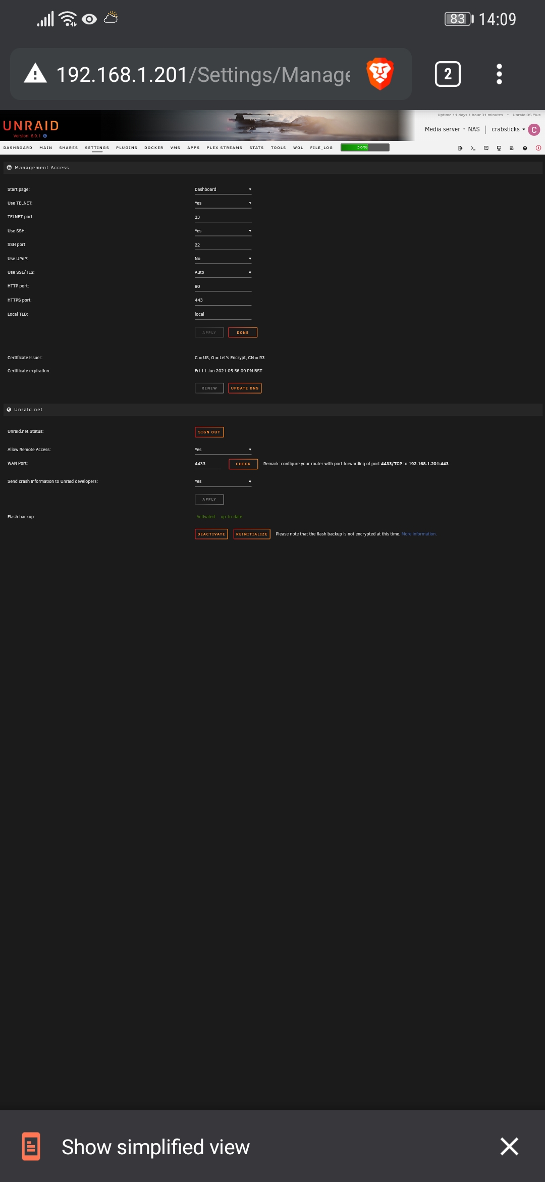

I opened port 4433 and used the redirect on the settings page, that comes back with a green tick when I check it
Did you change the port in the settings only to "Allow Remote Access" only ?
If yes then you have one more tab up a bit to change the port number as well. " HTTPS port: "

Is at the management access under  " HTTPS port: " you have to change it there as well the 443

  • On the Settings -> Management Access page, the "HTTPS port" setting is the port to use when connecting internally on your LAN.  443 is the most convenient because then you don't have to include the port in the url (443 is the default port for https)
  • On the Settings -> Management Access -> Unraid.net page, the "WAN port" is the port to use when connecting from the outside. For extra security, this should be a high random number, not 443. And of course, you need to setup a port forward in your router from the WAN port to the internal port.
