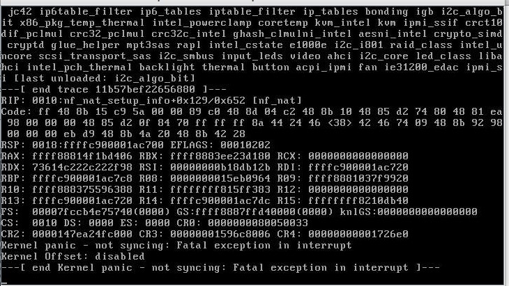

Hi, I have been dealing with kernel panics since 6.9.1 upgrade. I need help to identify and fix the issue.
Strangely it only happens during the night.
Any help will be appreciate,

I just got a kernel panic again, hopefully I have enabled the syslog server, so I have the syslog, hope it helps.
Best regards,
André Rung
syslog-192.168.0.175.log

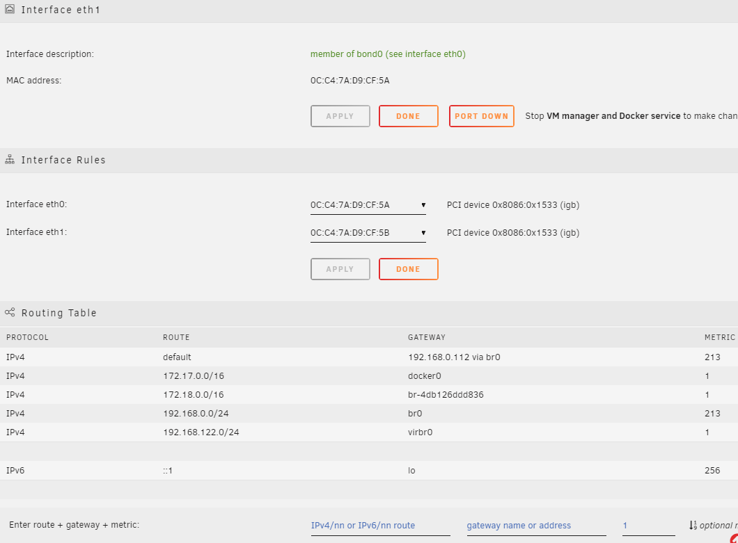

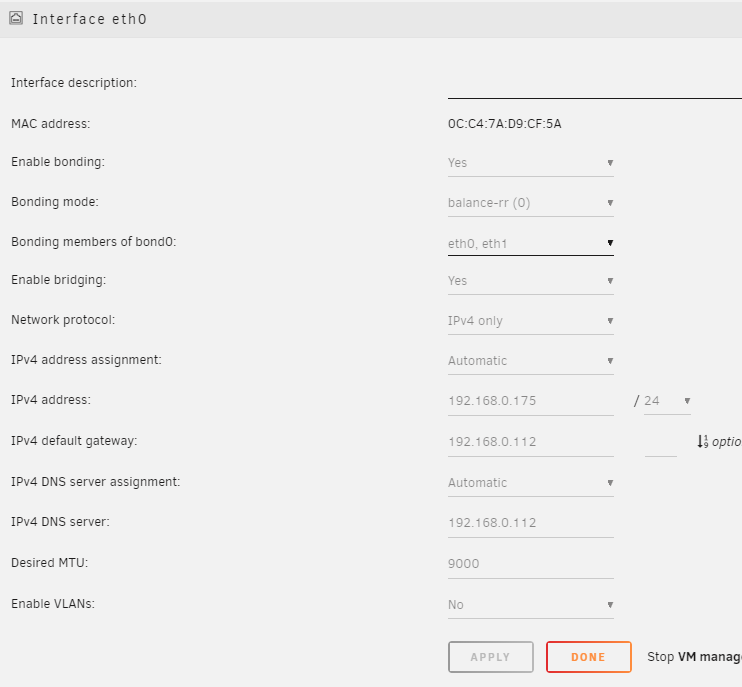

You have a layer 2 loop in your Unraid connection. Likely two or more interfaces are configured in the same bridge group, causing the loop.
Either disconnect physical interfaces or reconfigure Unraid to use bonding when multiple interfaces are wanted.
I do have bond configured, I may have it wrong...
Best regards,
André Rung
balance-rr (round-robin) requires a switch to support this mode, better change to another balance mode, chose either mode 5 or 6, which works independent of the switch.
Ok, I have switched to option (5). Let's see if it does any difference.
