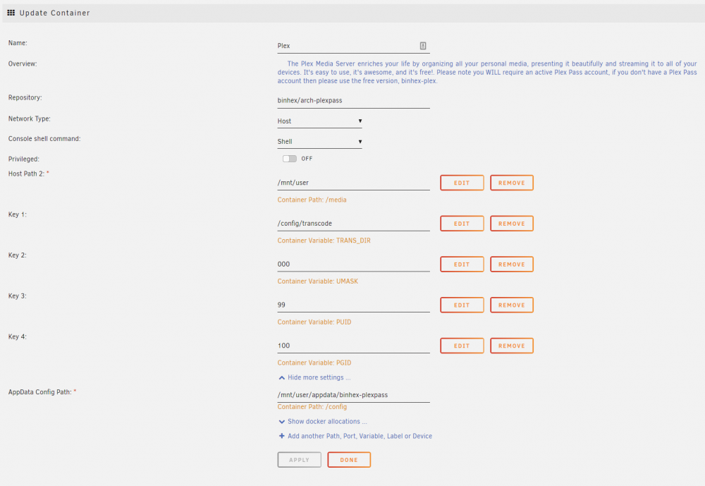

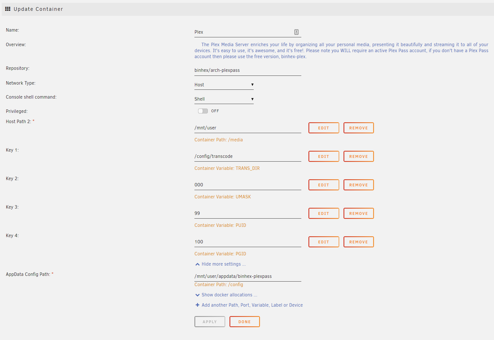

It's been a while since I set this up. My current container path is /mnt/user/appdata/
Is there a preferred location for me to remap this to?
That looks OK. Plex isn't the most likely candidate for writing much data anyway except for transcoding and if you use DVR feature.

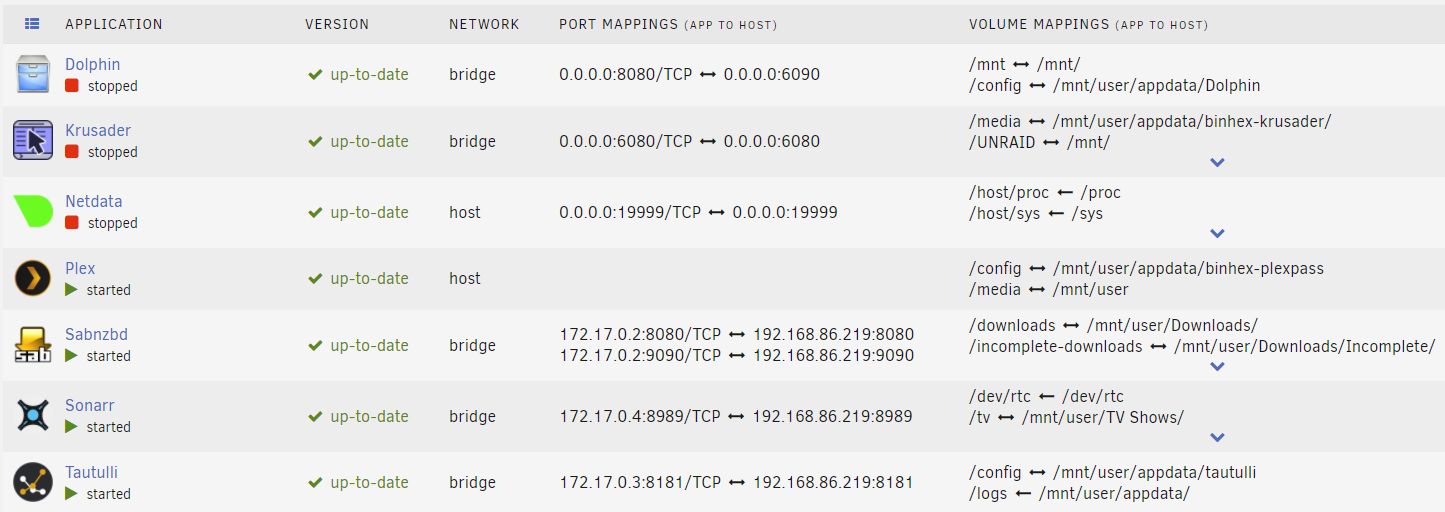

Is that your only docker?
Here are all my dockers.
If it's not Plex, it's weird that the memory goes down once I restart it.
Nothing obvious in the screenshot.
