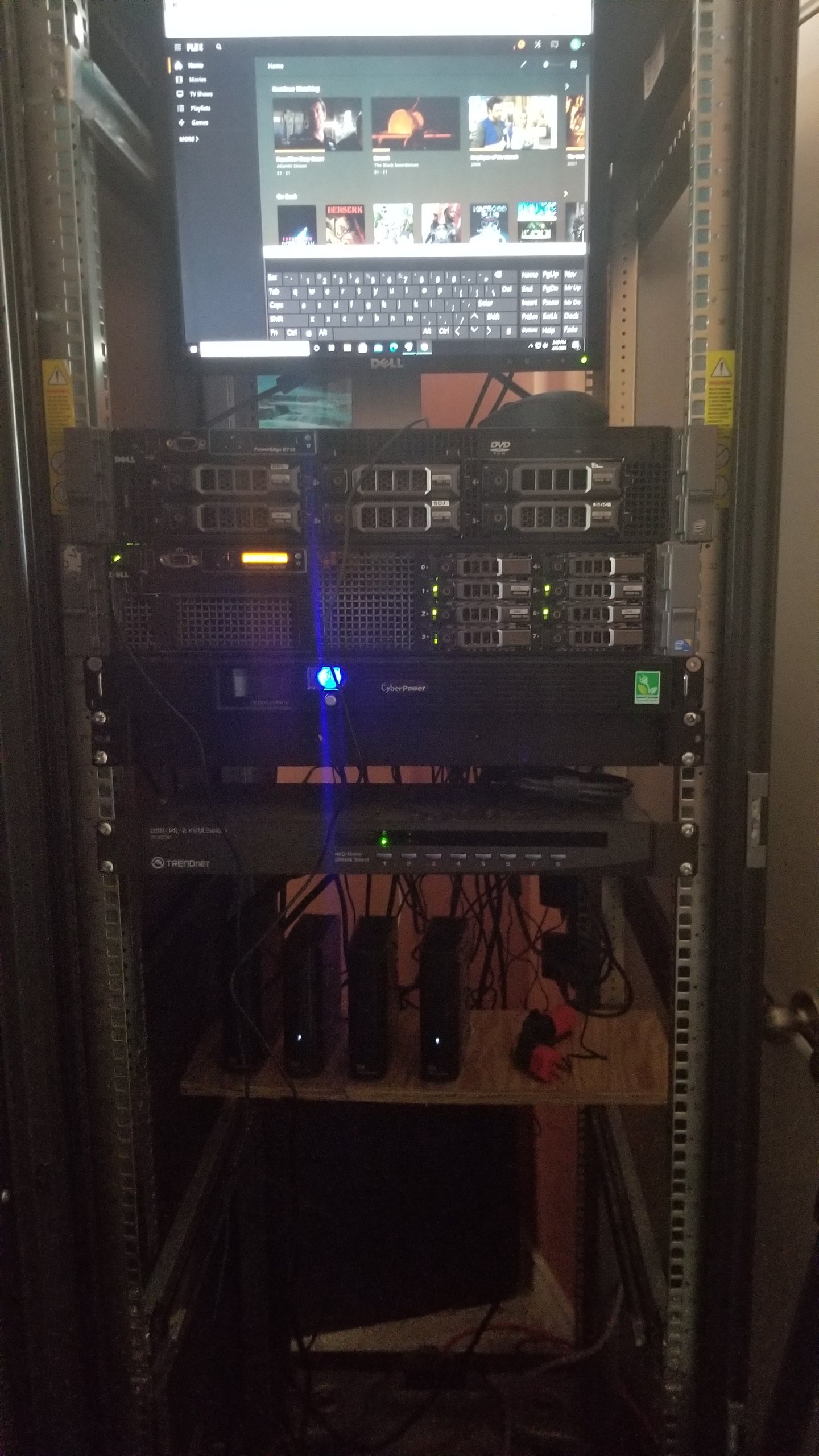

First time user of unraid so alot to learn but had a few questions I couldn't find the answers to yet so if anyone can help or point me in the right direction Id appreciate it. I have a 2 Dell r710's one with a 2.5 HHD's, 1tb each and the other with 3.5 HDD's, 2tb each. I'm using one for a plex server with 4, (12tb external hdd) and 1, (8tb external hdd) plugged into them with movies and want to expand them with another 8, (12tb hdd) but as it stands right now I have no redundancy for my setup. I originally planned to mount the drives in the r710s and use a raid 5 or 6 but found out after the fact they only support 2-3tb hdd depending on the raid controller. I also picked up a free md1000 but those also have a limit on space so left with using the servers as the processors and adding in external drives at this point. So my main question is if Unraid can and will support a bunch of external HDD in redundancy and if there is a far better route I should be taking with this. I am rather new with servers and delving into this side of things so trying to make heads or tales of other forums I've read up on is extremal difficult to even begin to understand.

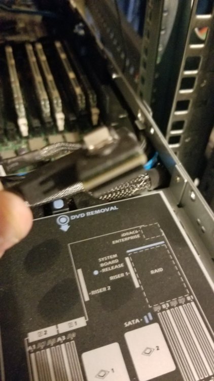

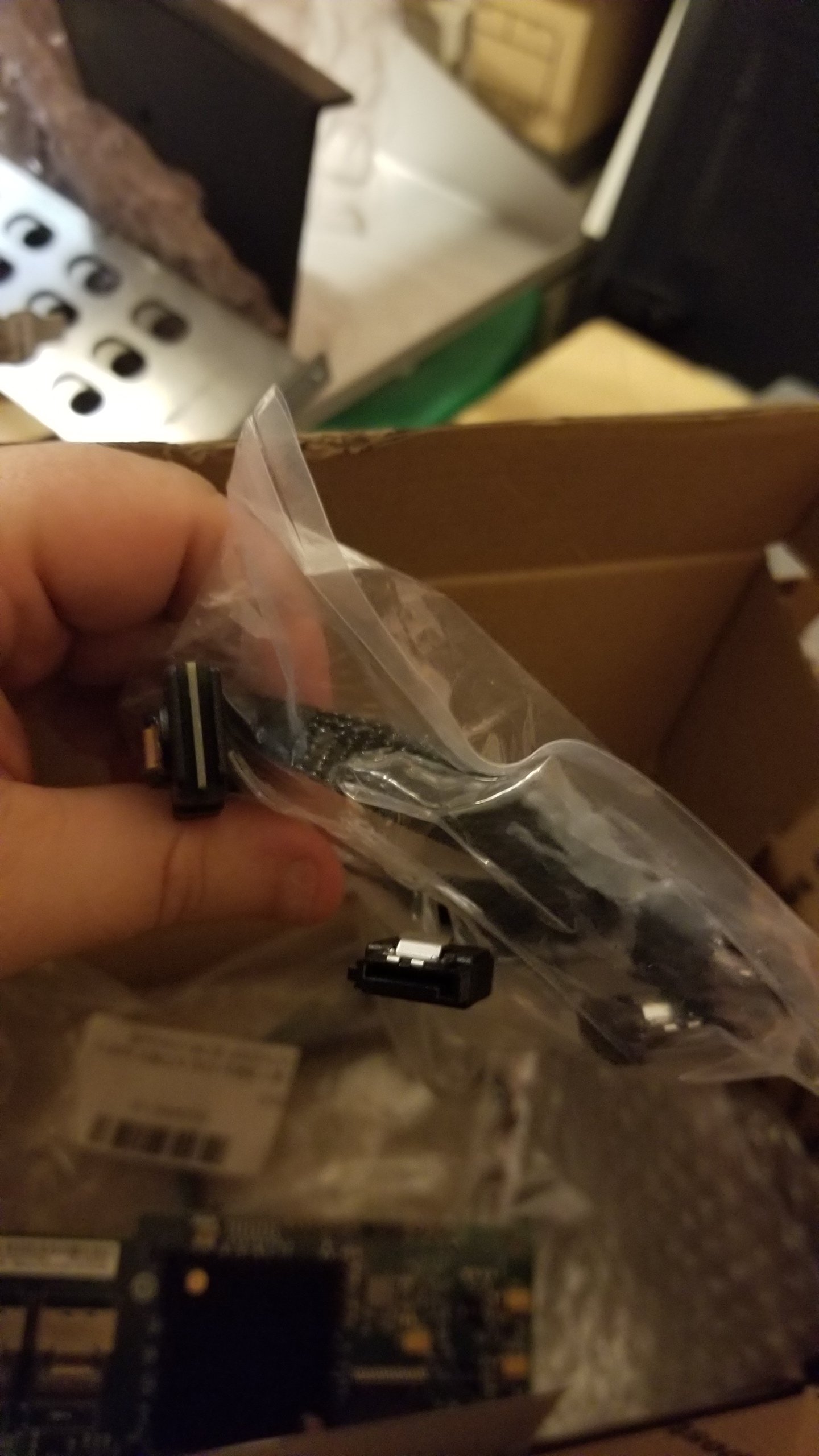

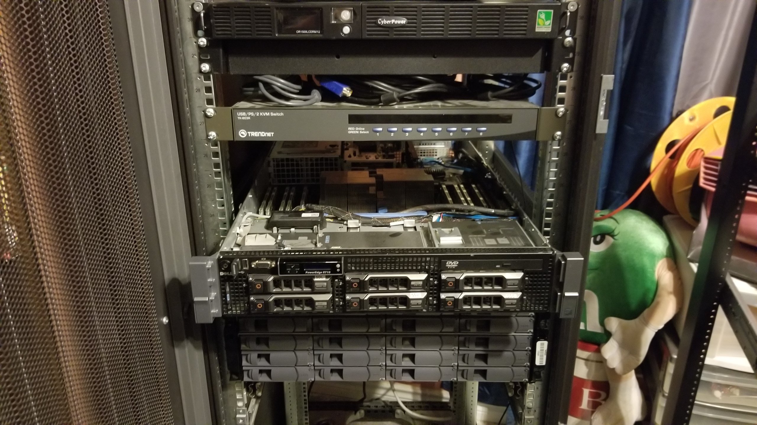

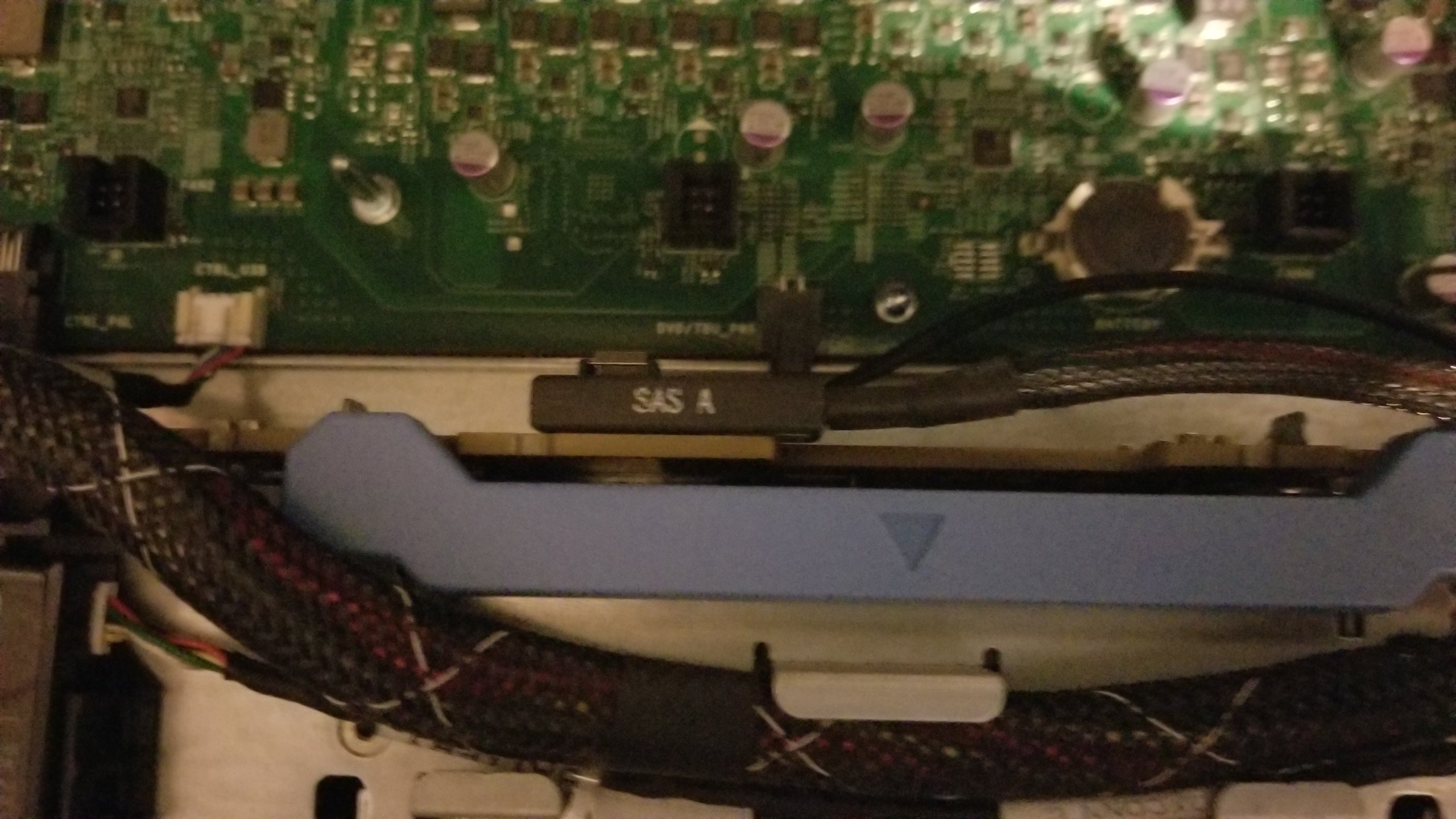

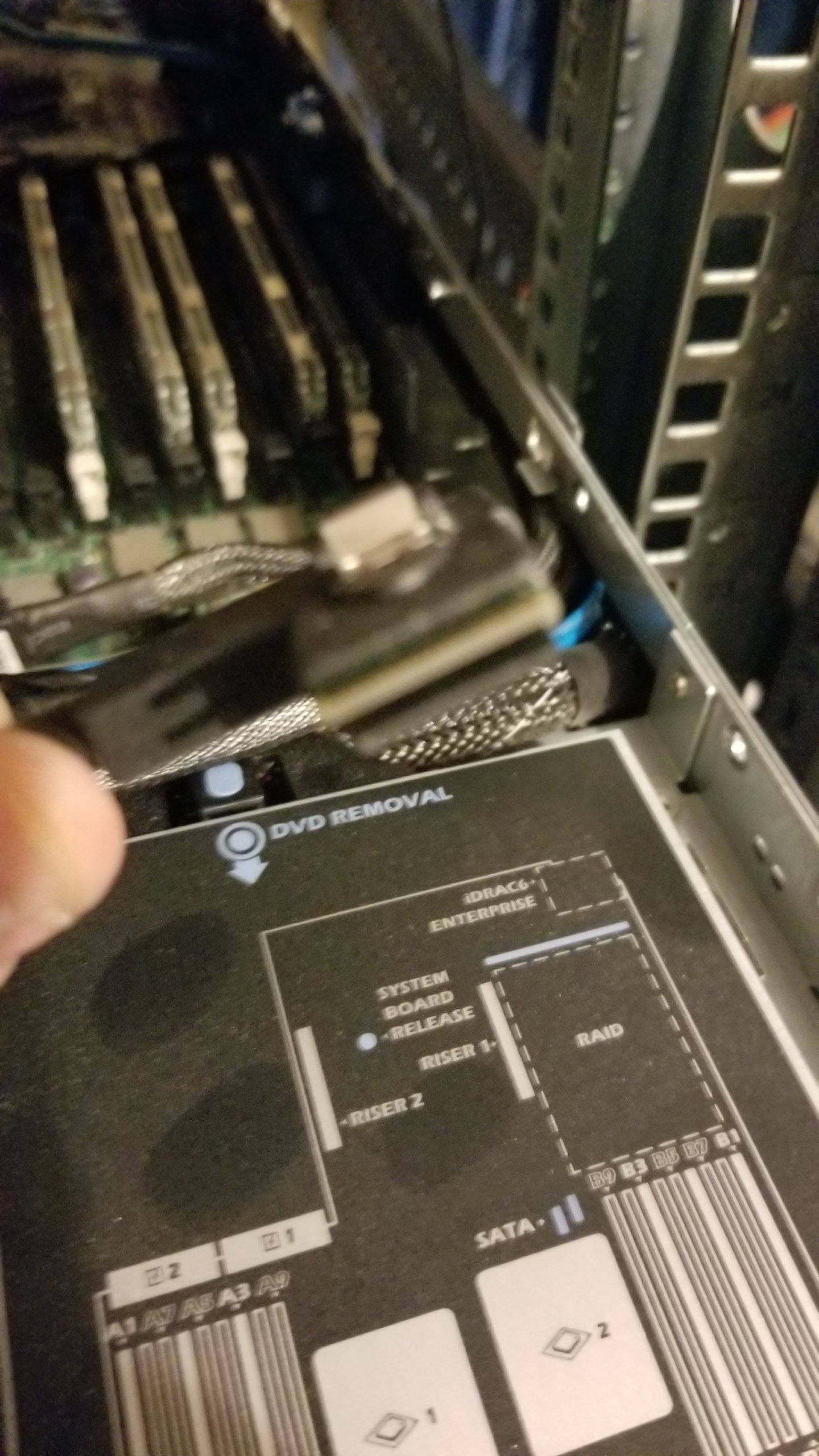

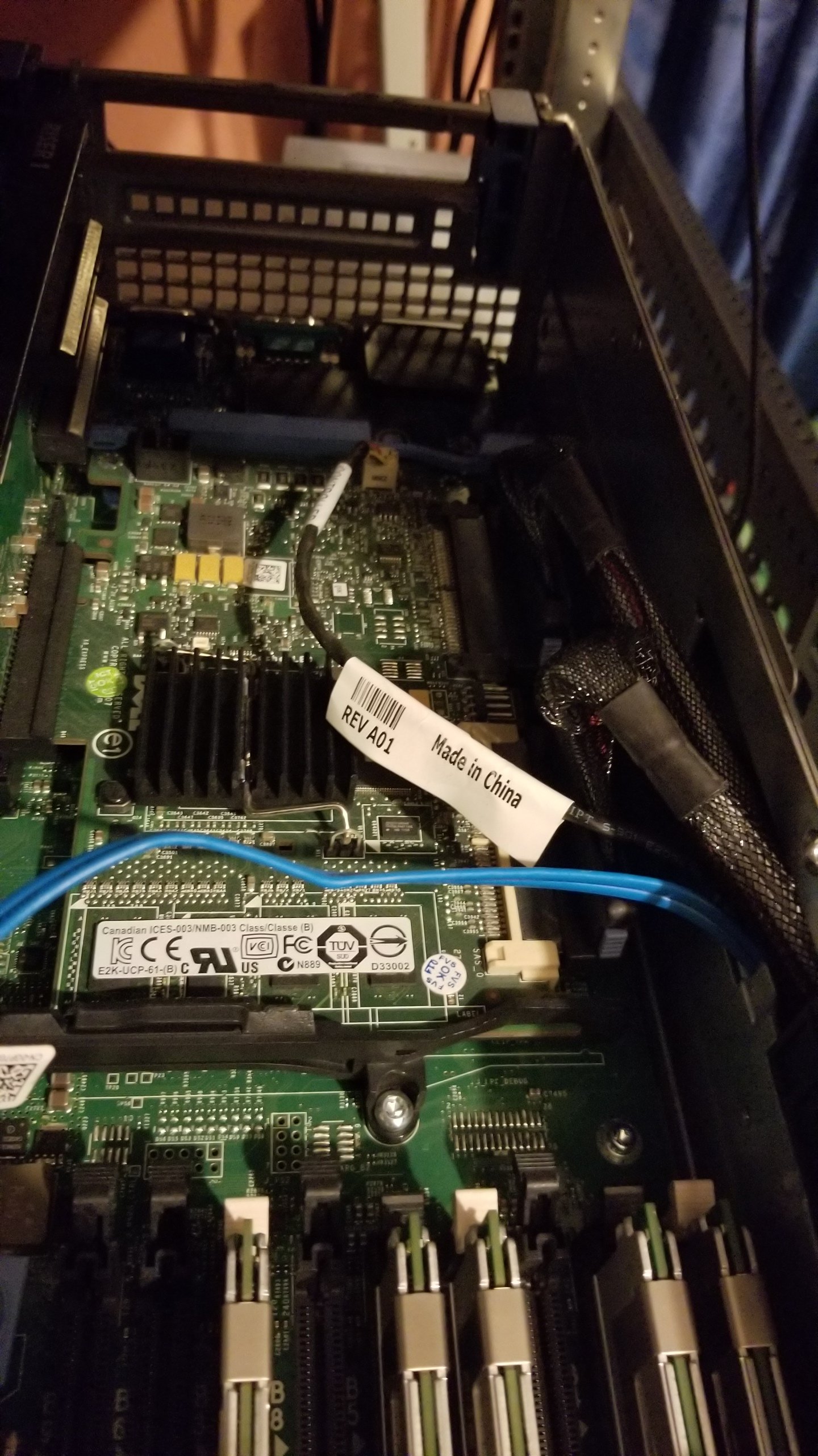

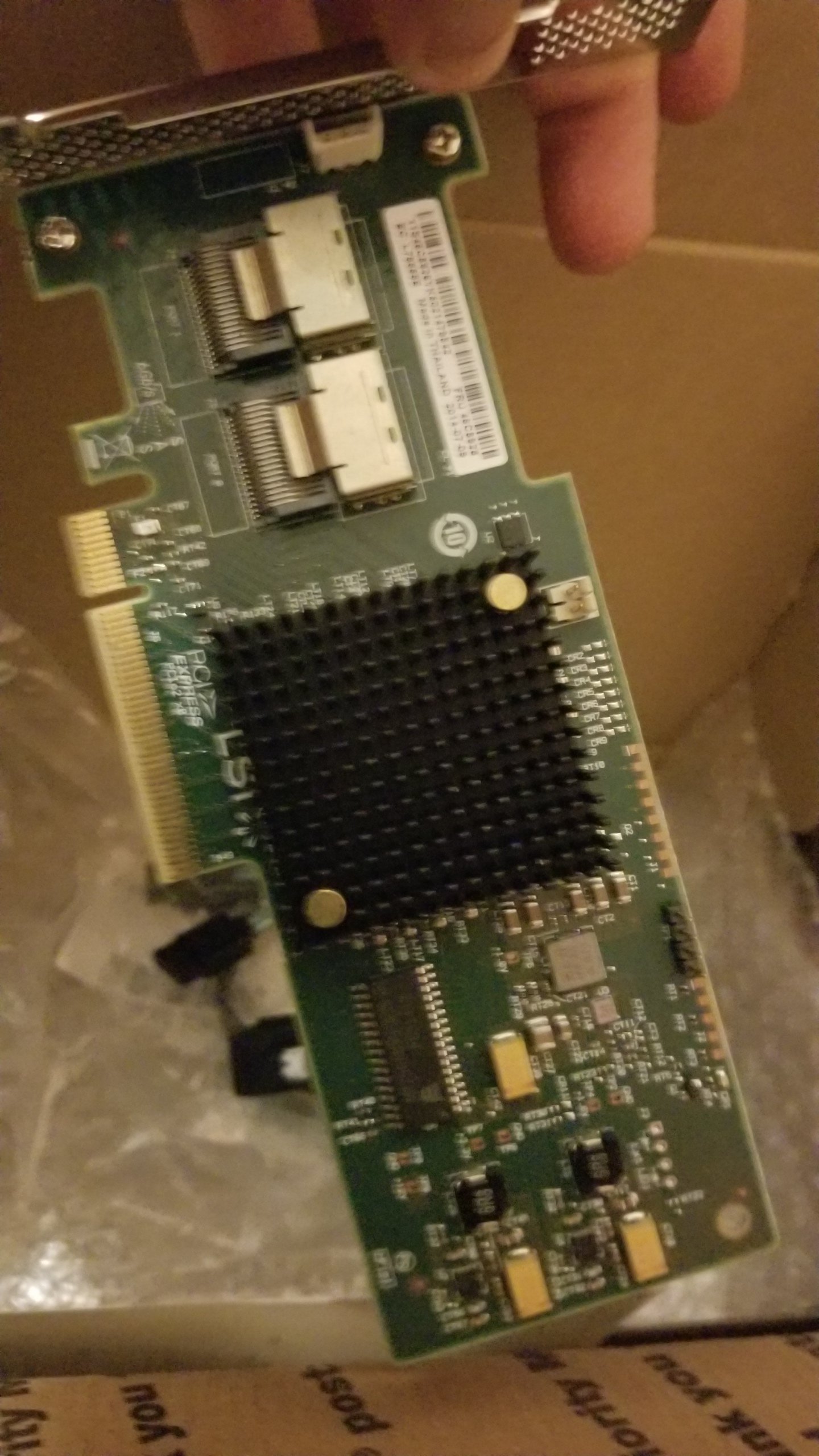

So I've finally decided to plop the money down on a better system then using the external hard drives and did as you guys suggested and bought a HBA non raid card for my dell r710, I even went further and purchased a NetApp DS4246 Disk Array Shelf, a LSI SAS 9200-8e-HP 8-Port, 6Gb/s DUAL PORT SAS+SATA to PCI Express HBA card and a 40G QSFP+ SFF-8436 to SFF-8088 Mini SAS Cable DDR For NetApp DS4243 DS4246 1~5 M cable to connect them all together only to open my server and find out that the raid card I have doesn't connect to my backplane, after all the reading I've been doing this would mean I need a reverse breakout cable and cards correct? I've hit so many roadblocks and made so many mistakes building this server I could really use a hand with this finale part, if any one could help or suggest the best card for this make up Id be eternally grateful, spending so much money and nothing to show for it but stress and at times less of a understanding then when I started is tough to deal with.
