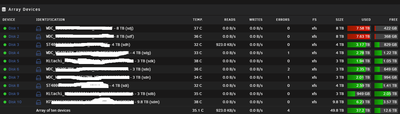

Looks like I have a few disk errors
Suggestions?
The drives with read errors are on separate sas cables and different power segments, so I am thinking it is a mix of old drives and funkyness from my old controller.
