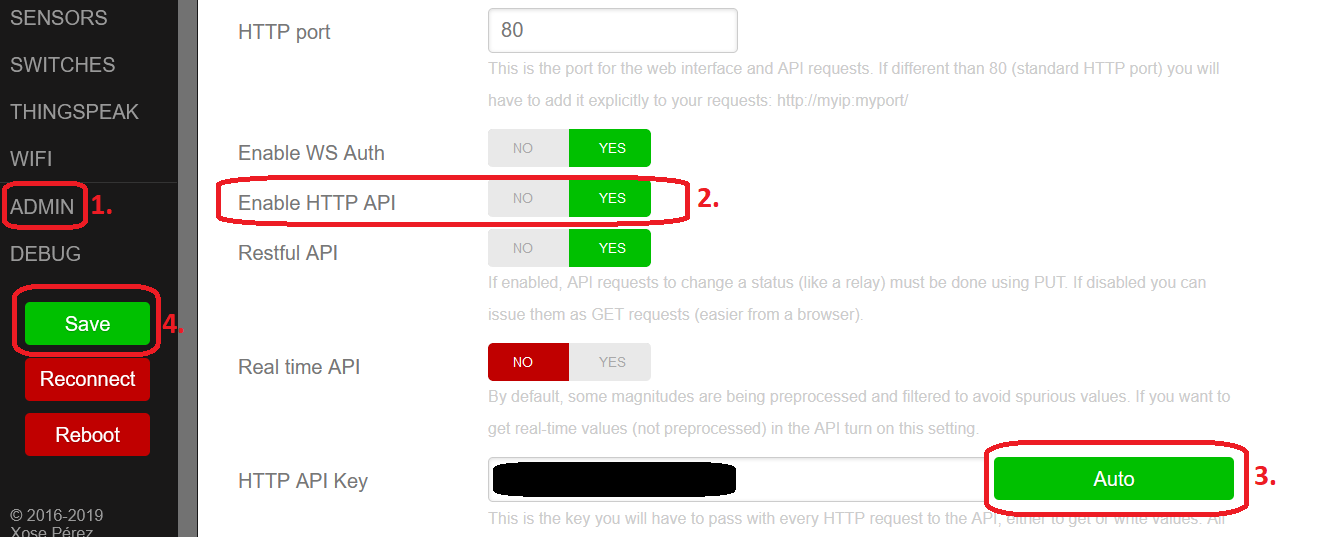

You have to activate the API on your ESPurna device and enter the key in the plugin.
To enable the API from your ESPurna device go to the WebUI and click on:
1. Admin
2. Enable HTTP API
3. Auto
4. Save

@Flippo eventually you can add this to your first post:
  1. Admin
  2. Enable HTTP API
  3. Auto
  4. Save
