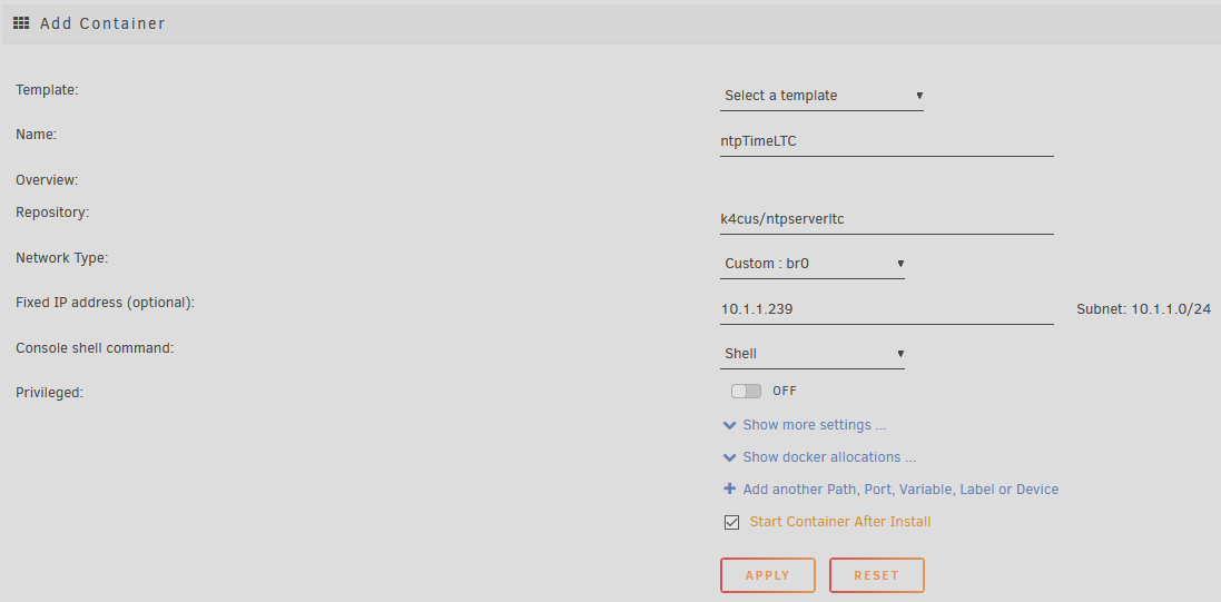

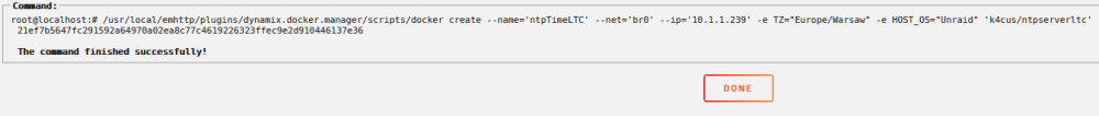

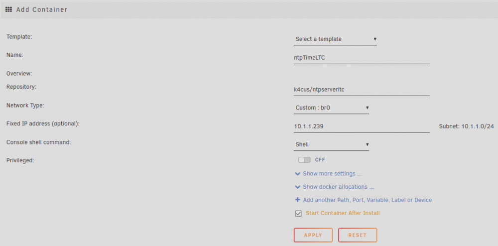

April 10, 20215 yr Hi guys, I want to announce my simple ntp server, that can provide docker host localtime over ntp protocol. What does it do? This simple NTP server delivers time over ntp protocol to dummy devices like ip cameras, cheap routers that cannot handle time zone changes and day light saving correctly. With this container You can set your dummy device to use UTC time with no daylight saving and then point it to sychronize time ovet ntp protocol. This container will handle timezone correctly and deliver local time LTC to dummy device instead of UTC time (like regular ntp server does). Install under unraid. Go to docker tab in your unraid panel. At the bottom click add container. Then configure like at the image bellow. Replace ip with your own network ip address. Make sure selected ip is not taken by other device. After successful you will see: Point your dummy device to sync time over ntp. This server localtime can be different, than docker host. Local time zone is provided by TZ variable. Link to dockerhub: https://hub.docker.com/repository/docker/k4cus/ntpserverltc This is my first docker, so maybe It is not very clean implementation. Edited April 10, 20215 yr by Kacper
