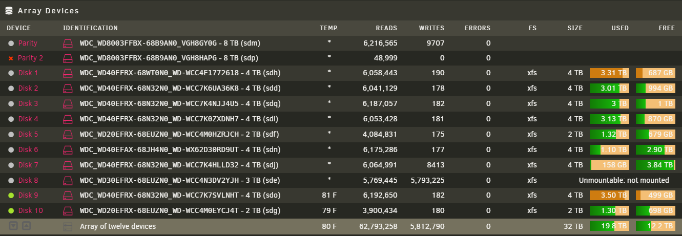

After a reboot & starting the array, I had an issue with a drive showing a few read errors. Thinking this wasn't right, I noticed that a parity drive also showed errors.
Both of these drives are were plugged into the same LSI card. This gave me a clue.
I replaced said card, after double-checking all my cables were good, and started the array in maintenance mode.
I was able to rebuild the contents of the erroring drive, but after starting the array normally, I have two disks that are "unmountable: not mounted" on the main screen.

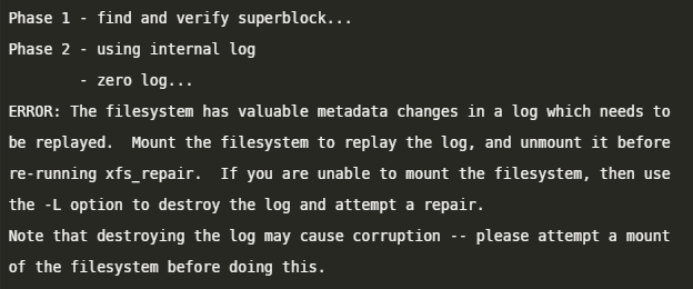

Yes. Don't forget to run them without the -n option. Both file systems are damaged, which is why they are not mountable.
If it says you need to run the check again with the -L option, then do so.
In progress...
Disk 7:
Disk 8:
How should I address each?
Use -L for disk7, disk8 on the other hand appears unfixable, likely there were read errors on a different disk during the rebuild.

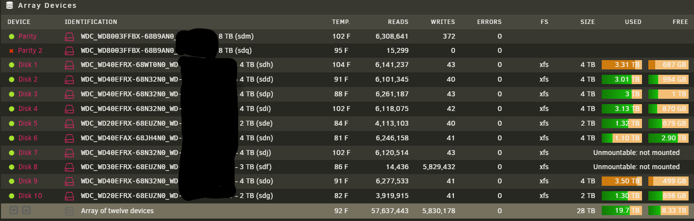

Thanks @JorgeB. Disk7 back in action.
What should I do about disk8.
I attempted to remove it from the array, and rebuild it's contents again, and that "succeeded" but the disk is still unmountable.
Since I have dual parity and one of those is also disabled, should I attempt the rebuild of that one first and then again for disk8?
I'm just at a loss (and I feel possibly data loss) as to what my next steps should be.

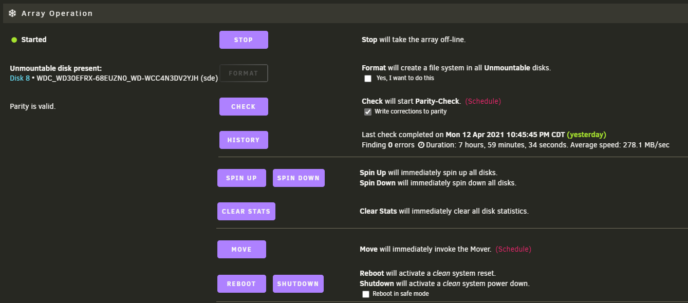

Assuming I have backups of the data and can accept the loss of data from this disk, how do I get disk8 back to a working filesystem and available to take data again?
Post a screenshot of Main - Array Operation
No, that is a screenshot of Main - Array Devices.
I promise I can read.
...and I guess the answer is right there in front of me.
yes it is
