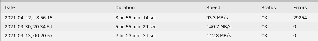

I'm a new Unraid user (just bought the Plus version a couple of weeks ago). A few minutes ago a scheduled Parity Check just completed.
Turns out there were 29254 sync errors it automatically corrected.
The previous two parity checks were without any error and I didn't change anything (the PC done on March 30th was after I added a 2TB disk and showed zero errors).

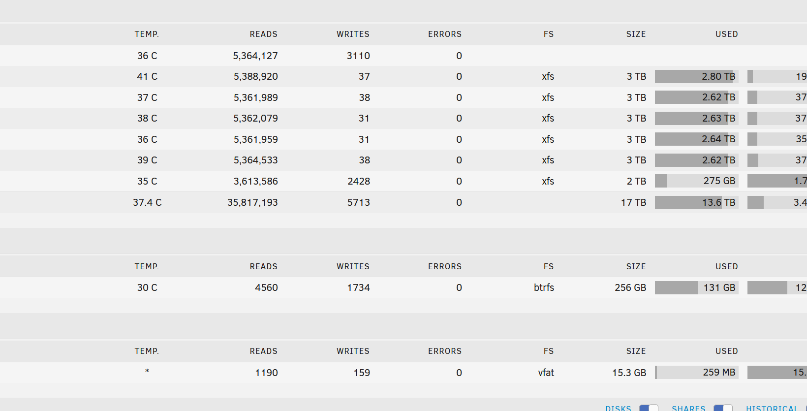

There are no discernible errors in the disks:
And they all show up as Healthy in the SMART checks.

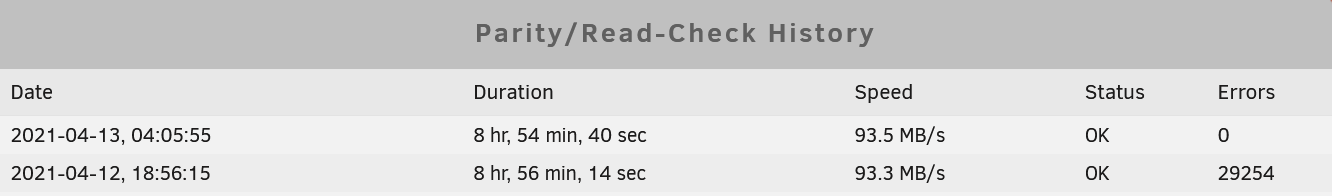

Without rebooting run a non correcting check, if more errors are found post new diags and there's a problem for sure, if not most likely the result of an unclean shutdown since last check.
Thanks. I'll start the parity check without correcting checks and I'll report back (probably tomorrow since it will take 8 hours).

p.s. 25% parity check, 0 errors for now.
Reporting as promised; the parity check was completed with 0 errors.
So can I stop worrying, was it due to unclean shutdown and I should double check the Sleep plugin? Maybe I really do need to manually stop the docker containers with some script?
Thanks!
