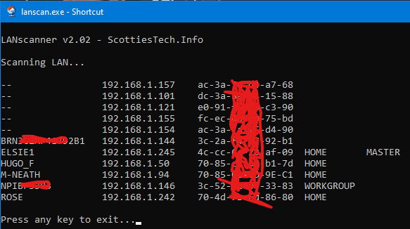

This is what the scan of my Network looks like:
The Column after the MAC addresses is the workgroup (HOME in this case.  The one on WORKGROUP is a printer but it is working so I haven't screwed around to reassign it!) to which each computer has been assigned.  And, obviously,  the server Elsie1 is the Local Master for my SMB network.
