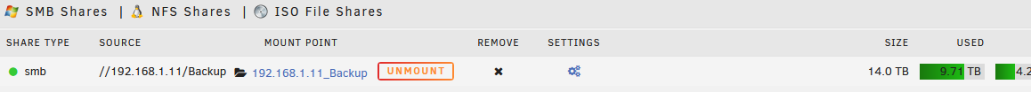

Yes it's definitely the flash that is filling up
I have a have a SMB share to another Unraid server, but I can't remember why I set this up

Since you aren't using that SMB mount you should unmount it and set it to NOT automount. That will stop the log from filling and prevent the 192.168.1.11_Backup.sh from running. I have a feeling that script is logging failures on the flash drive which is causing flash backup to activate regularly. Actually, I would completely delete the SMB mapping if you don't plan to use it.
Then go to Settings -> Management Access -> Unraid.net and choose to Deactivate your Flash Backup. This will basically delete the .git folder and then you can see how much space remains on the flash. If things don't work at all because the flash is full, you can shutdown, put the flash drive in another pc, and delete the .git folder from there.
That appears to have done the trick, I think the fact that files were kept being written to the .get folder + the flash drive is only 2GB caused the problem.
