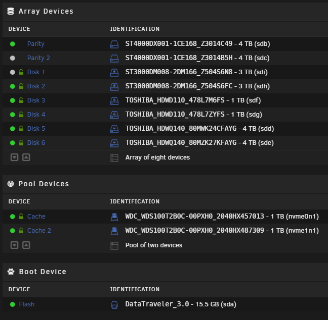

My Array Configuration:

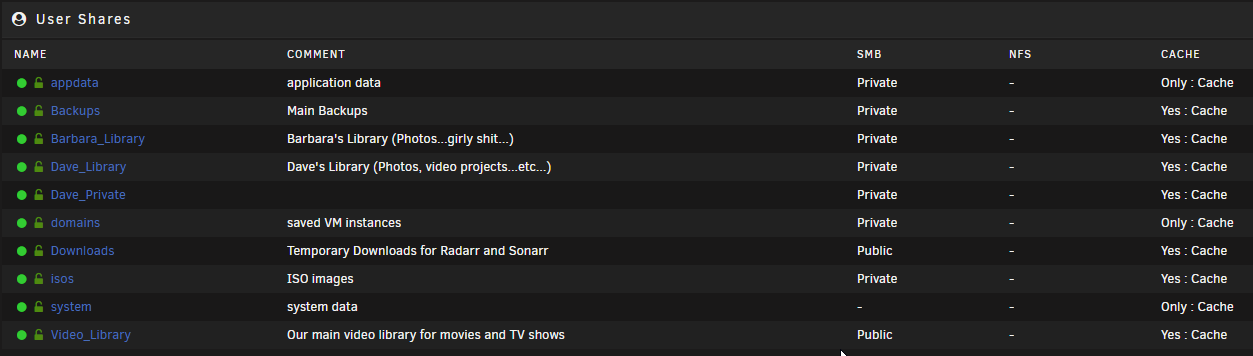

Share Settings:

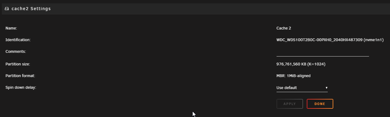

  • Reformating cache pool to 1MiB partition layout as described by limetech HERE.

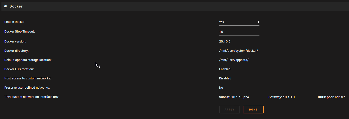

  • Switching Docker to use a directory instead of an image.
  • Moved Docker back to a fresh btrfs image after the above didn't work.
  • Tried toggling various dockers/vms on and off to find a culprit, no joy.
After upgrading to 6.9.2 on 18/04 I've:
  • Moved docker back to using a directory instead of an image again.

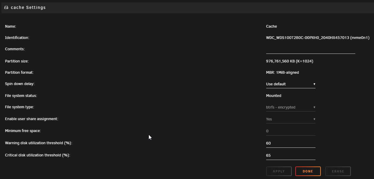

Cache Settings showing alignment:
Current Docker Settings:

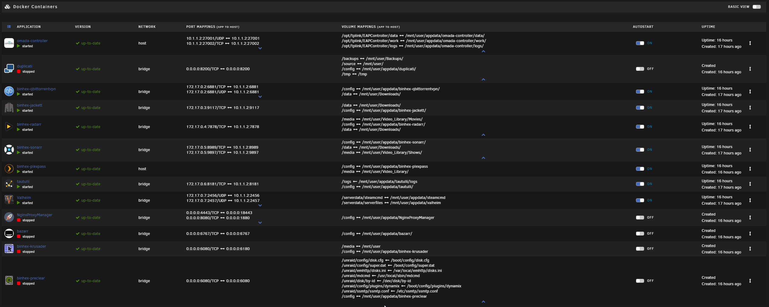

Currently Running Dockers and their mappings:

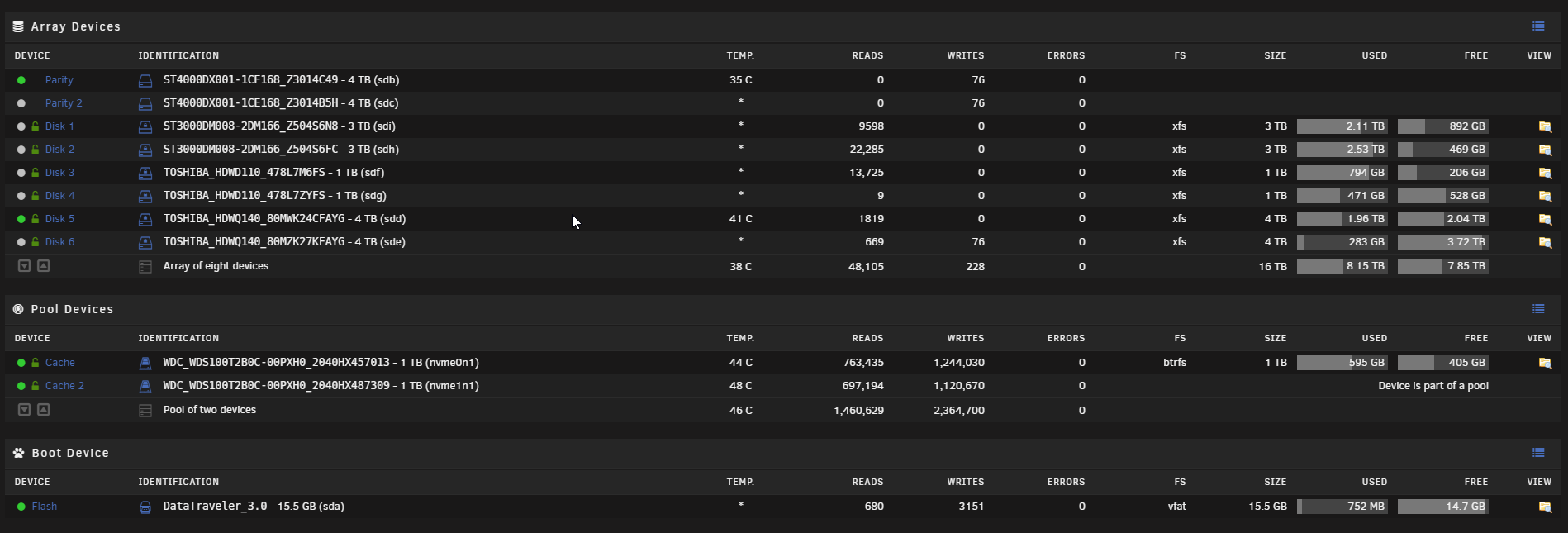

Screenshot of Main 14hrs after a stats resest (after moving docker back to directory mode from img):
As you can see from the above screenshots, the writes are excessive. This is despite the cache re-alignment, move back to using docker in directory mode and the disabling of the only docker that should be doing large writes because of how I have it set up (duplicati).

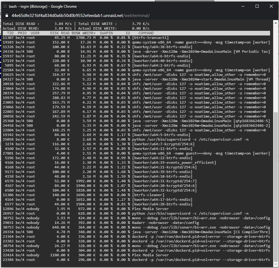

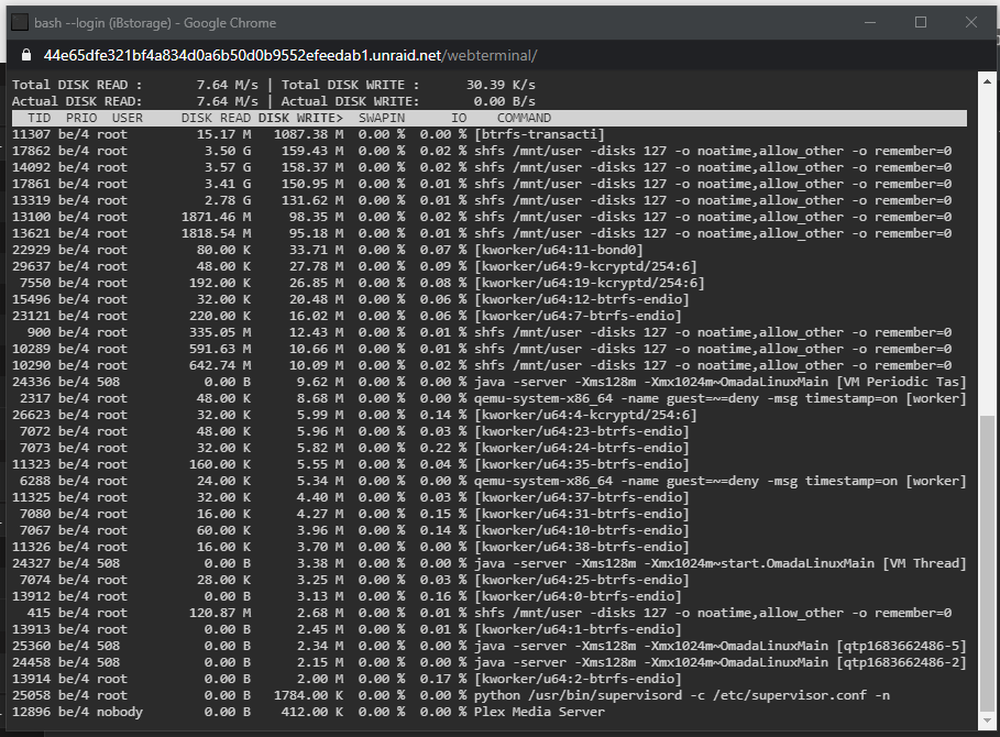

I've run another iotop -ao for the last 3hours before writing this post (without changing anything else) to give some sort of idea of what that overnight output would look like if I had it:
I should also mention that yesterday I ran each docker 1 by 1 (with all others disabled) and ran iotop -ao for 10 minutes each but the results were inconclusive.

Updated with share settings
That's from 3 Hours? It shows a total of less than 2GiB. That's very little, something else must be doing most of the writing.
That's what I've been thinking...but not sure how to narrow it down further, or possibly go beyound whatever bounds iotop has.

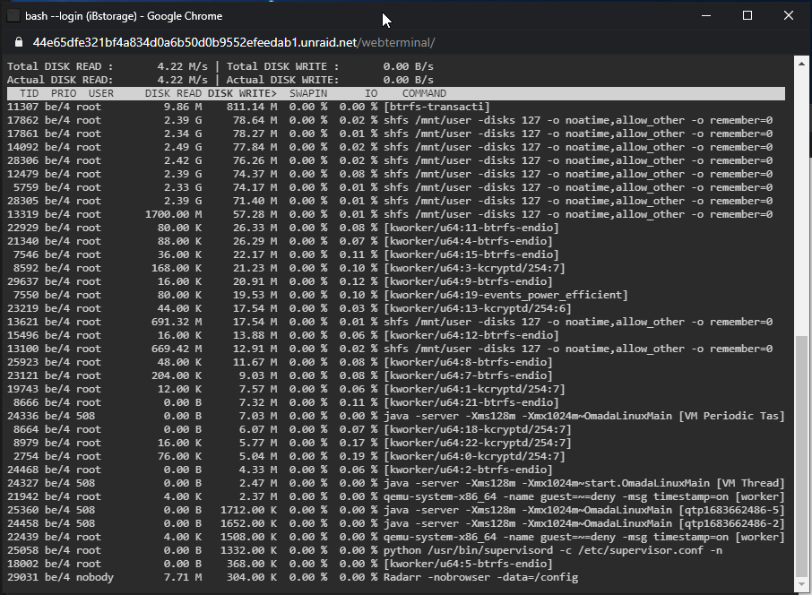

Here is an SS from 4 hours, not much difference.
Edited by DaveDoesStuff
Any continuous writes should be in there, at least they were for all users with that issue, including myself, do you do any downloading/unpacking to the cache pool?

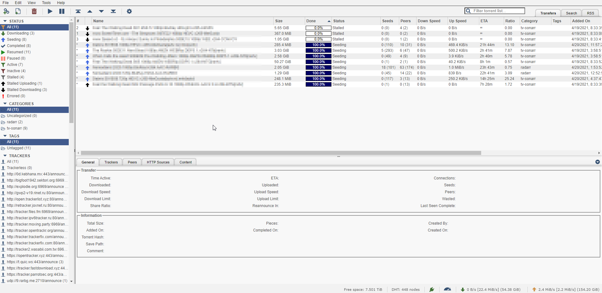

Nothing beyond the standard Radarr/Sonarr > Qbtorrent > Plex setup used by many. Here is a screenshot of QB at present along with a fresh iotop, the QB screenshot effectively represents my last 72 hours of torrenting. As you can see, not a ton. From what I've seen on the forums here I'd say it's a standard amount even.
EDIT: I've just noticed that iotop, despite being the same window running for the last 6 hours seems to be giving inconsistant stats...haven't used it outside of troubleshooting this issue so not sure if thats normal. For example in the screenshot in this post taken at roughly 6hrs run time, compared to the previous 4hrs one the entries at the top for highest write are missing.
No, but much more than the continuous writes reported by iotop would generate, check SSDs TBW then let it run for 24H without any downloading, then check again.

Thats a delta of roughly 35,000 on each drive. No this does not seem like a lot...but unRAID main reporting 3.9 million when it was around 2.6 million yesterday evening is still pretty bad so a server that was essentially only running a handful of low IO dockers and a pfSense VM.
The number of writes in the GUI is basically meaningless, it varies with the devices, what matters are the TBW, and that is fine, only a few GB were written.
Hmm, didn't know that. To be fair it would be counter-intuitive for me to assume it's a load of crap lol but thank you for the info.
