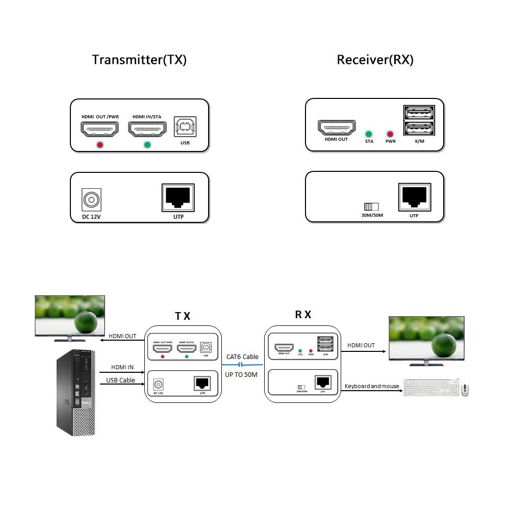

I have my server in the basement about 100 ft. away from my office and I've been using a 4kex70-h2 and a u2ex50 for a few years now for a Win10 VM.  I use 2 cat5e cables terminated to keystone jacks in my office and a patch panel in the basement.  Then use regular patch cables to connect the transmitters and receivers.  I have the 4kex70-h2 transmitter connected via 6 ft. HDMI cable to a 3060 (recent upgraded from a 1050) with a resolution of 3440x1440 @60Hz.  The receiving unit does get quite hot, as many of the reviewers have noted.  I plan to run a new cat6 or cat7 cable soon for the 4kex70-h2 since I occasionally lose the signal which I attribute to the length of the run on cat5e.
If your run is shorter, you can save some $$ with the 4kex60-h2.
