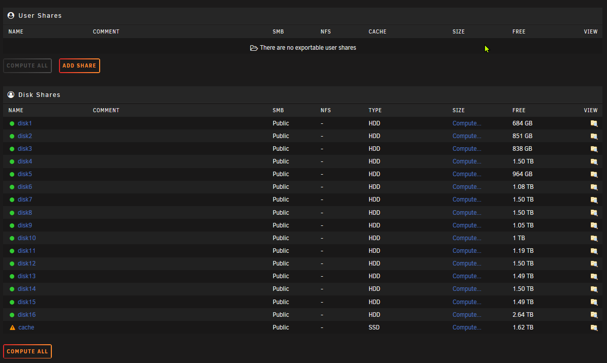

I've tried to update my 6.83 to 6.92 several times and every time my shares were not visible anymore, while they were still available on the disks. So I decided to start from scratch, installed 6.92 on the USB drive, and booted with it.
After the usual config stuff (network, passwords, assigning the drives back to their slots,...) I wanted to create a new share and it failed again!

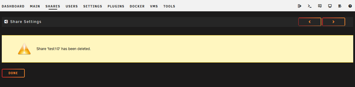

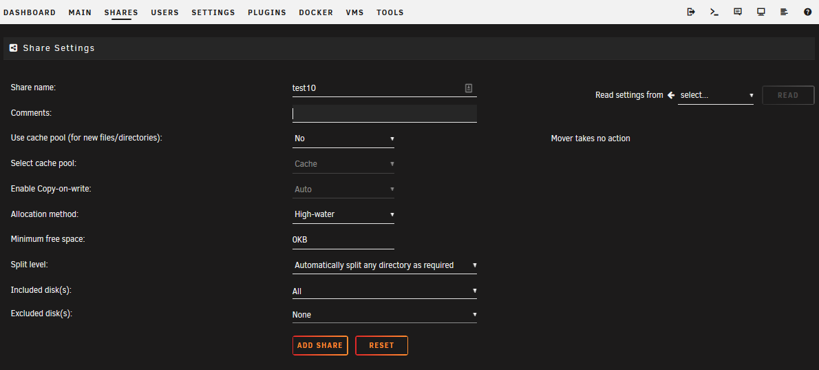

When I call the share "test10", I receive a message
"Share 'test10' has been deleted."
But the directory is created as /mnt/user/test10 and the Share does not show up in the Shares screen
When I try to create a share, that already exist from the previous installation, I do not get the message "Sahre has been deleted".
The directory in /mnt/user remains unchanged and the Share does not show up in the Shares screen.

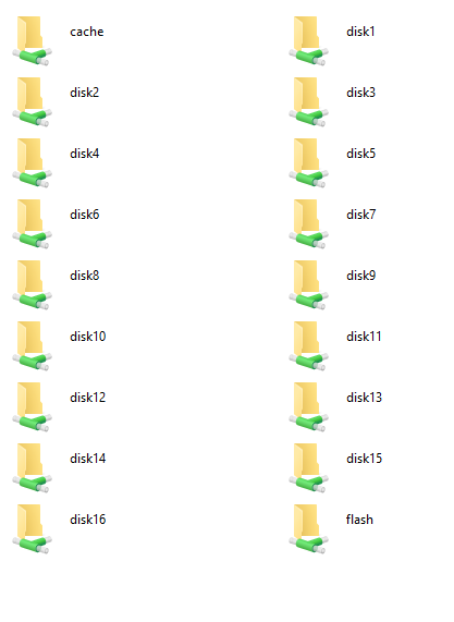

All disks, flash and cache shares are visible in Windows File Explorer.

Almost certainly a browser issue as suggested. Your diagnostics show you have 3 user shares.

Unfortunately it's not a browser issue. I tried it with Chome and Firefox and there is no change.
The disks are only shared to show that the sharing itself works. I didn't set this up. Seems to be the default config on my server.

What can I say? Nothing changed. All data is still on the drives but nothing shows up in the User Shares screen.
When entering a new share on this screen, I get an "Share 'test41' has been deleted." message but /boot/config/shares/test41.cfg is created.
When entering a share name where the directory does already exist (i.e. /mnt/userr/Exchange), no message appears but it doesn't set up the share and create the .cfg file.
