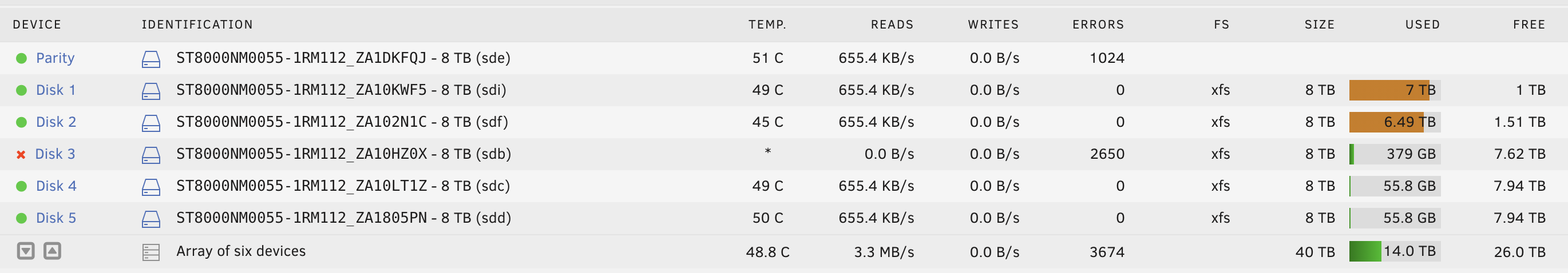

While rebuilding, I already noticed 6k errors in my Parity drive, it's only been 3 hours.  Don't know if it's still worth it to continue?  What should be my next step?
tower-diagnostics-20210510-1321.zip
Parity drive is failing, you can continue the rebuild since there's no better option but there will be some data loss.
