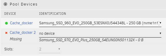

I've performed the 1st part untill the removal procedure
But then , I can do
1- stop the array
2- unassign pool disk to remove
but not
3- start the array
as the START buttong is greyed, and a "Missing Cache disk" warning is displayed
(pics attached)
thanks !
My bad ...
Everything works fine now, thank you all for your help !
