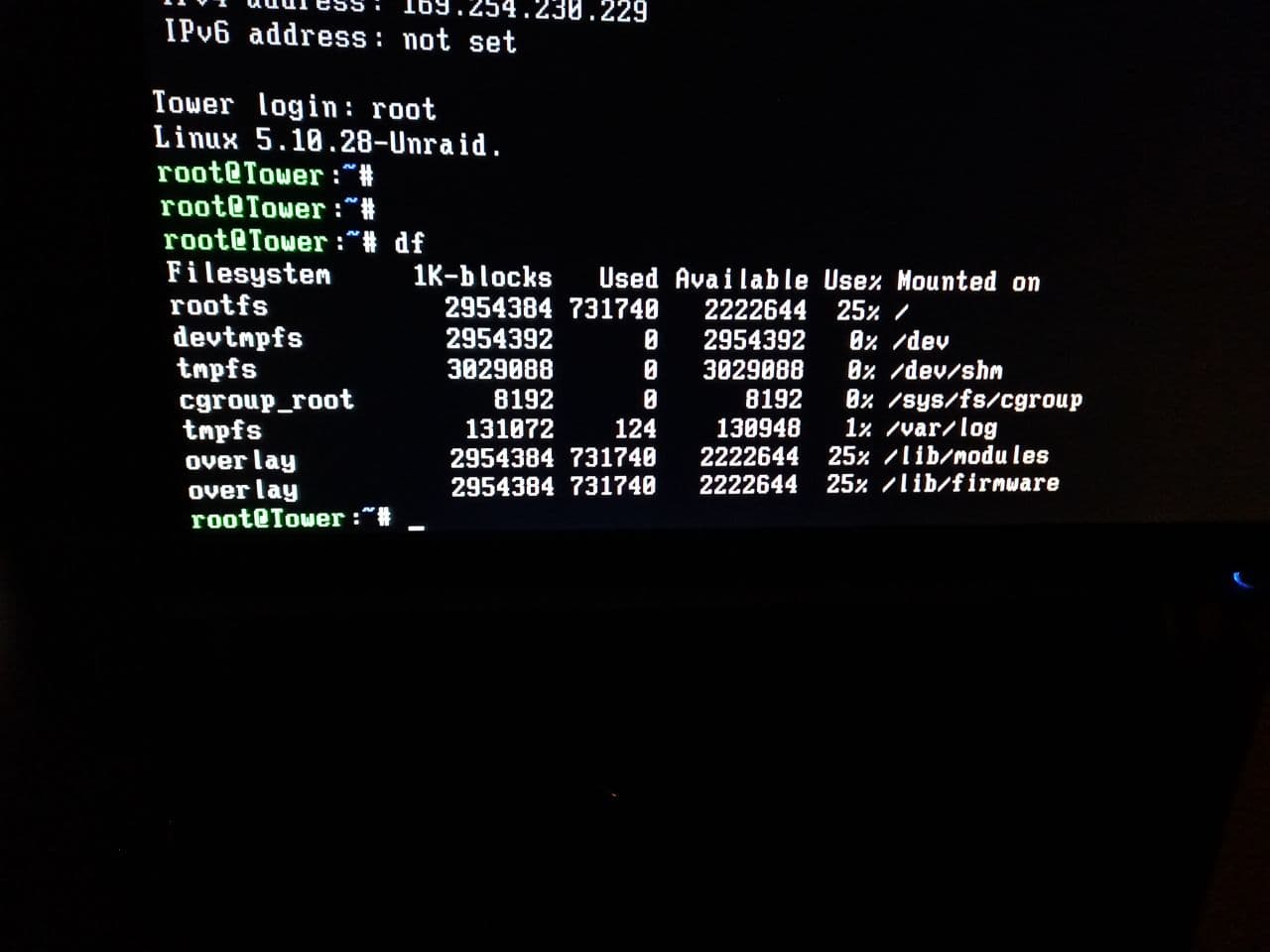

If you can get in at the console then try the ‘df’ command to check that the Unraid  flash is successfully mounting at /boot.

I don't think the flash is mounted at /boot. See attached photo. I'll try another stick, to check if that is the problem.
Yes.   If it is not mounted that explains the other symptoms.
Make sure it is FAT32 format and is labelled UNRAID (all caps).    If possible use a USB2 port and/or flash drive. USB3.x should in principle work just as well but does seem to sometimes cause problems.
