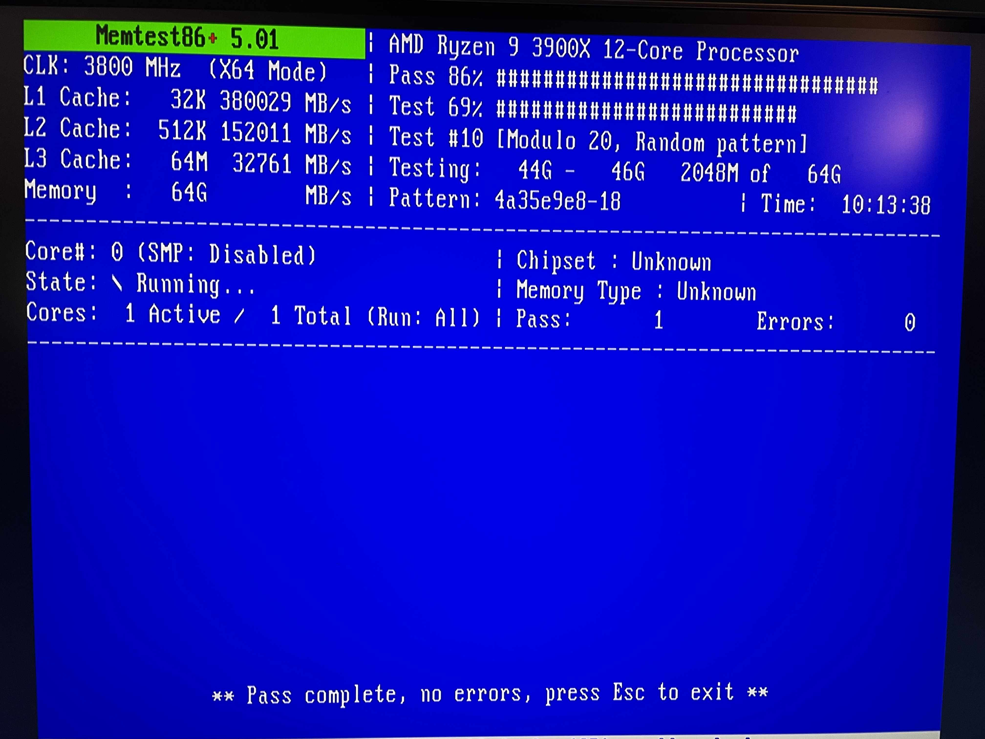

So, to address the comments of @John_M - I let MemTest run overnight and there were no errors in the morning - also the system did not reboot at all. I am now mirroring syslog to flash. I will attach a new diags bundle. Also, I have removed the modprobe i915 now - this used to be on an intel system, and that is a remnant.
