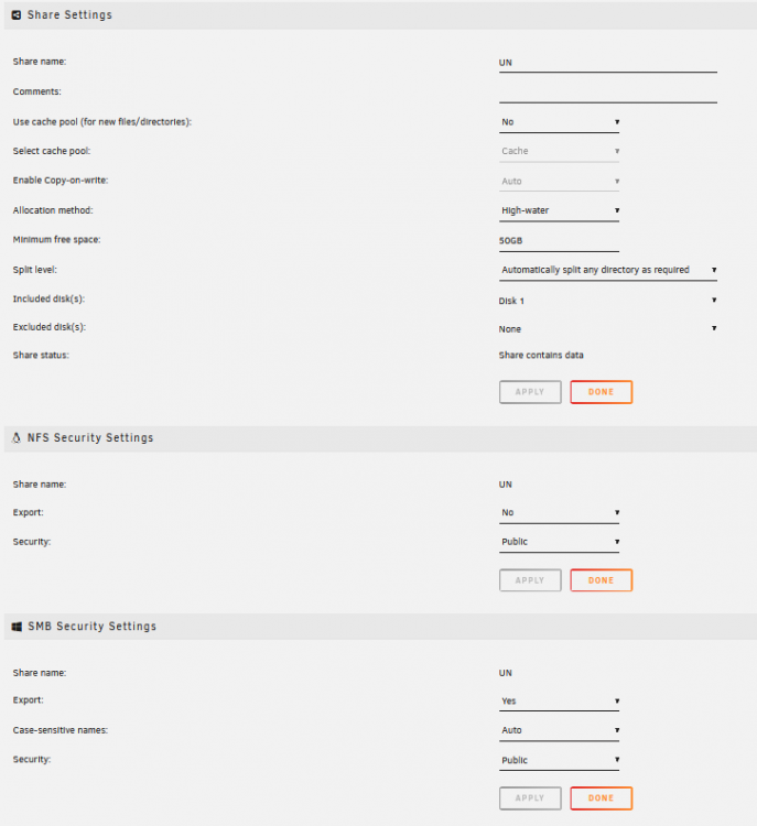

I have a share that I have my media on. Might be my misunderstanding of Unraid as I kind of assumed that the Share was part of my overall Array.

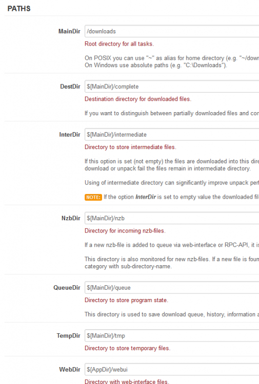

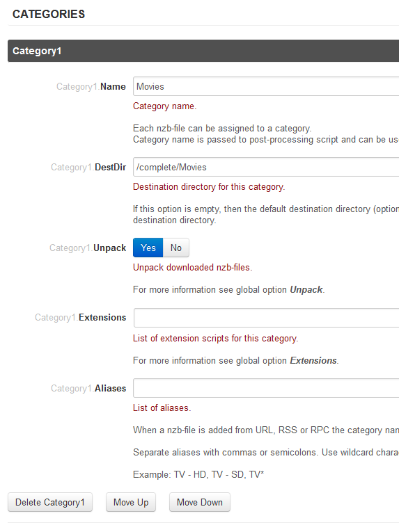

NZBGet download completes and shows a successful move of the file, but it's nowhere to be seen. Attaching images of the Share settings, as well as the NZBGet paths. This is just my latest attempt at the paths, I've tried a bunch of different options.

/complete/Movies is not a subfolder of /downloads. Since /complete isn't mapped it is inside docker.img
Okay, that's kind of what I had been seeing. What's the best way to fix this? I've tried mapping in NZBGet to just /complete, and that didn't work. I also set the main directory to be /mnt/user/UN/ and then complete to be ${MainDir}/complete and that didn't work either. Thoughts?
You seem to be trying things randomly instead of trying to understand how docker volume mapping works.
You have mapped /downloads to /mnt/user/UN. NZBGet doesn't know the host path /mnt/user/UN, it just knows the container path that has been mapped to, /downloads. So, MainDir would be /downloads, and DestDir would be a subfolder of that, ${MainDir}/complete.
As for getting different dockers to work together, these applications are telling each other where to put and look for files. They must specify a path that both understands, which means the container paths they are each using must be the same, and must map to the same host path.

Personally, I don't like downloading into a subfolder of appdata, because you need to have backups of appdata (CA Backup plugin) and no good reason to have the downloads included in that. So, a separate download share makes sense, which would be at /mnt/user/download (not /mnt/disk/download).
You seem to be thinking about some user share named UN that everything goes in, but I don't like that idea either. Different shares with different settings for different purposes. Some need to stay on fast pool, some need to be on the array or moved to the array from fast pool, and there will be other settings for each user share that are appropriate for different purposes.
