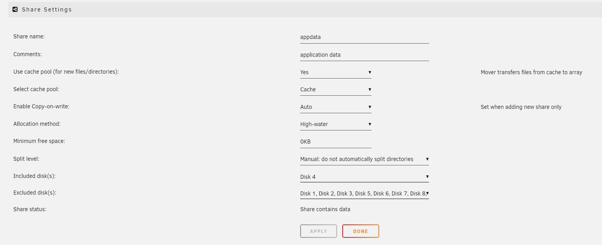

I only use Cache for Dockers / Appdata, and Transcoding for Plex, so normally all my Cache shares are Cache:Only.
I've recently upgraded to 6.9.2 and discovered I was having the excessive write issues on Cache so trying to resolve that using the "Mover Method" described here:  https://forums.unraid.net/bug-reports/prereleases/unraid-os-version-690-beta29-available-r1066/
I've changed my Cache settings to Cache:Yes
Selected Disk 4 for the location and removed Disk 4 from the exclusions
When I click "Move" the screen refreshes but nothing happens.
I looked in the log file and see the following:
  • May 5 17:32:26 TODD-Svr emhttpd: shcmd (566875): /usr/local/sbin/mover |& logger &
  • May 5 17:32:26 TODD-Svr root: mover: cache not enabled
As I dont have the share settings to allow split directories when this didnt work at first, I created the folders on Disk 4 of the same name to see if that would allow the mover to work, but no luck there.  Those folders were not there for the first attempts.
I have attached my diagnostics file, and a screenshot of my cache drive settings.
Any advice on how to resolve the mover issue is appreciated.  Thanks All in advance.
Alternatively, If i use the binhex-krusader docker to copy the full contents of the cache drive, would that work?  Are there some hidden files/folders that don't get picked up in a copy that the mover gets?

There's a line missing from a config file, and for the life of me I can't find where to set it in the GUI, so as a workaround
On the flash drive edit the file /config/share.cfg (notepad will work fine to do this)
Add this line to it at the bottom
shareCacheEnabled="yes"
Save and reboot.

From 6.9 onwards the global setting was deprecated due to multi-pool functionality, and is now set via each shares settings.
For each share, you can now choose the type of pool use (including none), and the pool you want to use.
Yeah, except the line HAS to be in share.cfg for mover to work.  Hence my "any change in Global Share Settings" should also fix it up.
It's probably because of v4 was the starting point for this flash device, and the setting never got enabled over the years.

Well when I changed from Cache None to Cache Yes, it still didn't enable the use of cache so the mover didnt work.
Adding the command line by hand did.
Not sure if having my cache sent to No during the upgrade and then trying to swap to Yes, meant it wouldn't create the command line.
So, as soon as the Mover is done (1/3 done now), I'll be removing and re-creating the cache pool with the 1MB aligned MBR.     This should create all the settings correctly, yes?
That line looks like it gets created if you make a change to Global Share Settings.
