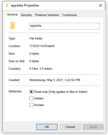

After completing the move back to cache, restoring my cache settings, and things returning to normal, there is a single string of folders with no files left in my temp "appdata" folder that was used by Mover.  Everything else went away but this single string of folders relating to one Docker is still there with no files inside.  It is 6 folders deep, including "adddata" itself.
When I go to manually delete the folder, it doesn't display any error, but it simply doesn't go away either.

I looked at the folder properties and it has a "box" in the "read only" line.  I turned that off, applied to all sub folders, but the box comes back the next time you look at properties

Is that the folder you want to remove? The one called appdata on disk4? With the Docker service stopped, at the command prompt type
rm -rf /mnt/disk4/appdata
but be careful you get it right because it's a powerful command and it doesn't ask you to confirm the action before removing the folder and anything it contains.

Perfect,
Thankyou.
