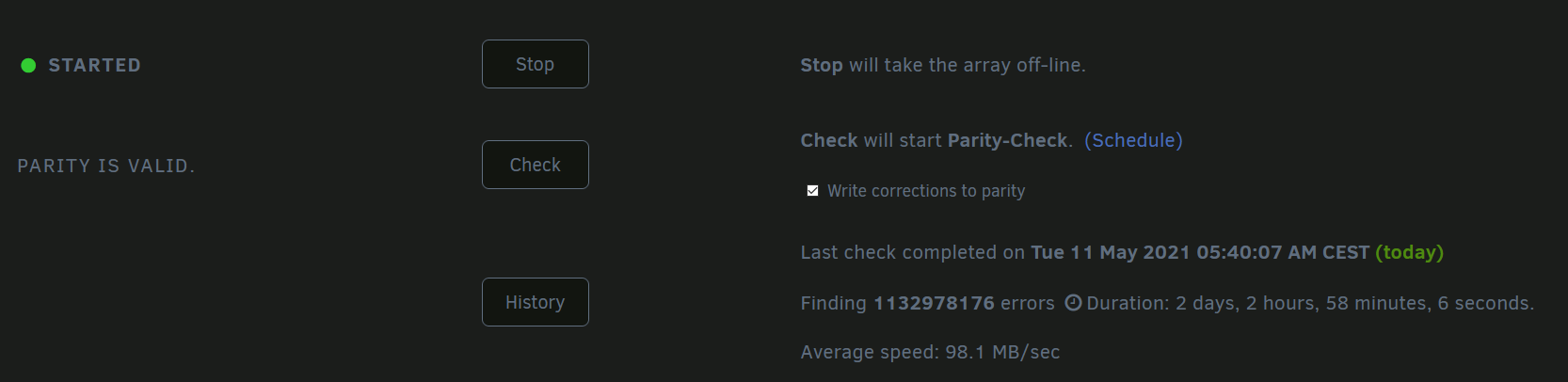

Hello.
I'm on 6.9.2. There has been an power outage, I did two parity checks after it and the same number of errors show up. Parity was full and correct before. Write corrections was enabled both times. Don't know about the first time, but during the second time I saw "Writing corrections to parity".
After the first parity check I tested all docker containers and they all started up correctly and seemed like no data loss. But I have 17.8TB of data so I can't manually check all of it. Smart data doesn't show any errors.

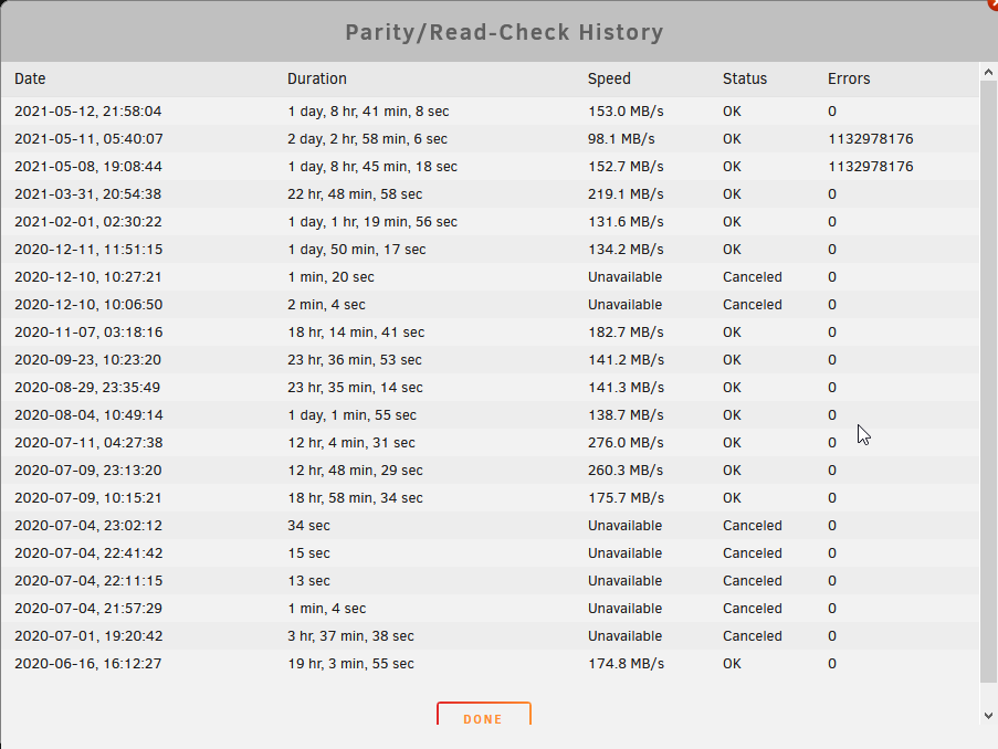

Yes, I did parity check after. Thats the one on 31.3. on the first screenshot.
It can't be, it's an impossible speed, it can only be from a rebuild (or clear) of a smaller disk than parity (it's an old bug).
The billions of errors are likely the result of the parity swap, it's another bug, and as long as next checks find 0 errors you're fine.
Why would it be impossible?  219MB/s for parity check after the parity swap?image.png.8760199cd5aae87212962d6f2be5f03b.png
Because your disks (and most if not all) can't read that fast over the entire surface, what's reported is the average speed, 153MB/s for the last check seems about right.
My parity is Seagate Exo and other are Iron Wolf Pros. So the speed didn't seem fishy to me.
It is, because all disks are much slower on the inner tracks, so while the check can start at 200MB/s+ it will finish close to 120MB/s or so, so average can't be over 200MB/s.
finished, not over 200MB/s.
