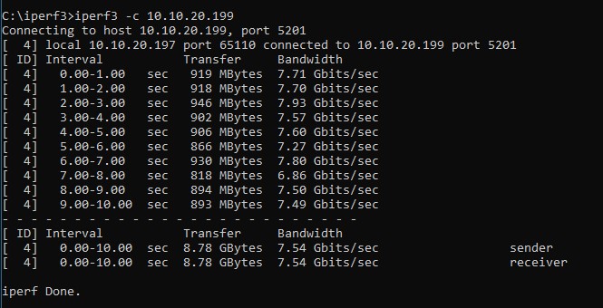

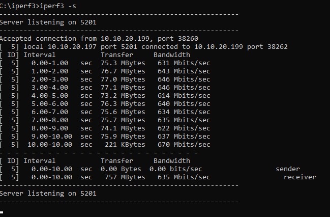

I added one to my PC and the other to Unraid and followed the Spaceinvader One video on how to set up a 10Gbe network. The cards work and I can transfer files between my PC and Unraid. However, when I write to Unraid from my PC I get on average 4.5Gbps speeds. It's not great for a 10Gbe network, but ok. When I transfer files from Unraid to my PC the speeds are on average 630 Mbps. I get around the same speed with my normal gigabit network.
I don't know what the issue could be. I did a network test with iperf and got these results.

Your iperf tests are consistent with the transfer speeds you're seeing, which indicates that the problem is with your network, not with your storage. Maybe you have a bad cable in one direction - you could try turning it round to see if the speed discrepancy is reversed. Are there any error messages logged by the driver?

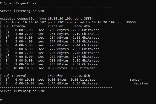

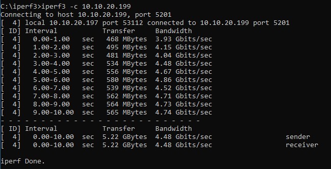

My new speeds after increasing MTU to 9000
PC to Unraid:
Unraid to PC:
