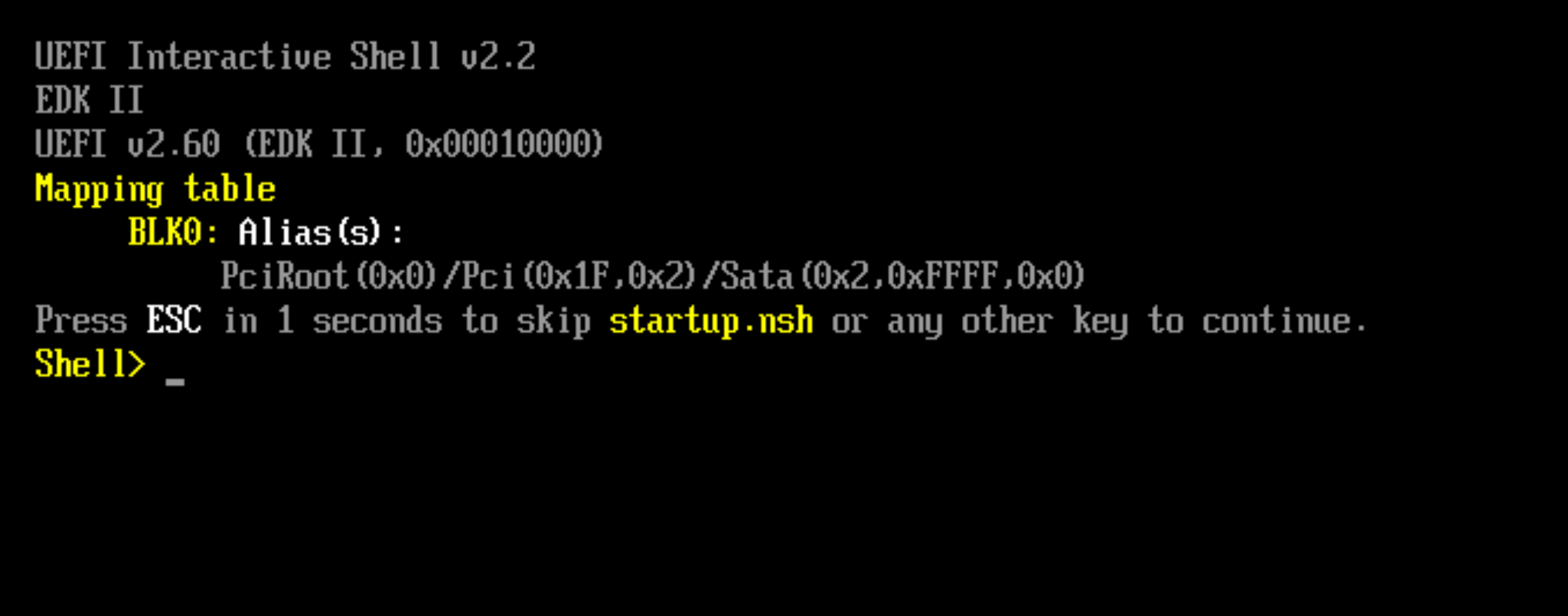

My unraid server ssems like it has some damn problems this morning: i got an email that the cache drive is neraly full (no wonder as i was downloading some movies for plex via sab overnight). I ran the mover manually and then everything seemed to went down. Nearly all docker images stopped themselves and my Home Assistant VM shutdown. After the mover finished i rebooted the whole server and all docker images are running well again. But the HA VM wont startup properly now: It shows it has started in the webui but the VNC view shows this: unraid.thumb.PNG.4ff9fb51e9fea969a30a0745c9d5c127.PNG

Try this to see if it's an issue with boot order or other.
That is the UEFI shell.
Once inside the UEFI shell type (one command per line) :
fs0:
cd EFI\BOOT
BOOTx64.efi
Report if it boots or not.
If it doesn't boot check with the ls commands that folders/files are in the fs0 EFI partition.
Edited by ghost82

Thanks for your answer!
I get the following output in the first line: 'fs0:' is not a valid mapping.
Try this command:
map fs*
1 minute ago, ghost82 said:
Try this command:
map fs*
map: Cannot find mapped device - 'fs*'
Then I suspect something serious has happened to your image file...if the vm settings are correct, especially the disk part pointing to the virtual disk, it seems the efi partition has gone..you can wait for some more comments here, but I wouldn't expect anything good :(
Edited by ghost82
Then I suspect something serious has happened to your image file...it seems the efi partition has gone..you can wait for some more comments here, but I wouldn't expect anything good :(
