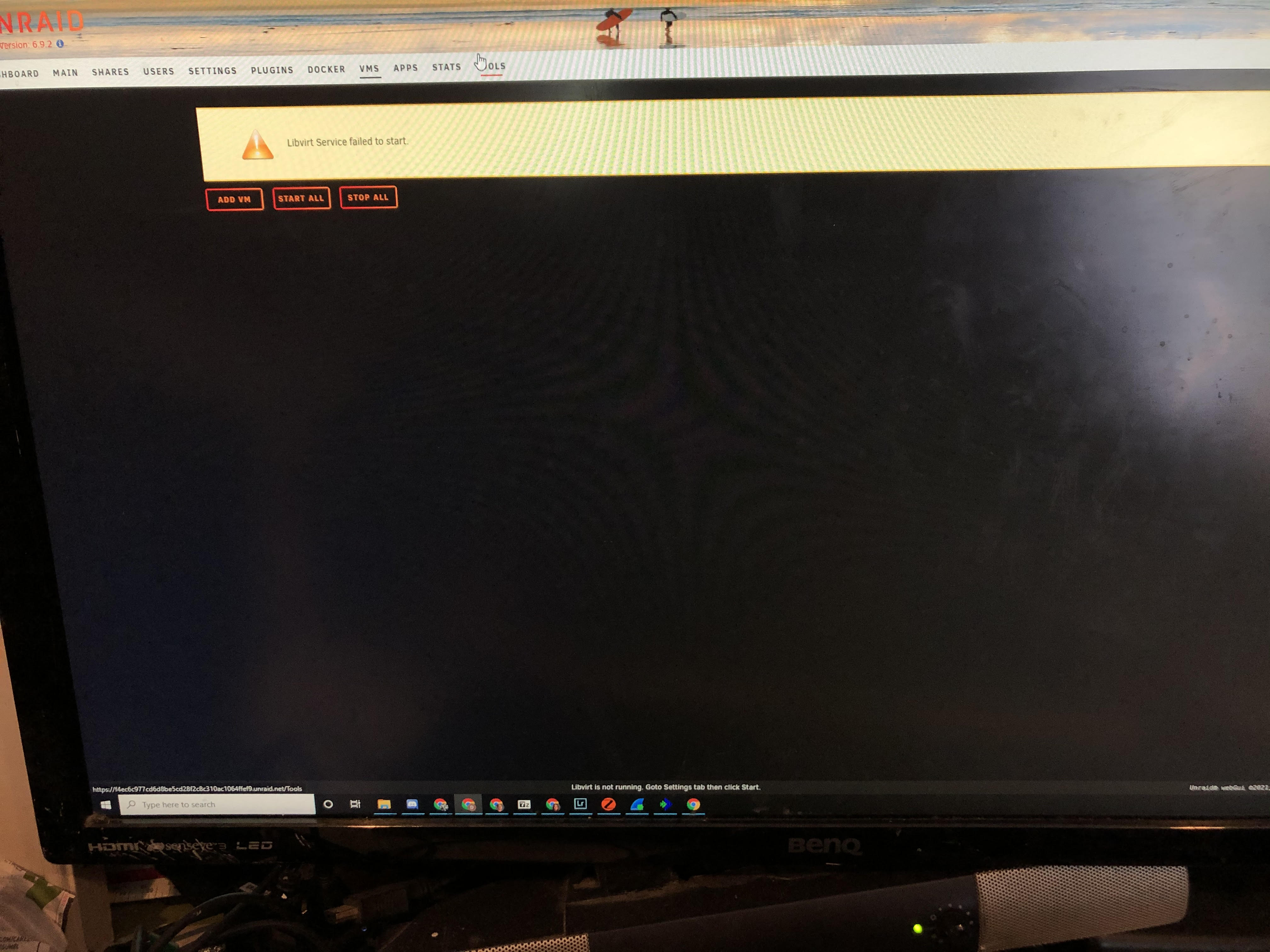

My wife went to use our kitchen pc which is a windows vm running on unraid.  The vm which was running did not wake up when she moved the mouse.  I opened a VPN connection and went to the VM tab and it said Libvirt Services failed to start.   Then while on the phone with my wife she said nevermind it came back up.  I am home now writing this post from the VM and it appears to be working fine, however the VM tab still says Libvirt Sevices failed to start.
I have attached a copy of diagnostics.  Any suggestions.  Something like this happed a couple of weeks ago (same message) and I rebooted the unraid server and everything came back fine.  Since its happened twice...should I delete the libvirt image and recreate my vm's?  I know I have backups of the xmls.
