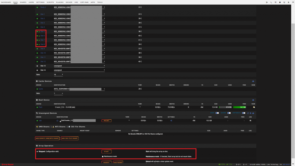

I have 4 encrypted XFS drives in array but Unraid does not request the password to start the array.
Here is what I did :
  1. My current array was populated with unencrypted hard drives only and I wanted to add 4 new hard drives
  2. Since I wanted to take this opportunity to encrypt my array, I stopped the array and changed the Disk Settings > Default file system setting to "XFS - encrypted" before adding the 4 new hard drives.
  3. I assigned the 4 new hard drives to 4 slots in my array, entered a password (twice) and started the array successfully
  4. I initiated the formatting of the 4 new hard drives (clicked the "format" button and confirmed my intention to format when prompted), and the formatting completed successfully.
  5. I stopped the array
Now I can start back the array without entering any password (see attached screenshot), which I do not want obviously.
Why is that ?
Many thanks in advance.
