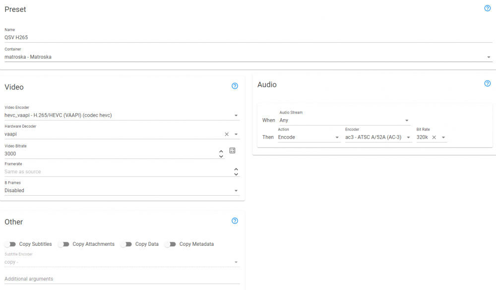

Hi Ofark
I believe all my mapping is good. the path the error is referring to is my output directory. i can ssh into the container and change directories to /storage/Downloads/Complete and after trying to run it creates the tv show name and season subfolders shown in the error ( /Dan Brown's The Lost Symbol/Season 01/ ), just not the mkv file. if i switch my ffmpeg settings to use libx265 instead of QSV and change nothing else everything works great. i only get this error when im trying to use QSV.

Right, The error message you have there System.IO.FileNotFoundException will (probably) be from the post processing work, checking the file for size, AFTER FFmpeg has done it's thing. Meaning, there must be another error, from FFmpeg further up the log.
here is the log file. i do see a couple of errors in it

Ok, not sure about this, but can you try:
After the "-hwaccel_device /dev/dri/renderD128" in the Additional Parameters adding a space and then :
-vf "hwupload_cuda"
I'm basing this off of a StackOverflow issue from the problem in the log:
Impossible to convert between the formats supported by the filter 'Parsed_null_0' and the filter 'auto_scaler_0'
It seems like you need to tell FFmpeg what to do with QSV, which is why I haven't managed to implement a one button for this yet.
unfortunately that didnt work. i get an error that says No such filter: 'hwupload_cuda'
Are you using Hardware Decoding? Which is one of the first options, if so can you see if you get the same issue with it switched off?
