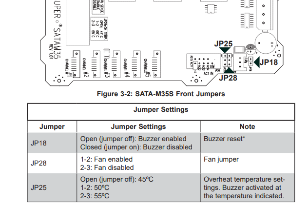

17 minutes ago, Helmonder said:
but wuite positive this is the issue !
Quite likely alert because missing FAN, you can keep connect the FAN to mobo for further control the cage FAN ( I also do that on my Icydock cage ), then set below jumper.
Edited by Vr2Io
