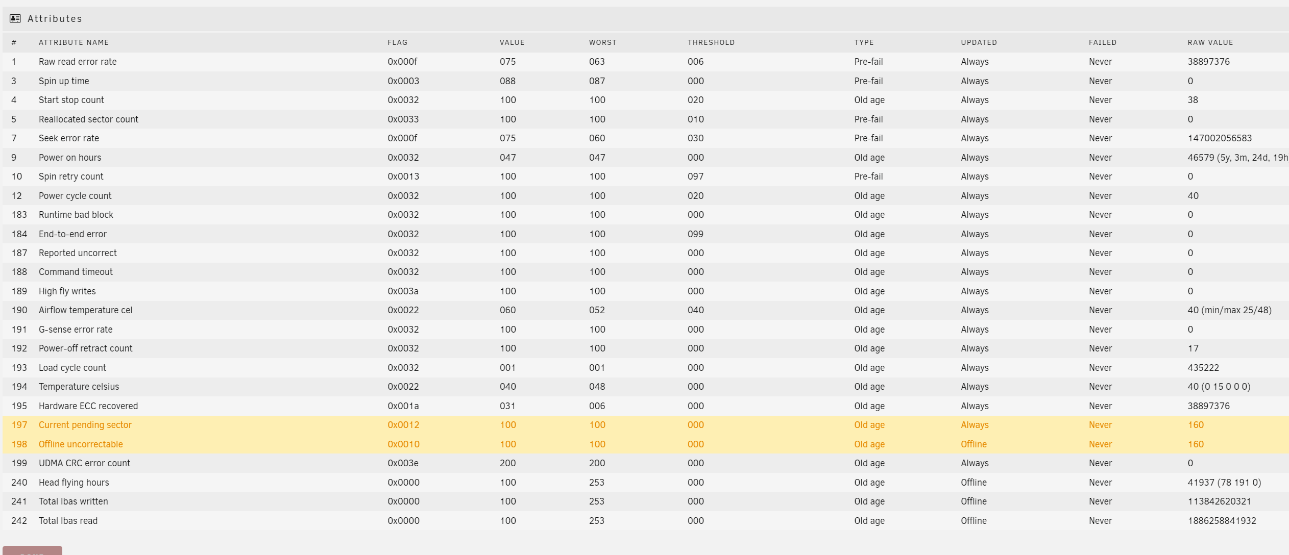

I've had the following occur -
197 Current pending sector   0x0012   100  100  000  old age always never 152
198 Offline uncorrectable      0x0010   100  100  000  old age  offline never  152
Its not long happened after a full parity check which found 17,496 errors - I'm guessing this is far from normal.

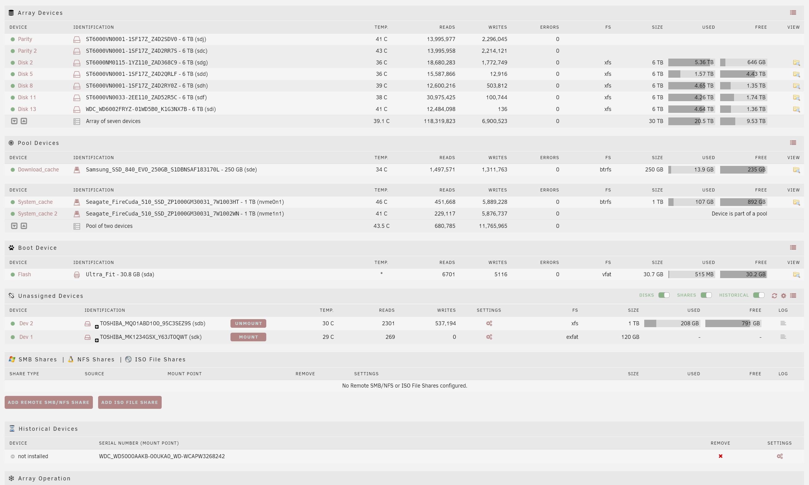

You don't actually need a 16 TB disk and they don't represent good value for money right now (in terms of cost per terabyte). You only need a 6 TB parity disk at the moment to work in your array but the sweet spot (cost per terabyte) is in the 8 to 10 TB range, so that's what I'd be considering in your position. You can always re-purpose it as a data disk when larger capacities become worth buying again. Another thing to think about is whether, with only five data disks, you actually need two parity disks at the moment. Having two parity disks is "better" in that it provides extra redundancy but that's more of a convenience than a necessity, if you have adequate backups. Remember, parity is never a substitute for backups.
It is possible to get ‘false positives’ for Pending Sectors which correct themselves the next time the sector is written.   However with that many there is quite likely to be a genuine problem.

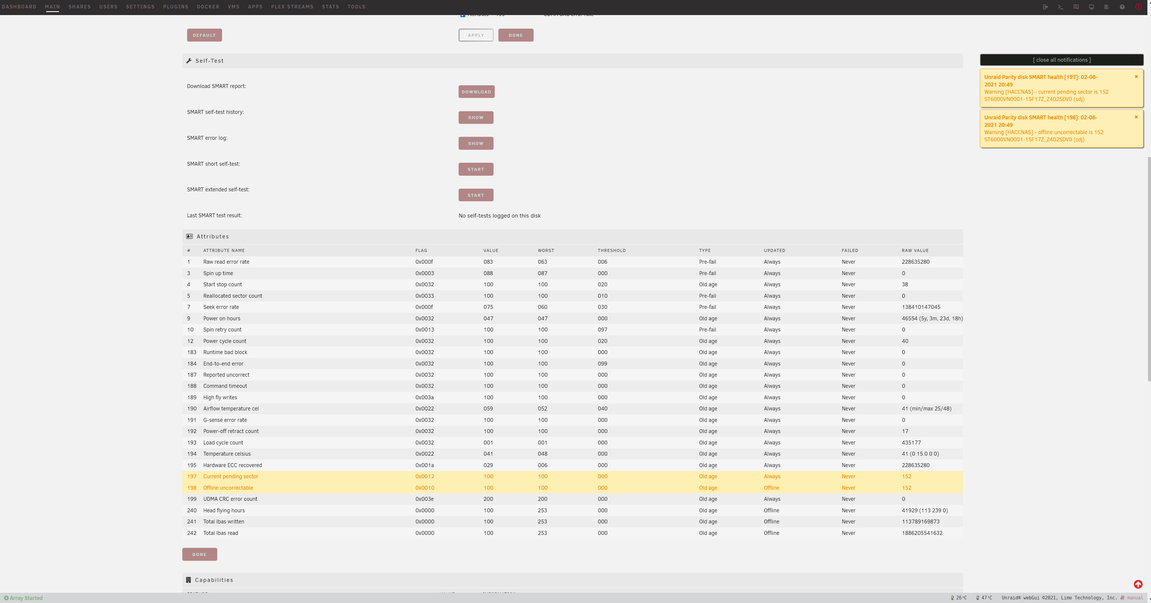

it is probably worth running an extended SMART test on the drive.   The results of that will give more information on the health of the drive..
Extended test about to be started, great thinking!
Weirdly had the same error at 160
Smart Report of Extended Test added. TBH i have no idea what I'm looking for - nothing jumps out in surprise!
ST6000VN0001-1SF17Z_Z4D2SDV0-20210603-2236.txt
Edited by SmokeyColes
SMART test failed, disk should be replaced.
