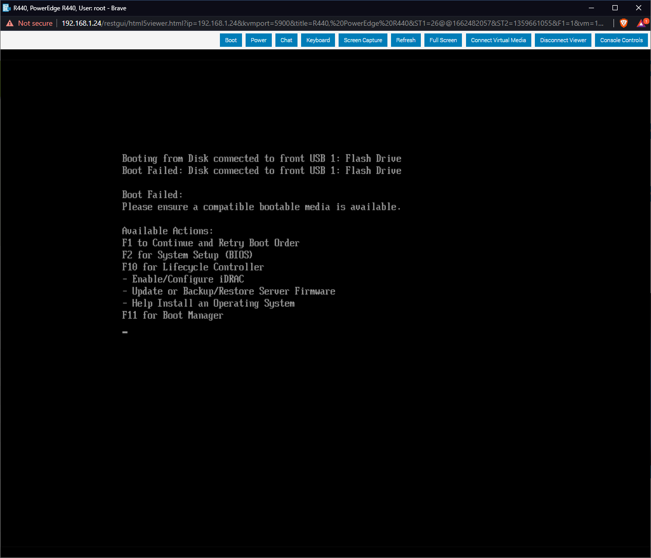

I've been spending probably the last few days trying to get my R440 to boot into the Unraid installer.
So far this is what I've tried:
Used both the tool and did the manual method to create a USB stick.
Testing the USB on another machine - it boots into the installer.
Trying every USB port on the R440.
Trying two other USB flashdrives from different vendors.
Confirmed that I can boot into another OS. I was able to boot into Windows Sever 2016, Ubuntu Server 20.01.2, and ESXi.
I've played with multiple BIOS settings in attempt to get it to boot.
I'm hoping someone that has installed on an R440 can point me in the right direction.
Thanks!
Edited by Nomaran
Solved
What do you see when you try to boot?
Boot failed:
Please ensure a compatible bootable media is available.

Alright I followed those steps on three different USB drives, I'm getting the same error.
Edited by Nomaran
I got it!
I updated the BIOS for the R440 and now I'm able to boot into the installer.
Thanks trurl for the assist!
