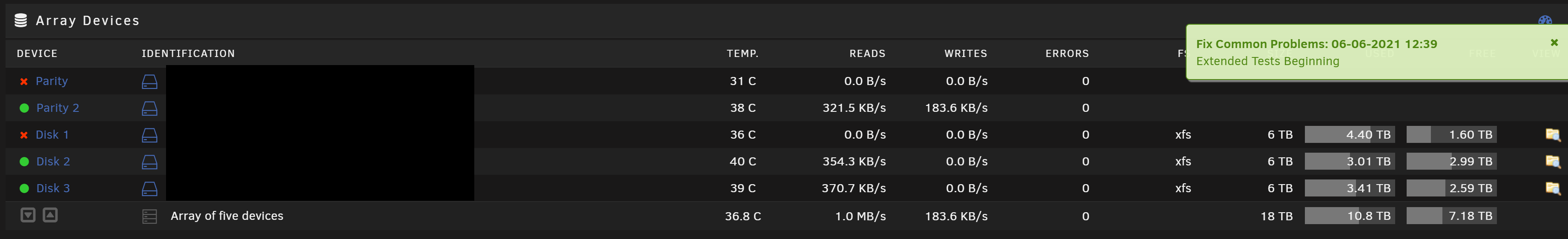

Hi All,
My parity and disk 1 are disabled for some reason.  Parity check ran on 6/1 with zero errors.  Fix common problems says check the main tab.  The SMART shows no errors.  The unraid log shows no errors.  I've tried rebooting it, and it temporarily fixed the issue before going back to being disabled.  I'd love some help on what I should do to test it.  I'm running a Ryzen 2700 with ECC memory.  I know Ryzens can have some issues as I have every once in a while where all disks report errors.  But a reboot solves that.  I'm running a fix common problems extended test.  What else should I do?2021-06-06_12-39-54.thumb.png.b5d21cbbe7391be4ec80c75a87ef07a5.png
If you didn't reboot, your diagnostics could provide information about what happened and help to give you a course of action.
Not clear what you mean here. Reboot can't possibly fix disabled disks, even temporarily.
Since you did reboot after the disks became disabled, we can't see what happened to disable the disks. SMART for both disks looks OK, and emulated disk1 is mounted, so you can rebuild to the same disks if you want. You should at least check connections before attempting rebuild.
https://wiki.unraid.net/Manual/Storage_Management#Rebuilding_a_drive_onto_itself
Do you have backups of everything important and irreplaceable?
