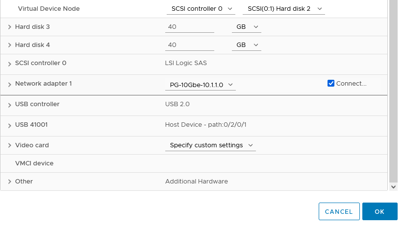

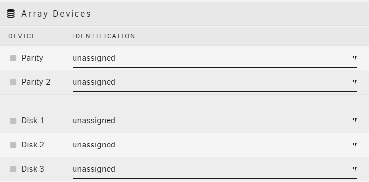

I set up a vm with a few virtual disks based on Ubuntu32 and used PlopKexec to boot off the USB stick I had passed through in vmware. Everything boots up fine, but when I login into the Unraid UI and look at the MAIN page none of the virtual disks I provisioned in Esxi appear as devices to Unraid..

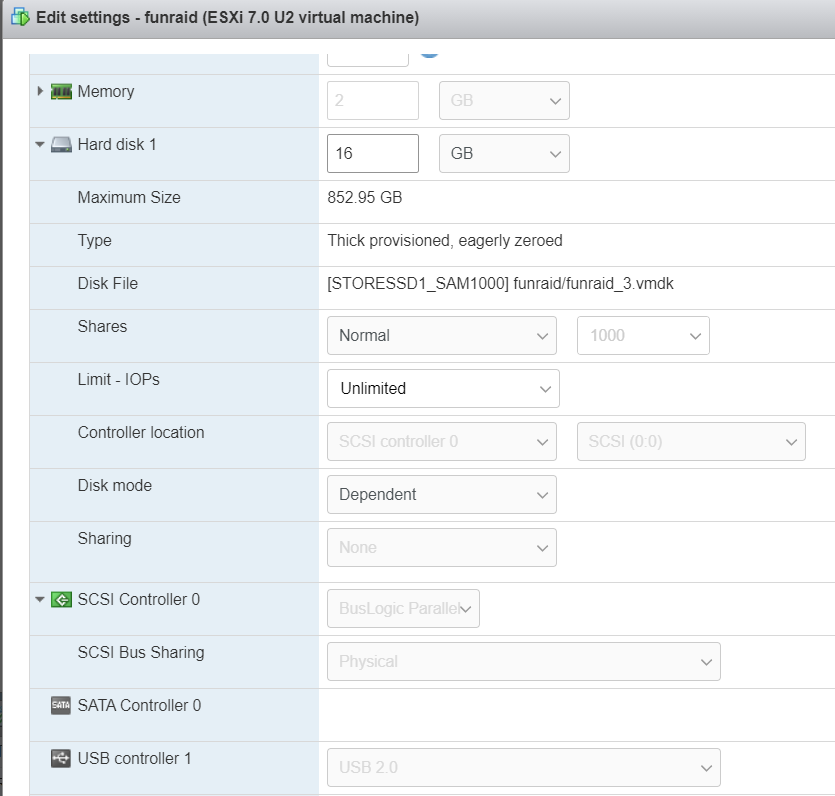

I've tried using different SCSI controllers like LSI SAS, Vmware Paravirtual, Buslogic etc as the emulation in ESXi but no joy. Also tried adding disks as SCSI thick provisioned as well as IDE but same result. Also tried changing the disk type from 'dependent' to 'indepedent' but that didnt have any effect or the VM didnt boot.  I reduced the disks down to just 1 disk just to see if that made any difference as well.. it didn't.. And just for good measure, tried also to play about with the SCSI bus sharing options between physical, virtual and none.. but no joy there either..

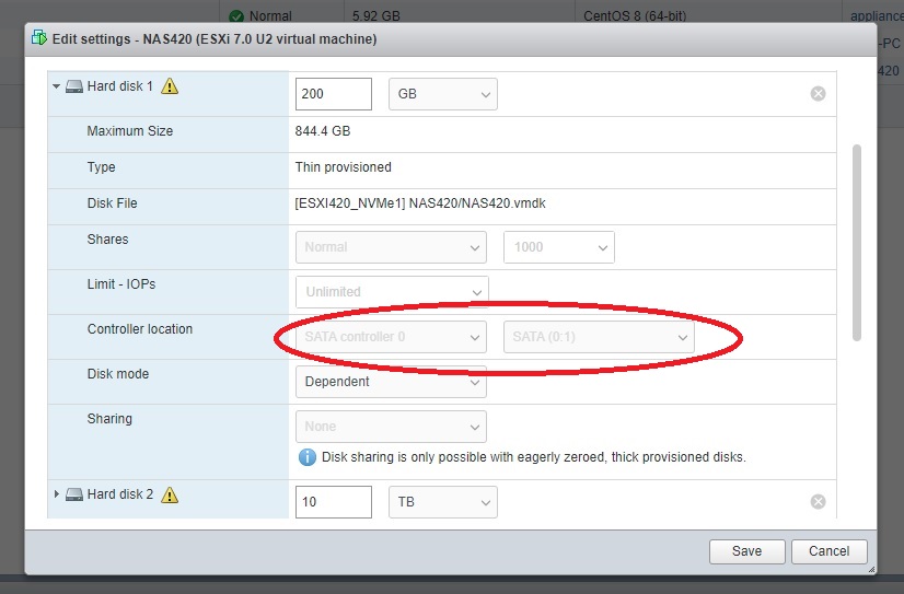

Sure, it works just fine.  Also, on ESXi 7, you dont need PLOP.  You can pass through a single USB device.
Edited by StevenD
Thanks very much for this - not sure why I didn't try SATA! The info about not needing plopKexec was useful to - followed the HowTo and it worked fine!
