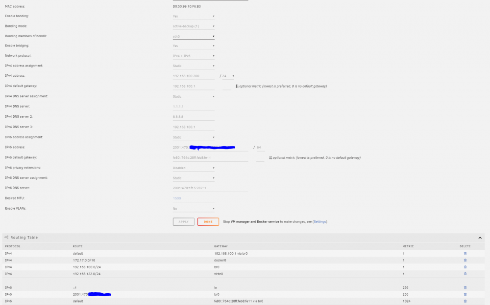

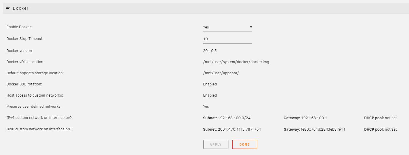

June 21, 20215 yr Due to a power outage my server did a hard reboot and now I have issues with my reverse proxy. It seems it cannot access any containers listening on the IP of the host. Host network access is enabled. Any ideas? 192.168.100.200 is my Unraid IP root@Tower:~# docker exec -it NginxProxyManager bash bash-5.0# ping 192.168.100.200 PING 192.168.100.200 (192.168.100.200): 56 data bytes ^C --- 192.168.100.200 ping statistics --- 3 packets transmitted, 0 packets received, 100% packet loss bash-5.0# ping 192.168.100.220 PING 192.168.100.220 (192.168.100.220): 56 data bytes 64 bytes from 192.168.100.220: seq=0 ttl=128 time=0.412 ms ^C --- 192.168.100.220 ping statistics --- 1 packets transmitted, 1 packets received, 0% packet loss round-trip min/avg/max = 0.412/0.412/0.412 ms bash-5.0# Any the reverse-proxy container has this configured: edit: for completeness the network settings: Edited June 21, 20215 yr by mattie112
June 21, 20215 yr I just experienced this earlier today on 6.9.2; had to reboot and a previously working container with a fixed IP on br0 wasn’t loading via reverse proxy. Disabling and re-enabling docker made the already enabled “host access to custom network” setting actually come into effect. Been meaning to test more and look into existing bug reports. Hope that helps. Sent from my iPhone using Tapatalk

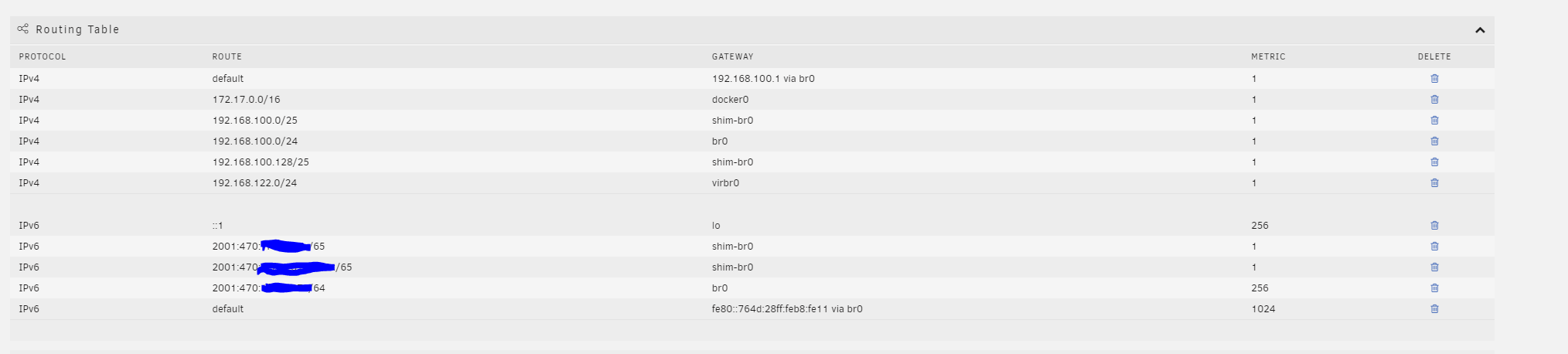

June 21, 20215 yr Author Yeah that seems to fix it! I've noticed some routes where added: The 'shim-br0' ones didn't exist earlier

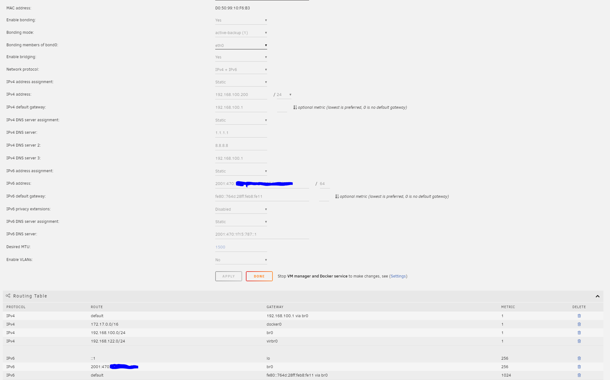

September 4, 20233 yr Author So: This is still an issue for me. Had a very long uptime, recently restarted due to an upgrade -> no problem. Now I had a "crash" (again due to filling-up the cache dir). Could not recover, removed the docker image and had it recreate. Then re-added all my containers and behold the same problem again It is exactly the same as in the first screenshot, however disabeling and then re-enableing docker does not fix the issue right now. docker run -d --name='NginxProxyManager' --net='br0' --ip='192.168.100.201' --ip6='xx:xx:xx:xx::xx' --privileged=true -e TZ="Europe/Berlin" -e HOST_OS="Unraid" -e HOST_HOSTNAME="Tower" -e HOST_CONTAINERNAME="NginxProxyManager" -e 'TCP_PORT_8181'='8181' -e 'TCP_PORT_8080'='80' -e 'TCP_PORT_4443'='443' -e 'USER_ID'='99' -e 'GROUP_ID'='100' -e 'UMASK'='000' -e 'APP_NICENESS'='' -e 'DISABLE_IPV6'='0' -l net.unraid.docker.managed=dockerman -l net.unraid.docker.webui='http://192.168.100.201:8181' -l net.unraid.docker.icon='https://raw.githubusercontent.com/jlesage/docker-templates/master/jlesage/images/nginx-proxy-manager-icon.png' -v '/mnt/user/appdata/NginxProxyManager/matthijs-custom-ssl-ciphers.conf':'/etc/nginx/conf.d/include/ssl-ciphers.conf':'rw' -v '/mnt/user/appdata/NginxProxyManager':'/config':'rw' 'mattie112/docker-nginx-proxy-manager' And then the reply is: ``` Error response from daemon: user specified IP address is supported only when connecting to networks with user configured subnets Error: failed to start containers: NginxProxyManager ``` I tried removing br0 and manually creating it: `docker network create --driver=macvlan --subnet=192.168.100.0/24 --subnet=xx:xx:xx:xx::0/64 br0` That allows me to start the container but no network traffic possible. So yes: any help is appreciated again I could also open a new topic but this is exactly the same problem so yeah.... (or at least to me it looks like the same problem) edit: Tried changing to eth0 as listed in changelog (https://docs.unraid.net/unraid-os/release-notes/6.12.4/) no luck! Edited September 4, 20233 yr by mattie112
